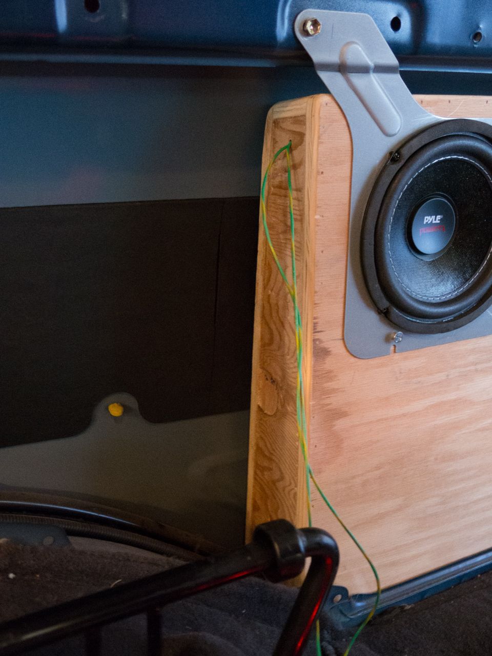

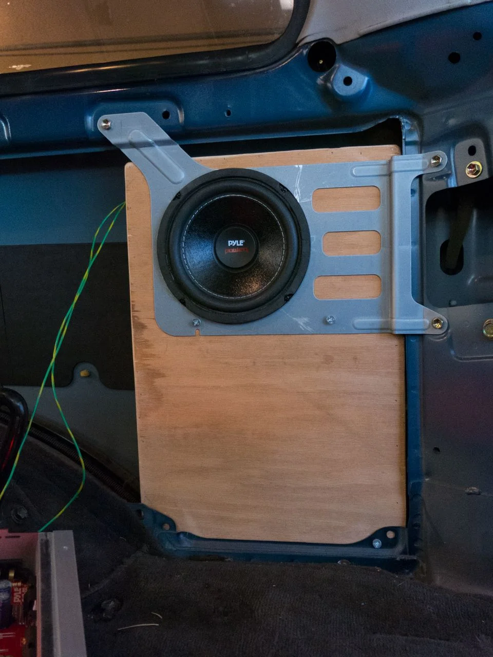

My 6" factory sub replacement.
full
full

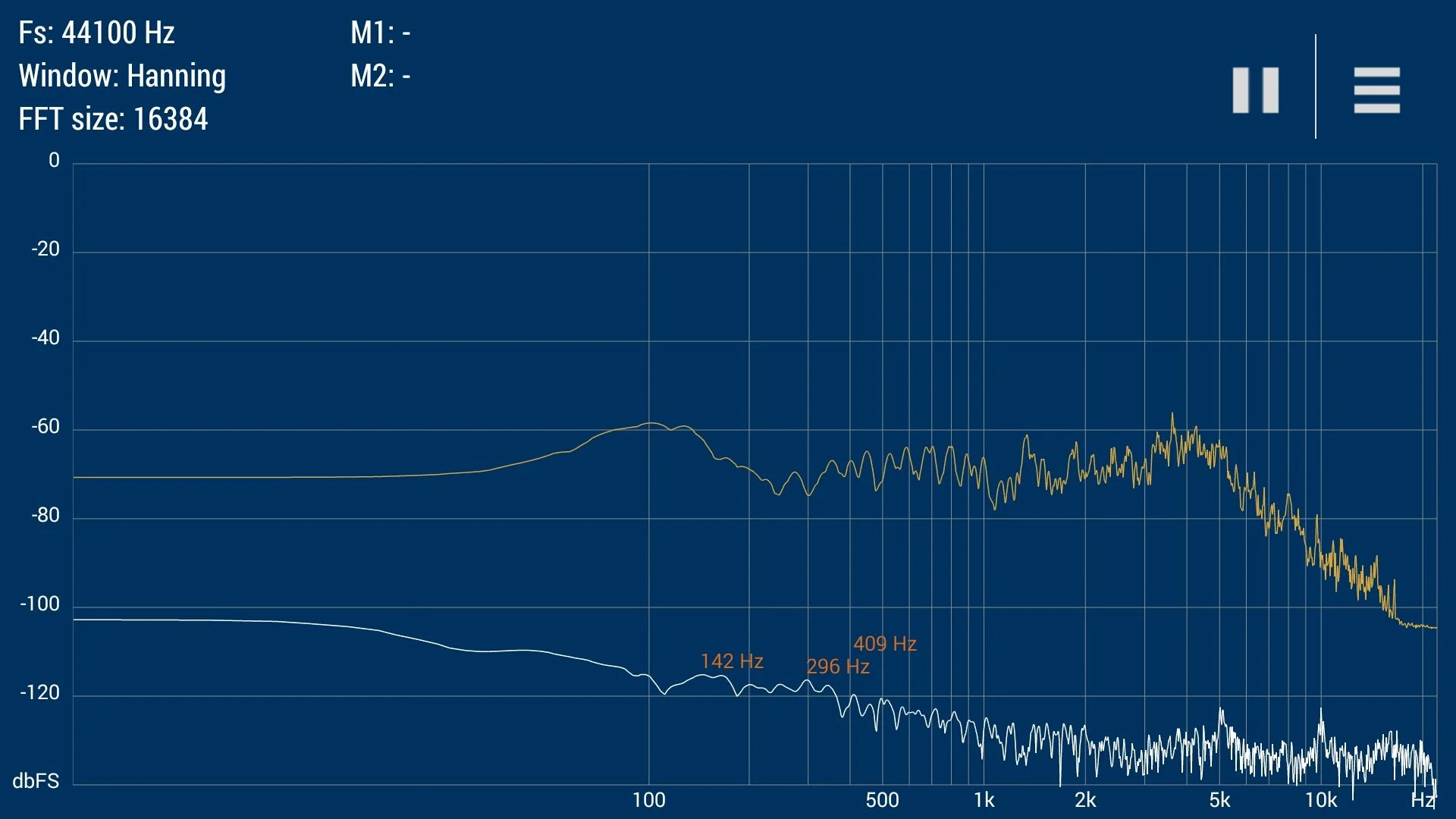

Here is a spectrum recording I made of my setup from the front seats. Very clean and plenty of lows but I have a feeling you are wanting the base to slap you in the back of the head. You are more than welcome to drive up and check out my setup.
full
Any way I could get dimensions from you on the little 6" box and any other holes you put in it??? Thanks!!! :beer:

I had to use a little more padding because at higher volume the speaker membrane would travel a little to much and touch the plastic panel cover which would cause vibration. The padding ended up increasing the distance from the speaker and the cover. No more touching, pure sound, distortion free (according to my ears).

Is the box wedged in or attached in some way and what exactly do you mean when yuou say you added more padding to prevent rubbing? Trying to wrap my head arouhnd this.
The box is not attached to anything. It sits on a small piece of 2x4.
Padding... a sponge actually which increases the distance between the plastic quarter panel panel and the box, therefore creating more room for the sub speaker to travel without touching anything.
Above 50% volume on low bass note, it would touch the cover and create some vibration. I guess it has some long travel built in.
Now with more spacing I can crank it up without creating any vibration due to touching anything in its way.
This method creating a little more spacing between the cover and the car's body, maybe 1/4 - 1/2" gap. Maybe.
I did trim some plastic off the back side of the cover too.
The visual aspect is totally negligible and in no way reduces the trunk volume and capacity.
I simply did not want to have it inside the trunk, visible to anyone, bouncing around all the time (if not properly attached), or take away precious cargo room.
Maybe I lied a little. There is a little bulge on the bottom. A lot more apparent with the liner angled up.
