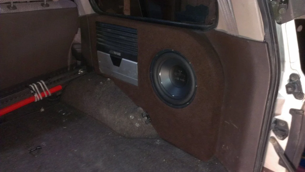

Your options are pretty much endless. I decided against going with a sub in the stock location. They sell some fit kits but IMHO a open air sub will never sound as good as good as a sealed or bandpass box. I went with a Kicker CompD in a small sealed 10" in the cargo area. I have it paired with a cxa300.1. It bumps enough for me at this point in my life. Get a good amp, a lot of amp powe ratings are no where near what they claim. I've always had good luck with kicker, jl, alpine.
From my 91...some cutting required :)
Thanks. It's about 1cf...it's been a while and I can't remember exactly. The box uses the space behind the amp, as well.
Nice, been thinking about doing something very similar and glassing the back of the box, contouring the body...
It's too tall for the space under the seat.
