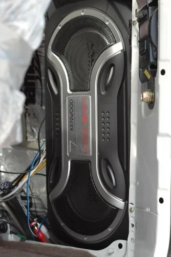

I chose the Kenwood KSC-SWI, which has a 6.5" powered speaker and a second 6.5" reflective (non-powered) speaker that is driven by the powered speaker for $250 from Crutchfield. The idea was that at about 3.5" high, you typically mount these under the driver's seat. I figured it would be close, but maybe I could also mount it in the stock location somehow. It really doesn't fit under the driver's seat if you are going to mount it to a piece of plywood as suggested, so I set out to figure out the stock location.

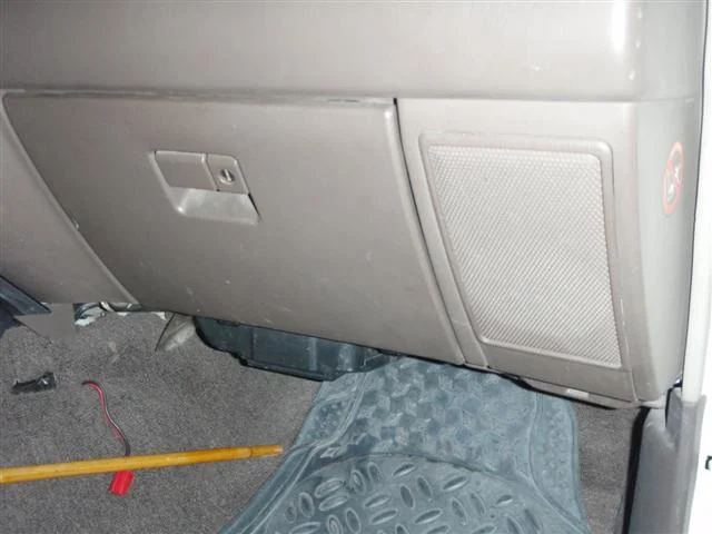

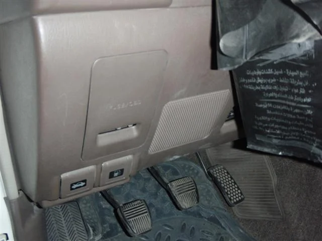

First order of business was to remove the stock junk, which had ceased working all together. Then I looked at the various mount brackets that came with the sub as well as the idea of using the stock mount bracket if possible. After messing around with it, I realized the sub would fit perfectly mounted vertically near the stock location, but how to mount it? After a few different ideas, I suddenly realized that if I bent the brackets that came with the sub it would mount perfectly into the pinch seam near the seat belt.

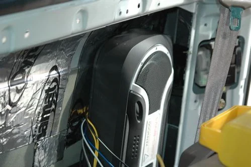

Now I had a goal - fit a powered sub into the stock location. I first used dynamat on most of the sheetmetal and then bent the brackets, marked the required bolt holes, and drilled. That pinch seam is surprisingly thick and makes an excellent mount. The sub fits in so tight and so perfectly it practically seems made for this space. Even without the mount bolts tightened, the entire unit simply could not move at all, and with bolts tightened it is rock solid. You can't move it a millimeter, and the two drums line up pretty well with the stock cover and vent.

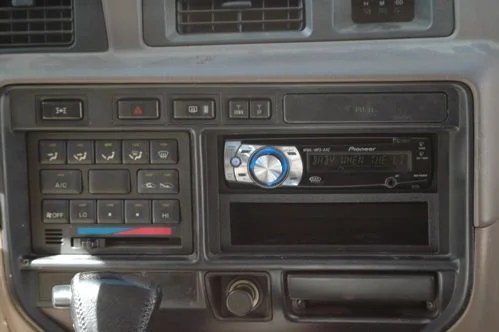

So it was time to test...and...nothing. I had wired it up to the 12v power for the original amp. This was enough to show power to the remote control (you can adjust output levels with a wired remote), but ultimately not enough to power the system. I finally figured that this might be the problem as I had verified my ground and ran the power straight to the positive battery terminal, and boom, I had bass.
So now I have satellite radio, which is too cool as I was out crawling last weekend with sat radio the entire time out in the High Country way beyond cell phone coverage, and the system flat out shines. The addition of the sub opens up the entire range and this relatively small powered sub is a perfect complement to the capabilities of the relatively small door mounted speakers. It is an entire level above the premium 240W Bose system in my minivan in terms of sound clarity (not volume), and that's a very nice system. I went from absolute ear-pain crap to a near audiophile system with a simple $130 receiver, satellite radio adapter, and subwoofer (very nice door speakers already installed). Hopefully that will help those looking for real bass in their systems know that this Kenwood unit will mount up perfectly in the stock location. Just make sure you use Dynamat or an equivalent so your newfound bass is not accompanied by any newfound buzzes or rattles.
One other thing - Crutchfield sends you a "pocket" that mounts up to the factory brackets to fill in the space below the receiver for free, so now I have a little bit of extra storage in the dash. See the third pic.

They were the same price when I was shopping Crutchfield - Google shows I paid too much :D, but I really did need the tech support late Friday night and Saturday to deal with the wiring issues (power) I was having, so it was worth it. The SW10 may be as good or a better option.
As for wiring, yes, this bypasses the entire stock wiring system. What is interesting is that there are 3 harnesses for the audio system in the factory audio wiring pack. The biggest "main" harness plugs into the stock unit and presumably runs to all of the speakers. The two smaller harnesses separate front and rear wiring with nothing for the sub - you'd have to tap into the rear lines to wire a sub directly, or presumably figure out which wires in the main harness go to the sub and tap into those. Straight RCA wiring is much easier and probably provides a better signal.
Crutchfield sent their harness adapters for the smaller harnesses for the Pioneer receiver - they were colored coded identically to the Pioneer deck so I simply had to solder up the like colored wires and plug 'em in (one has front door speakers and power/ACC/ground, the other just rear door speakers). I am getting great depth of sound from the rear door speakers now. Songs like Radiohead's Reckoner have more depth than anything I have ever heard on a car audio system (of course, I've never put in my own full system before, so now I know what I've been missing even compared to the so called "premium" brand name factory setups).
The sub is wired via the RCA inputs/outputs so it is on its own line entirely, and the power is straight from the battery (the stock amp is removed as you mount this unit in that space and this is a powered sub with a built in amp). They clearly pull a lot of power as a powered sub (it stopped working as my battery drained from my high volume testing, but I could still turn it over and start the rig), and I think you have to run it this way vs. trying to tap into any other power source. I really should have known trying to tied a 14 gauge power source wire into the stock amp power line.
The coolest thing besides the audio result is the mount fit. There are some smaller units out there I might have gone with that would have fit under the seat, but they were out of stock and I figured I wanted a bit more thump. That it fits this tightly and securely in the stock position is just pure luck :D

I notice you have two types of Dynamat in the pics--is one the Original? What is the silver one? And does it matter? Did you just use what you had on hand?
I'm looking to order the Dynamat, too, and want to get the right stuff.
