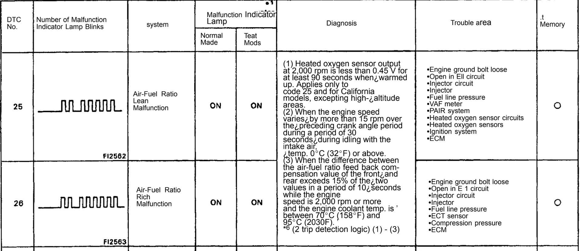

Would this chart mean that if you are getting both the 25 and 26 codes then it wouldn't likely be VAF, PAIR, O2, Ignition System, ECT or Compression pressure, because those trouble areas aren't listed for both codes? Unless you have two separate issues?
I only have 25 and 26. Was having rough idling and replaced VAF yesterday and idling is very much improved, but didn't have a code for that anyway. Still have 25/26 and the truck runs great. Fuel pump, igniter, coil are all new as well. No other symptoms that would indicate engine ground bolt is loose.
