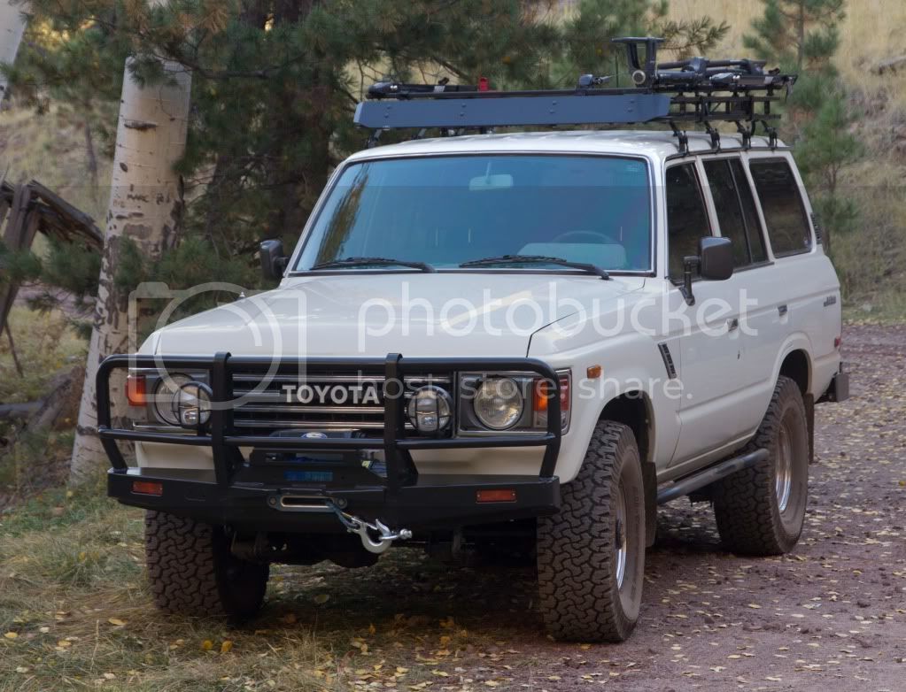

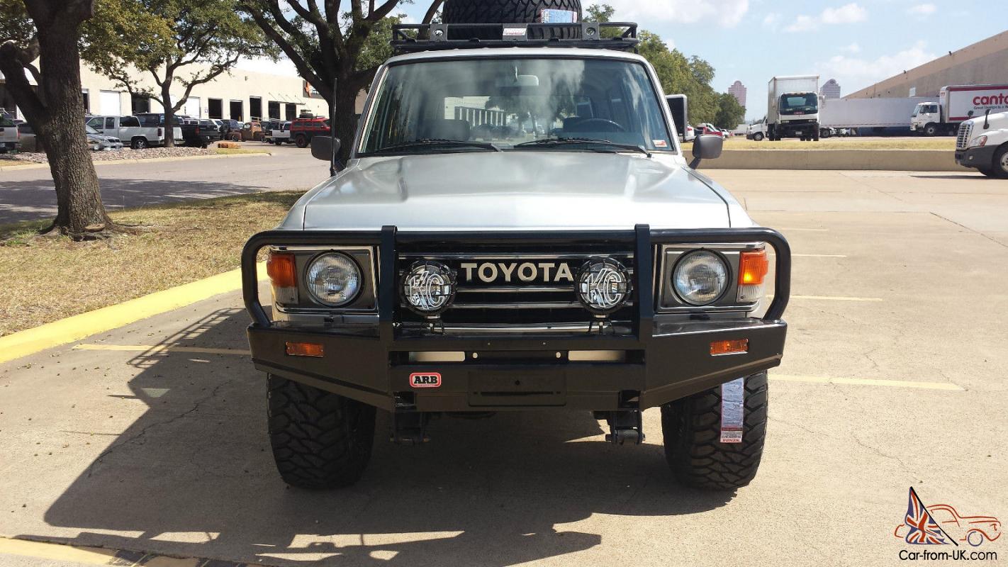

Let me pose another question pertaining to the ARB. I've noticed a couple different styles of the ARB on 60s.
Example 1:
Example 2:
Is the top the new and the bottom one the old? Or are they both still available today? Advantages and disadvantages of both?
I like the new one. I think the approach angle may be slightly improved over the old version as well. Less cluttered too. The new version is a tight fit up against the headlight sprayers though. Mine actually make constant contact.
