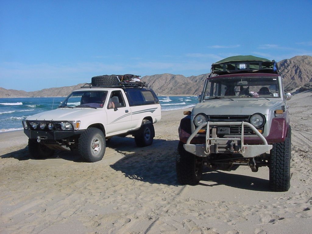

What's funny is that was the first style I'd ever built for a 60 in 1994. Apparently we were the only company that could supply six fronts and rears in the time frame they needed...eleven days to the shoot. Kaymar had a couple rears in the US and ARB only had one front at the time stateside.
It bears a strong resemblance to ARB but in 1994 I'd not seen an ARB for a 60. Instead I patterned in after a bumper I'd built for a GMC Jimmy two years earlier. We loosely referred to it as our football helmet design....I guess catcher's mask would have rolled off the tongue better. I haven't pushed it because the ARB is already out there and focusing on other options seemed better from a customer need standpoint. I didn't start driving a 60 until 1990 so the current style we market didn't appear until 91. I drove a 55 before that so I had 55 bumpers before the 60 offerings. 90% of what I build was first tested on something I drove daily. I like like working out the bugs at my expense. This is why we're slow coming out with 80 stuff. I have designs I'm happy with but I still worry when a customer drives away with something I haven't personally spent time with. Shackle reversals and U-bolt flipkits were on both 40's in ARCA. Tracy Jordan's 40 ran a shortened version of the 40 bullbar. He found it handy when he broke birfields. The "v" notch in the 1/2" upright worked like a slide hammer so he could quickly separate them from the axle shaft. We offered the same roll cage options through Man-a-Fre. The designs were heavily field tested tested. They never failed or even gave way significantly although Tracy was sent to the hospital for observation after his truck launched off a drop and fell about ten to fifteen feet

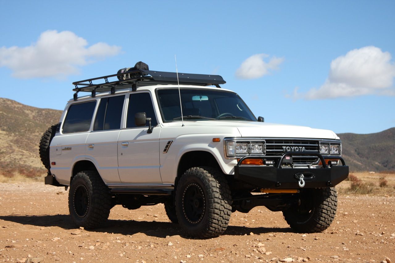

The more I look at the standard front bumper, the more I love it. I think that's all I need. It now just seems less cluttered than the ARB and "Kingdom", which I think is overkill for me. Plus it doesn't take away from the aesthetics of the 60 series front end. What lights do you usually have customers add to the standard? I definitely want tabs for two round LED lights somewhere. Can custom tabs be added for lighting?
I mounted two 9" Hella Rallye 4000s up top and I found a 17" low profile light bar that isn't too gaudy below the hoop. Generally I like old school looks on an old school truck so most of the light bars look out of place except maybe on the roof rack. This one is two row but uses reflectors so it's as low profile as a single row and shallower. It's more inconspicuous than the others and doesn't interfere with the winch down low

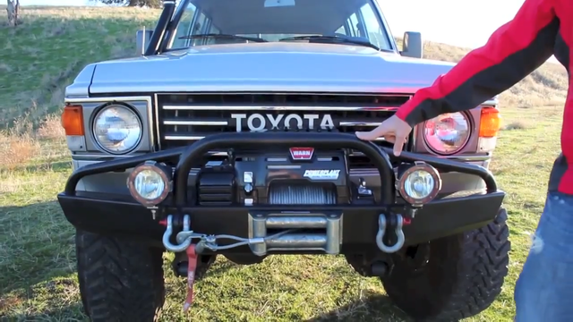

I believe this is one of your bumpers, correct? I'm really liking the placement of the round lights here as opposed to on top. They just look out of the way in this position. Of course I'd like to find a more modern light that fits here than these HIDs. Looking at Baja Designs lights. I also don't think a LED bar has any business on a classic truck like this.
If it's not mine then they did a really good job matching it.
Man-a-Fre used to mount Hella 4000 compacts inside the hoop on a regular basis. The one above has the Powerplant Winch.
It's much bulkier than the normal winch. There's probably no room for lights in the middle with that winch. Some of the new winches
with the Darth Vader, swoopy aluminum bodies like the Come Up , Warn Zeon , and that Powerplant encroach on potential light positions.
We had to redesign our winche bumpers, both 40 and 60 for more clearance for the Zeon and Comeup
