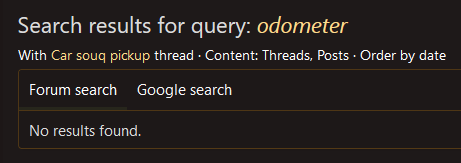

really? got a link to the post(s)? i searched multiple terms with no success
Sincere apologies. The FJ45 Troopy thread:
Starting at post #86
