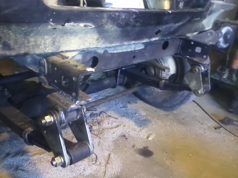

Today I installed the leaf packs on the Dana 60 and cut off all of the existing bracketry on the frame.
I welded up the new front shackle hangers as well. Unfortunately because I was exhausted and unable to simple math I installed the first rear hanger in the wrong place.
I only tacked it in so its just a matter of 10 minutes of grinding out the weld and putting it in the right spot.
I wanted to attach a pic of the current wheelbase of the truck, as it sits in the picture below it is set at 115".
I need to move the rear spring hanger back an inch or so due to the fact that I am running out of frame to attach the front shackle hangers to. I could run longer shackles but am not sure at what point they start to get excessive.
So two questions I have are whats the maximum when it comes to front shackles? What is the most angle you can you have in your drag link front to back? I know parallel to the axle would be best but what would be an acceptable limit.
I ran into a few issues with the welder but I after getting that worked out I burned in the front hangers and got the passenger side spring hanger tacked in place.
Right now I am running a lot of angle on the front shackles but that should come down with the motor, trans, and front bumper reinstalled. Plus it should settle a bit as the packs cycle a bit.

I'm actually going to tie the shackle hangers into my front bumper by welding plates with 4 holes in it that line up with the bumper mounting bolts on the frame. That should be pretty strong. If I notice any flex in the front frame I will box it in.

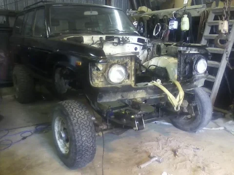

Front suspension is finished for the time being and the truck is standing on its own legs again.
A quick check of caster showed it to be +2 I am going to throw on the 5 degree shims I had on the cruiser axle. Hopefully 3 degrees will be enough. If it's not I guess I'll cut and turn the knuckles.

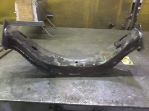

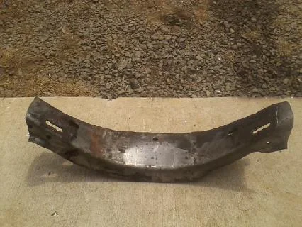

At work I cut down the old motor crossmember from the dodge and made some scab plates for welding to my cruiser frame.
Cut down crossmember:
Finished crossmember:

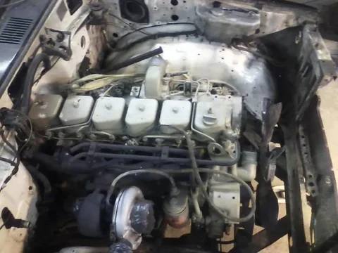

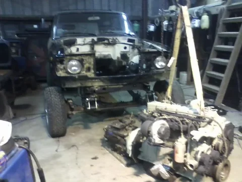

Some progress from today:
I tried fitting the motor into the truck but unfortunately it would not clear the steering box so tomorrow I will pull that and clean up the inner frame rails a bit, there are some remnants of the old motor mounts in there.

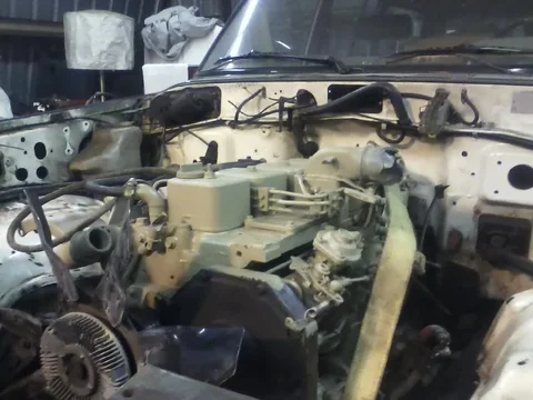

They fall into place rather nicely if I must say so. Thanks for the support, stay tuned for more its gonna get good soon...
Even the stock shifter for the transmission lines up in the right spot.
Plenty of clearance for the radiator too.

Forgive my ignorance, but what is the 3rd smaller hole in the shackles for?
Yeah the shifter is getting cut down a bit but it comes right in the stock shifter location so the stock boot will be reused. I was pretty happy with the way things line up overall. Some things will need to be addressed, like the lower radiator hose, but for the most part things fit really well.
The third hole on the shackles is for an anti-inversion bolt. I was dumb and spent a bunch of money on them from man-aint-fre so I figure I might as well use them since I had them laying around. Otherwise I would have made them from some 3/8ths plate.
