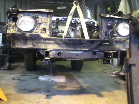

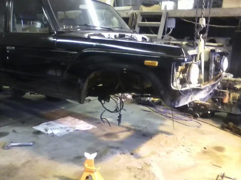

There was some more progress today. The first thing I did was pull the old axle out from under the Cruiser. A note to everyone is be sure to put some antiseize on anything you bolt together. It makes removing them a whole lot easier. But after some heavy hammering with the aluminum hammer I made everything worked out well.
I also realized once the cruiser axle was out that the leaf springs in the front will need to be outboarded to run the Dana 60. The center section on the D60 prevents the spring perches from being shifted towards the center of the axle.

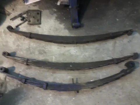

So I was thinking about possibly swapping the springs I will run up front. I liked the flex I got out of the stock cruiser springs, but I would like to have something with a thicker main just as a precaution with running the 6BT up front. I don't intend to take it easy on this truck and would not want to be replacing mains on the trail.
I have these springs out of the front of the dodge but compared to the cruiser springs they don't seem to have a lot of arch. The cruiser spring is on the bottom.
The other options I was thinking of were some sort of hybrid pack using the springs I have already or go to a junkyard and pick up a set of 52" chevy springs.

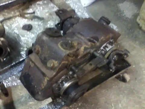

While I was powerwashing the Dana 60, I figured I would clean up the NP205. I also swapped around the yokes so I can reuse the front driveshaft I already have or modify it to make it work. And I changed the input so I can use the current rear driveshaft to make an intermediate shaft.
It was pretty filthy and even powerwashing didn't get everything off.

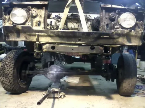

I slid the Dana 60 under just to get an idea of what it is going to look like. I think I like it. :D

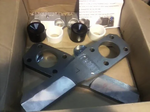

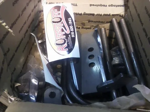

Some front axle goodies showed up today. :D
Crane Hi Clearance Arms:
Diff cover and D60 swap kit from ruffstuff:
These will hopefully be installed this weekend.
