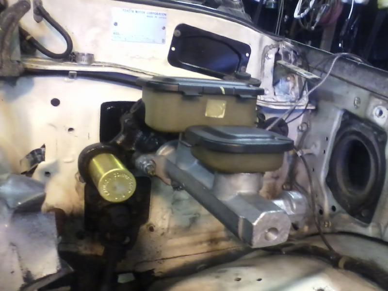

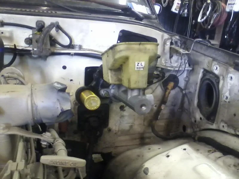

Hydroboost got installed today as well. There was a slight issue with the MC from the Astro.
So I took a quick trip to advanced auto and ended up with this.

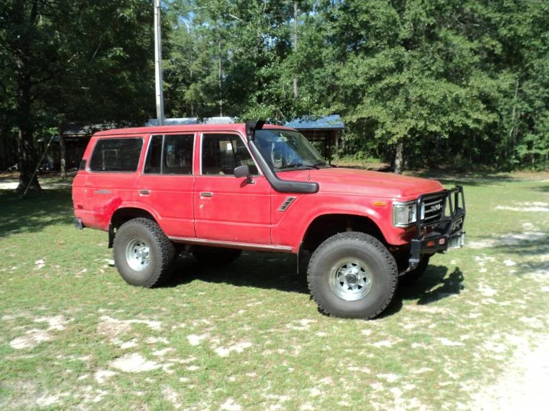

Here is where I was I before deciding on doing a cummins.

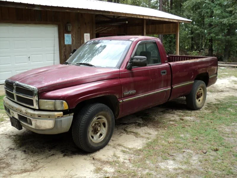

Here is my donor truck. Notice it is 2 wheel drive so when I rebuilt the nv4500 I had to change the rear of the housing and the output shaft.

What is the application or part number for that brake master?
that MC looks huge .. if you wanna go with stock calipers .. it might be an issue ..
The application for the MC is a 1990-1995 Chevy Astro or GMC Safari. It has a 1 1/4" bore. It's advanced autoparts number was 102534.
I will be running large single piston brakes up front and am planning on upgrading the 14 Bolt to disc brakes so it hopefully should work pretty well.
Don't want to be the negative guy here .. but 1 1/4" was way to much ( large MC ) for my application ( Tencha ) and my taste ..
Don't worry, you're not the negative guy. But just curious you still have toyota axles right? Disc front and rear?
He is running one ton axles, not Toyota axles. This master cylinder will think it's attached to a stock truck.
I'm running a 1 1/4 on 404 mog axles and it is barely enough. BIG truck brakes will probably be fine with that MC. What diameter are the pistons? 100mm?
damn hell yeah .. I forgot that part .. are 1 1/4" stock MC bore for 1Ton Trucks ?
The front pistons are around 3.37" so thats around 86mm, plus i'l be running rear disc brakes as well. I'll have to measure those tomorrow.
Yeah, most 1 ton trucks are running 1 1/4 or larger MCs.
That is what I am hoping.
Thanks for all of the input on the brakes and whatnot, I always appreciate the feedback.
I had the 1 1/4" bore on my setup for the first 8 months or so and it sucked! I do have stock axles though so I would see how it does with your setup.
All of the braking power was at the top of the pedal travel and I could easy push through the travel of the brake pedal and it would go to the floor. Down right scary in emergency situations. I switched to a 7/8" camaro or firebird MC and it is much better and stops 40's on a dime if you stomp on it.
