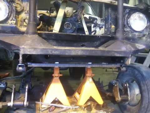

Another thing I spent some time on is the front framerails. I got some channel and 1/4" plate for helping a buddy install a new 4" exhaust on his truck so I used the channel to brace the bottom of the frame together and used the plate to make tie ins off of my shackle hangers to bolt them to the bumper. I think this should be plenty strong enough to prevent twisting.

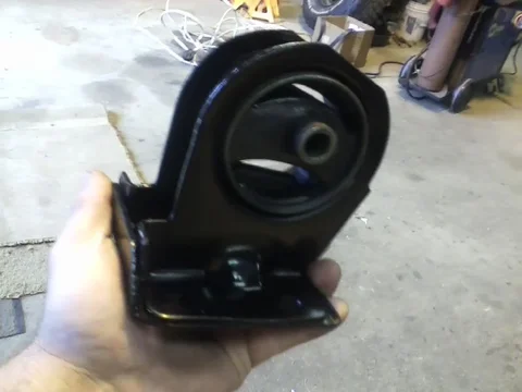

Also I wanted to post the mount I picked up for my transmission crossmember:

Finish welding in the engine crossmember and gusset it
Weld and gusset rear spring hangers
Add my 5* shims
Paint the axle
I finished all of those things and got the dana 60 back where it belongs.

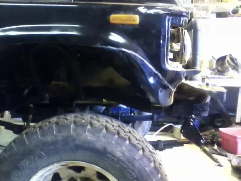

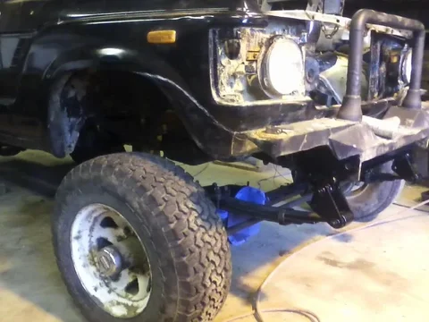

I will be moving the tie rod up to the high steer arms once I pick up some new TRE's and tube.
Also since I moved my front axle forward I will need to do a little trimming on my front fenders and valence. I was thinking of doing something like this:
Used this same kit. I had to do a little modification on it for my application but it worked great.
Looking good.
Thanks, I had noticed the kit on your build thread and it looked pretty nice. Plus the time it saves is worth is. Hopefully I will be able to get it installed this week sometime.

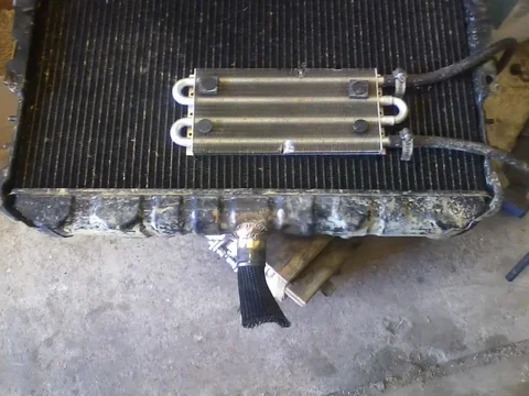

I got my radiator back from a welder I used to work with. I had him modify the location of the lower radiator hose.
I had him cut the old one off and plug it, then shift it to the bottom of the radiator to make sure it is out of the way. Here it is installed.

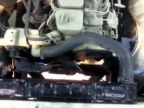

And here is a shot of the space between the radiator and the fan.
I am very happy with the way it turned out. I was also able to reuse the upper radiator hose from the dodge as well. I just need to hook up the lower hose and heater lines.
