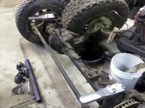

I installed the new high steer arms.
They look good, I just need to drill and ream the holes out for the steering system. Since my high steer tie rods and ends are new I plan on reusing them.

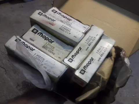

I also got a killer deal on a set of bearings for the D60. $70 for all these guys right here.
It would have cost me a lot more to get them from a store, fortunately there is guy selling off some inventory or something on craigslist by me.

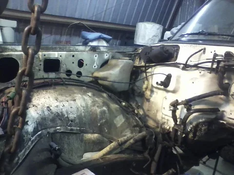

Clean enough........
It isn't as clean as it could be but I figure I am just going to get it filthy again anyway. At least I won't get super greasy putting the Cummins in.

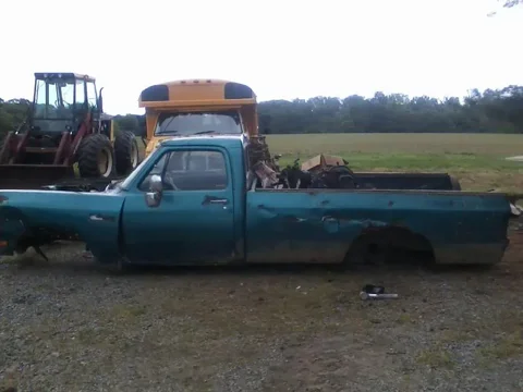

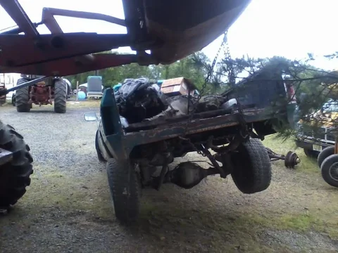

The last thing I needed to pull from the dodge was the rear leaf springs. I finally got around to them today and after a little bit of this.
And some of this....
I finally ended up with this.
Tomorrow I'll pull the packs apart and swap in the secondaries from the chevy pack. I'll also install some of those inserts at the ends of the leaf packs to reduce friction.
A front-end loader? Man, you have got a sweet setup!
The setup rocks. The family is super cool and my friend Keith is doing me a big favor by letting me work on the truck there.

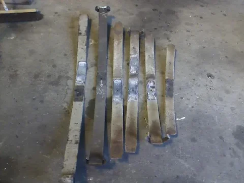

I also took apart the rear springs from the dodge, and I think this is going to be my final leaf pack.
I will obviously keep the other leaves in case I need to tune it a bit. As of right now it is the main from the dodge pack, the secondary from the chevy pack, the next three are the in order from the dodge pack, and the thick one at the end is the second to last spring from the original dodge pack. I need to cut the chevy spring a bit to get it to fit right and I need to drill holes for the leaf anti friction pads. I also want to make some spacers for the center of the packs to reduce friction.
I don't know how high your steering arms will place the tierod above the spring packs but there is the potential to run into clearance issues with really thick spring packs and your tierod. I'm at about the max thickness in my setup right now but your knuckles and arms should be taller than my stuff so this may end up being a moot point. Just giving you a heads up since you talked about spacers in between the leaves and that all adds up.
Hey thanks for the heads up. For spacers I was just thinking of making some about 1/8th inch thick HDPP spacers, but you are right that adds up to .625 if I use 5 of them.

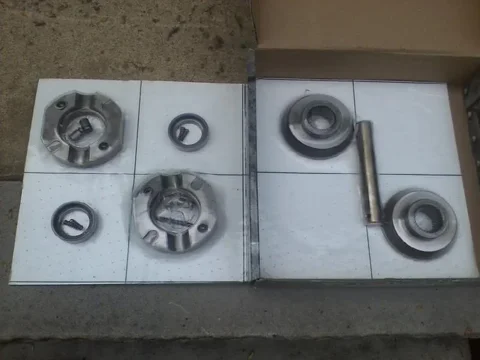

So yesterday I came home to find a package on my porch and inside it was this.
I found a guy selling this locker on pirate for $300 shipped so I jumped on it.
All I have to say is this thing is pretty beefy for a lunchbox locker. The crosspin is roughly an inch in diameter.
