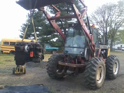

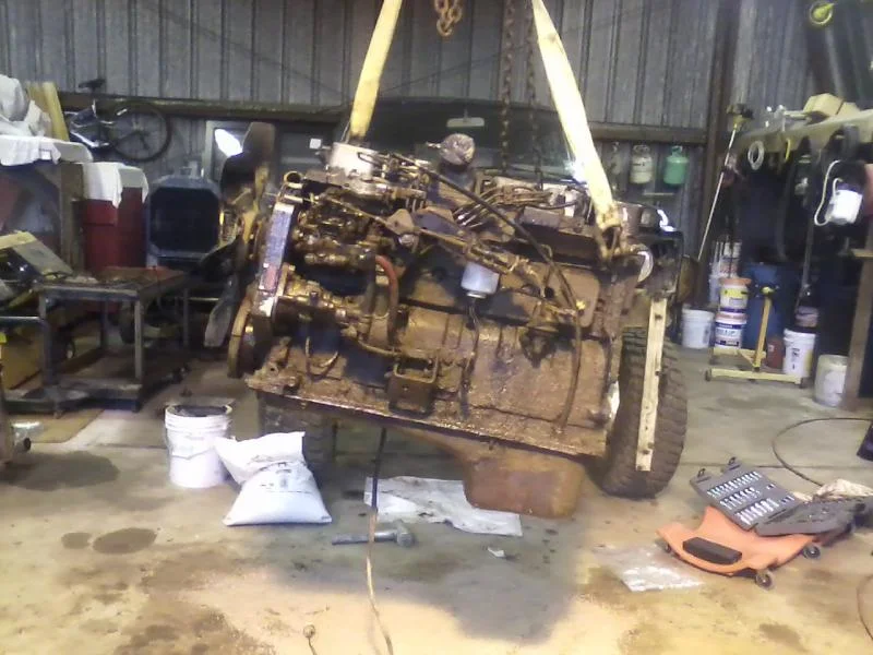

With regard to the motor, I pulled the transmission and transfercase off of the cummins. I managed to break a 5/8 slim wrench in the process. I started prepping the motor to be powerwashed to clean some of that grime off and get it ready for paint. I decided on going with cummins beige and will probably have some pieces painted black to tie in with the truck.
this thing is going to be a stump puller when you get done...

I always loved the torque the 2F had for wheeling. I figure this should be pretty awesome with the additional power. Plus it will make pulling other people out a lot easier, and considering the fact that when I go wheeling I usually spend a bunch of time doing that its definitely a good thing.
Yesterday I pulled the motor out of the shop and sprayed it down with the powerwasher, you gotta love farm equipment. And i thought it was also fitting to note that the Versatile has a 4BTA in it.

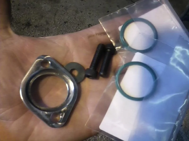

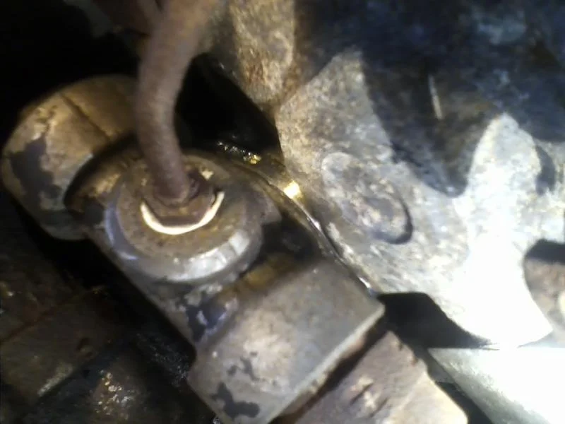

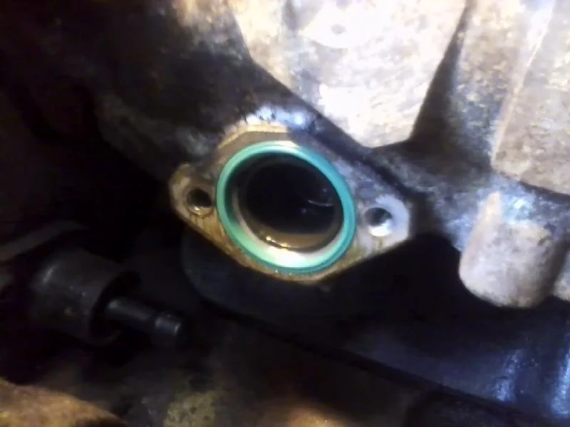

Also today I had a bit of time so I installed the dynamic timing spacer I picked up for the cummins.
The install went pretty well. I replaced the old O-ring on the pump.
And here it is installed.

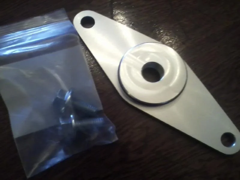

Tomorrow I will take a wire wheel to the block and try to get it cleaned up a bit more. Once that's finished I received this in the mail today. So I should be able to install it as well.

What's that second spacer pic you have?
i believe thats a new rear freeze plug...this one uses the remaining two bolts above the adapter plate,and can be tapped for hot coolant source.the originals sometimes like to pop under high boost.
Boots if you are talking about the second picture in the post about the timing spacer, it is just an o-ring installed on the pump.
If you are talking about the larger billet piece ambulancechser was right. Its an aftermarket freeze plug that utilizes existing bolt holes.

Yes the freeze plug piece. I haven't heard of that one so I was interested.
