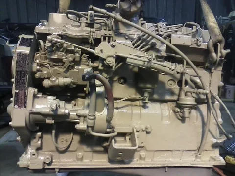

I did a little bit of painting today after I pulled my pump apart and installed some new gaskets.
Here is the motor with some primer on it.
It looks a lot nicer with some paint on it. :D
Two coats of Cummins beige.

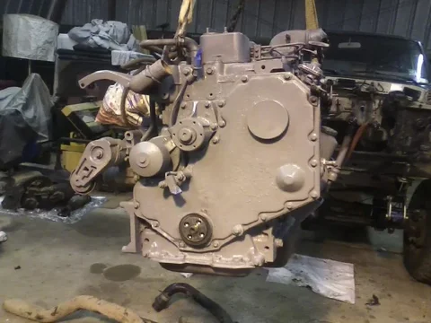

Tomorrow I will pull the timing cover and do the KDP fix, then hit the cover, the exhaust, the valve covers, and the oil pan with some black paint.
Motor work is all finished.

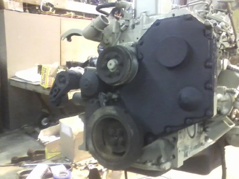

I pulled the front timing cover today to check on the Killer dowel pin issue that affects this motor and fortunately mine was still well recessed. Just to be on the safe side I made up a little tab and installed it. There really is no reason to buy one of the kits they sell for this because all it takes to fix this is a small piece of metal and some threadlocker.
I repainted the timing cover as well as exhaust today.
The valve covers will be painted black as soon as the new valve cover gaskets arrive.

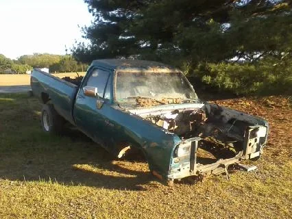

I also worked on pulling some more off of the dodge donor truck. The front axle was removed along with an engine crossmember.
The glow plug solinoids also got pulled and the front leaf packs.
Hopefully it won't be too much work to get axle mocked up under the cruiser so I can start test fitting the drivetrain.
