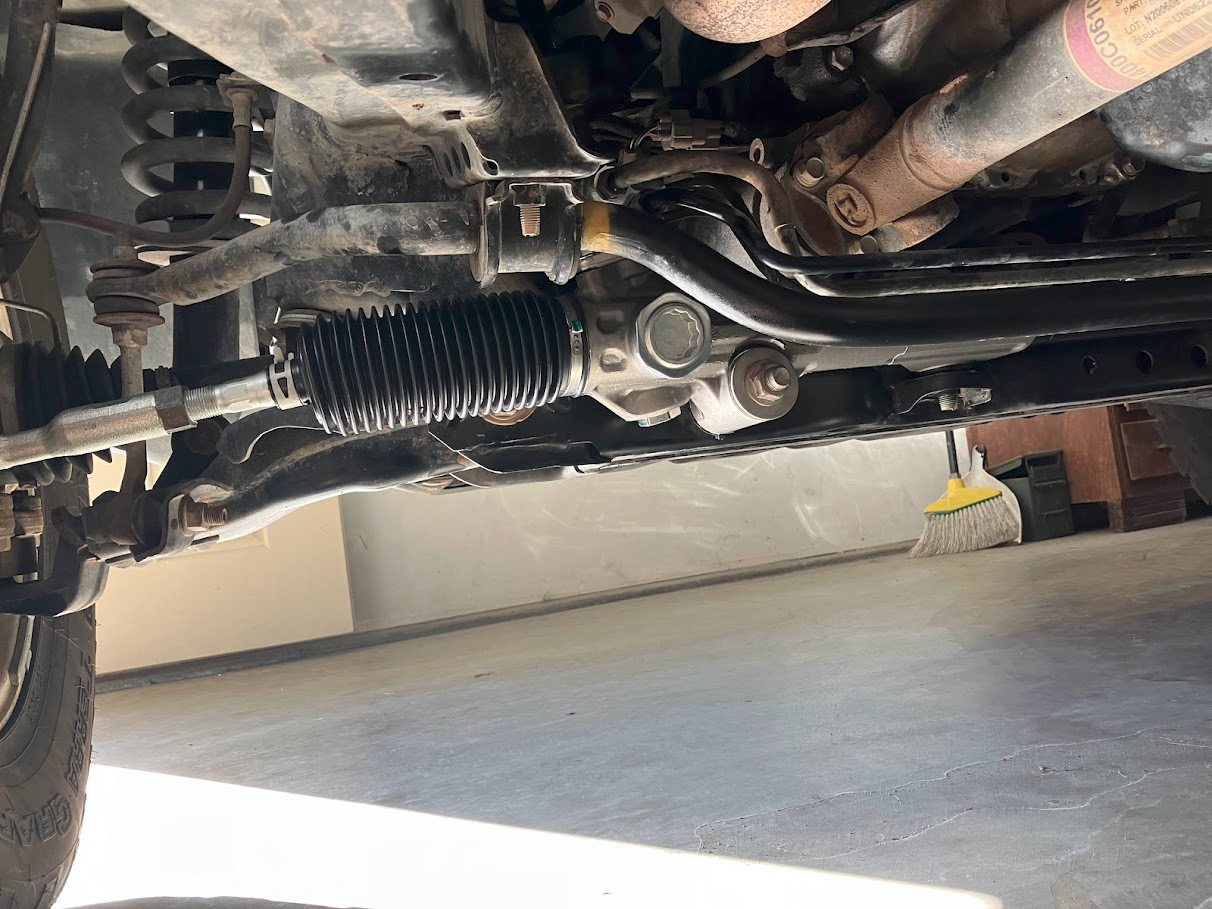

Hi Guys and gals
I don't post here much, spend most of My time in the 80 forum.
I do DD a 2006 Tundra access Cab, it's a great truck and I really like it. It's been virtually trouble free during my ownership.
It's a super clean low mile 125k truck.
But it has leaky steering rack. it started on the driver side but now it has small leak on both sides.
I like to do my own work, so I started looking up a replacement Rack. I would prefer OEM
But it looks like it just the rack if you go OEM, the aftermarket one look more complete with new boots, bushing, rod ends etcetera.
So whats the best way to go, can just the seals in the end of the rack be replaced ?
Is there a Quality after market replacement ?
or do I get OEM and all the extras to go with it ?
Thanks in advance
And because we all like pictures
Go with OEM rack, if you want to skimp to save, get some aftermarket boots and outer rod ends, the Napa or 555 seem to be the consensus like with the 80

The only thing that leaks is the rack 🤷‍♂️ and why I'm replacing it. the rest of the truck is incredibly clean.
Ordering the part was the easy part. Now it's time to tackle this bad boy ;)
You started yet?
Yep, gotter done Sunday. took about 5 hours. :beer:
Also put in new tie rod ends while I had it apart. New rack did not come with the new rubber O-rings, was able to reuse the old ones. One of the tie rod ends was stubborn and would not come off so I had to go by a puller.
No more leaks on the drive way :cool:
Got a alignment Monday, drives really nice !!

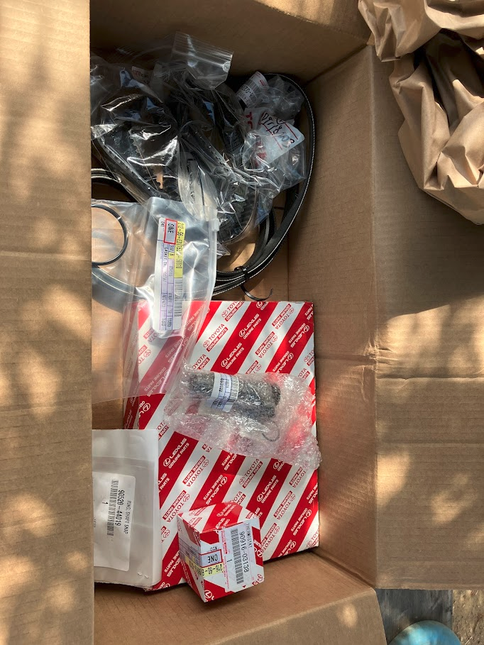

I will be doing the Timing belt next, parts came in today
Got them on a 20% off and free shipping :cool: all OEM
