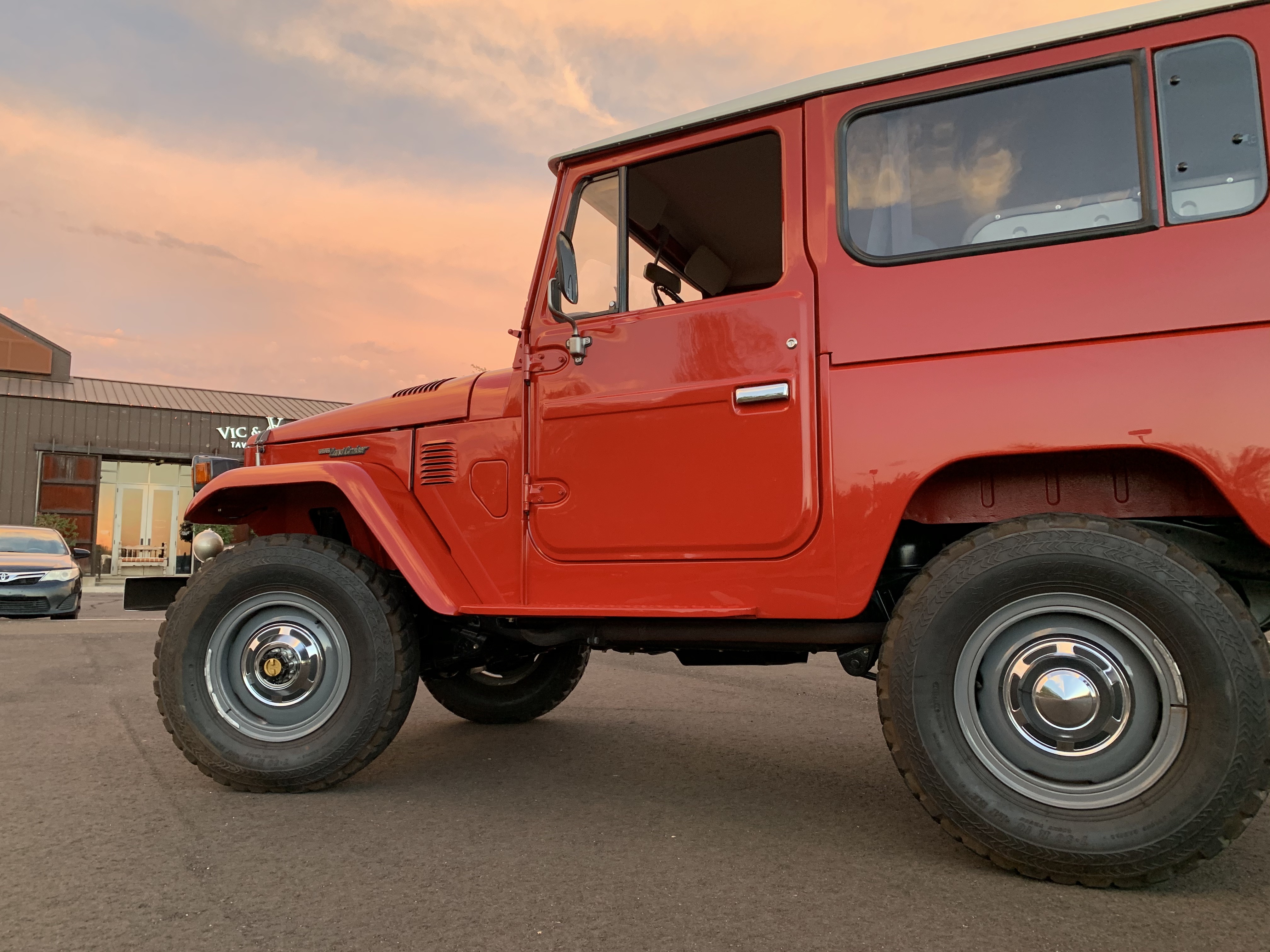

I picked up a set of takeoff 17x6.5 OEM steelies to test on my 40. This was while I was back in Abu Dhabi. I wanted to source Toyota steelies that I could eventually replace my splits with given how difficult it can be to get tire shops here to play with the splits.
Here is one tested out with a 245/75 R17 (roughly 31.5" x 9.6"). No spacers.
On the rear there's a very minor amount of protruding...
So I had a set of five painted up white to match my roof and bezel... saving them for new tires once I get a lift installed.
NOTE: While I appreciate the shops painted-to-match pewter hubcaps I'll be taking a pass on those.

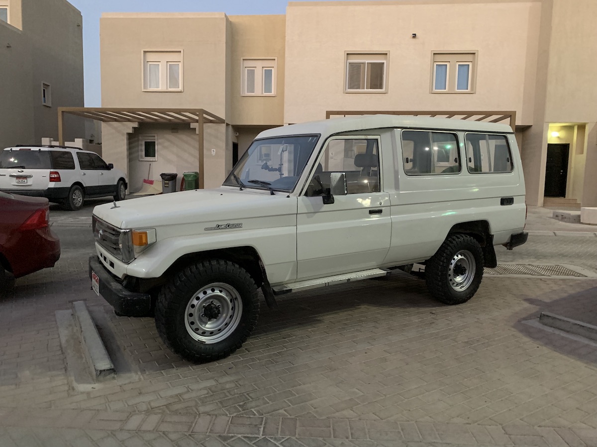

Here's another set of 17x6.5 OEM steelies installed on my Troopy with 255/75 R17 KM2's (roughly 32" x 10"). I ended up painting these wheels Porsche Graphite when I refurbished the exterior.
Again, no spacer required. I have very mild rub on my interior fender apron seal when I turn hard left only.
These wheels were just ridiculously cheap as 0-km take-offs in the parts yards over there. Like less than $150 for a set five cheap.
