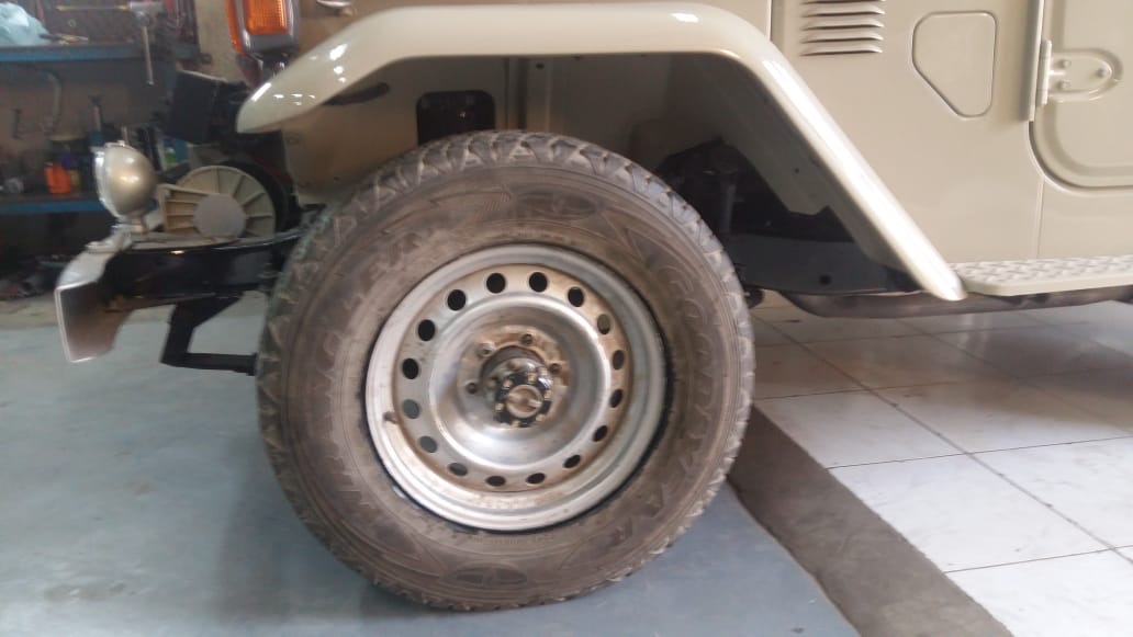

There are commonly available OEM steel wheel takeoffs in the Middle East in the 16" and 17" variety. The 16" wheels generally come off the Hiluxes... and the 17" wheels come off of Prados (what I've been told).

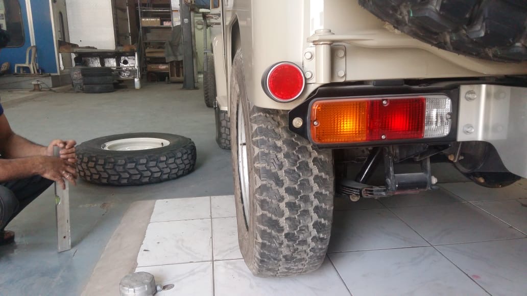

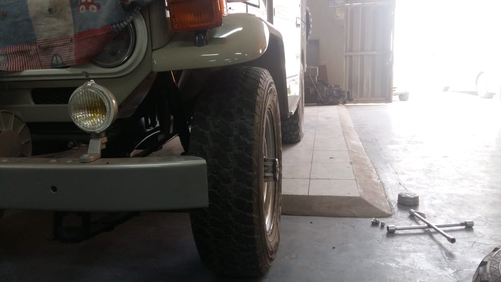

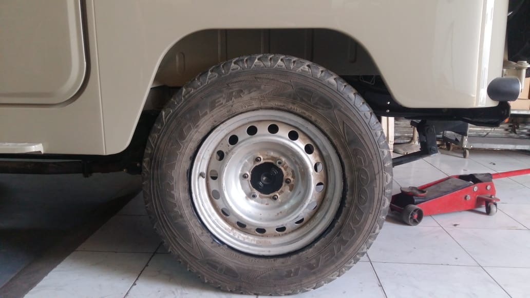

I picked up a set of takeoff 17x6.5 OEM steelies to test on my 40. This was while I was back in Abu Dhabi. I wanted to source Toyota steelies that I could eventually replace my splits with given how difficult it can be to get tire shops here to play with the splits.

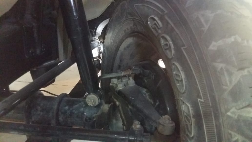

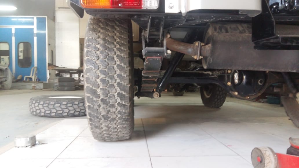

Here is one tested out with a 245/75 R17 (roughly 31.5" x 9.6"). No spacers.

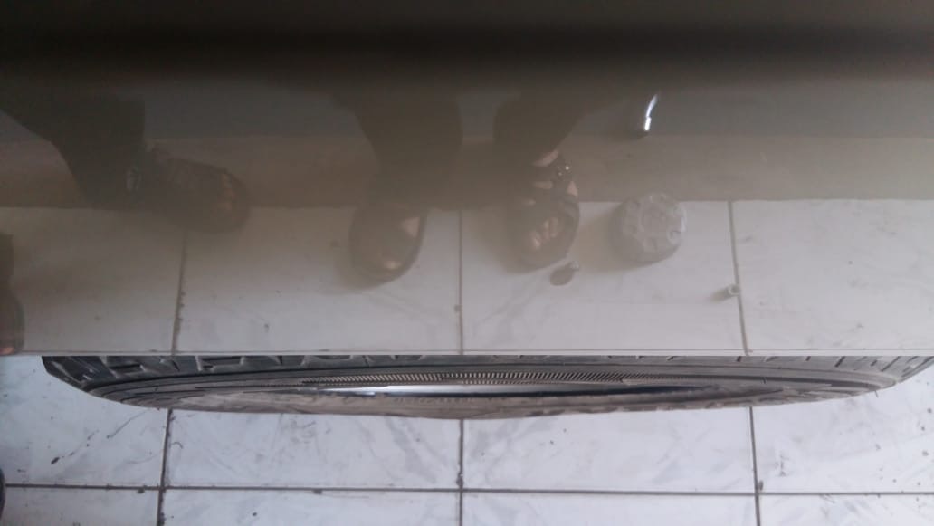

On the rear there's a very minor amount of protruding...

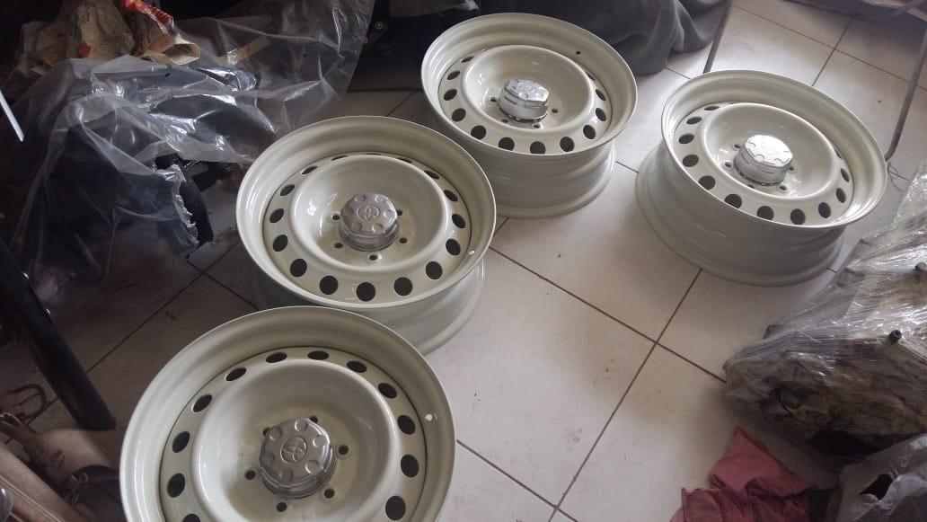

So I had a set of five painted up white to match my roof and bezel... saving them for new tires once I get a lift installed.
NOTE: While I appreciate the shops painted-to-match pewter hubcaps I'll be taking a pass on those.
