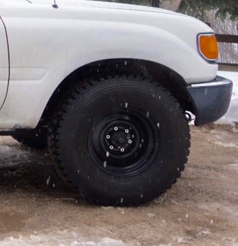

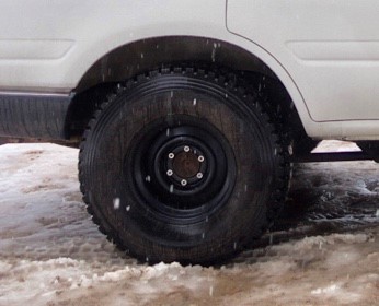

I'm thinking about putting some steel Wheel Vintiques Series 12s on my '93 FZJ80. I've only seen one other member (@Mark1313) with these wheels. Anyone have more/better photos?
Also, I'm not crazy, right? These wheels will actually fit an 80 series, correct?

Since the OEM backspacing is 4.5", and the Wheel Vintiques backspacing is 4", the wheel will sit slightly further out. Anyone think this will be a problem? I'm running a 315/75/16 tire on an OME 2.5" lift (with fender flares).
Not a problem at all to run those with the 4" BS, pretty much perfect in my eyes. Not my style but will look cool none the less!

The std Aluminum wheel is also 16x8 with 0 offset. you should be just fine to run these.

The Wheel Vintiques Series 12 16"x8" isn't quite 0 offset. But very close. -12mm
