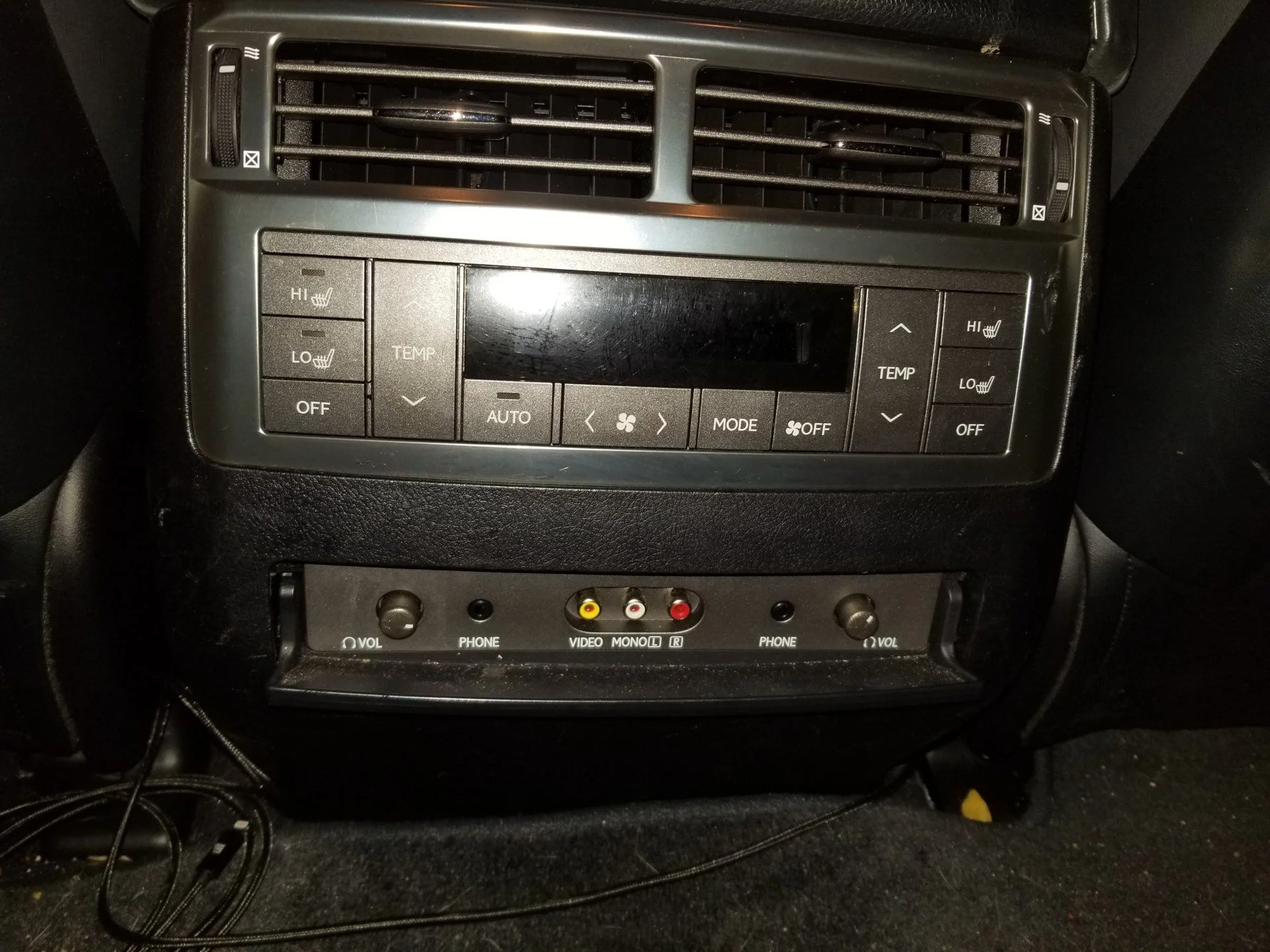

I'm thinking this was changed in the 2013 refresh. My 2011 LX does not have one in the middle which I was a bit surprised by. I have temporarily been using 10ft cords just threaded back through from the front for the kids.

You can pop that rear cover off easily, and when you do you'll see there isn't a whole lot of empty space behind it. However, I did install a 12v outlet on the far left lower corner. It's do-able, but there isn't much choice in where it will fit.
A shallow mount USB port may give more mounting options than a standard 12v plug port. I also recall seeing someone on this forum install an external mount 12v plug on the bottom left side, near the driver's seat mount.

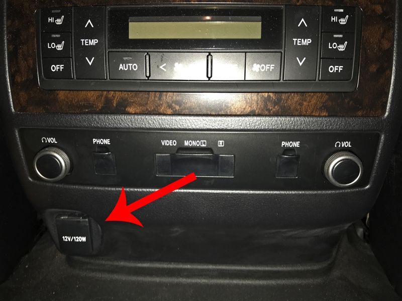

Yup. added in 13 on the LX.
@gaijin my 2008 LX doesn't have rear entertainment, Mark Levinson, or power third row seats. Bit of an oddball. My middle console looks like @Ali FJ80 's above minus the 12v port.

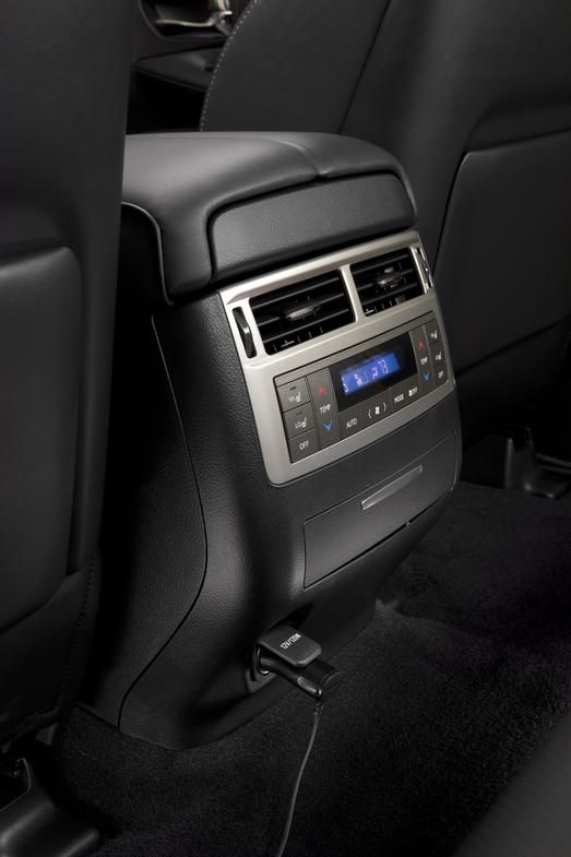

This worked out great. Cord is under the mat and I secured the charger to the seat hinge using 2-sided extra strength Gorilla tape.
Are you concerned about the low 12V plug mount point getting kicked/broken by 2nd row passengers or gear? Seems like they could have raised it above shoe-level.
Chicago is colder than antartica this week and my TPMS sensors are not functioning. Is it too cold or did a battery die?
Nah, my kids are tiny :) The charger is slim enough that you don’t really make contact with it sliding in an out.
