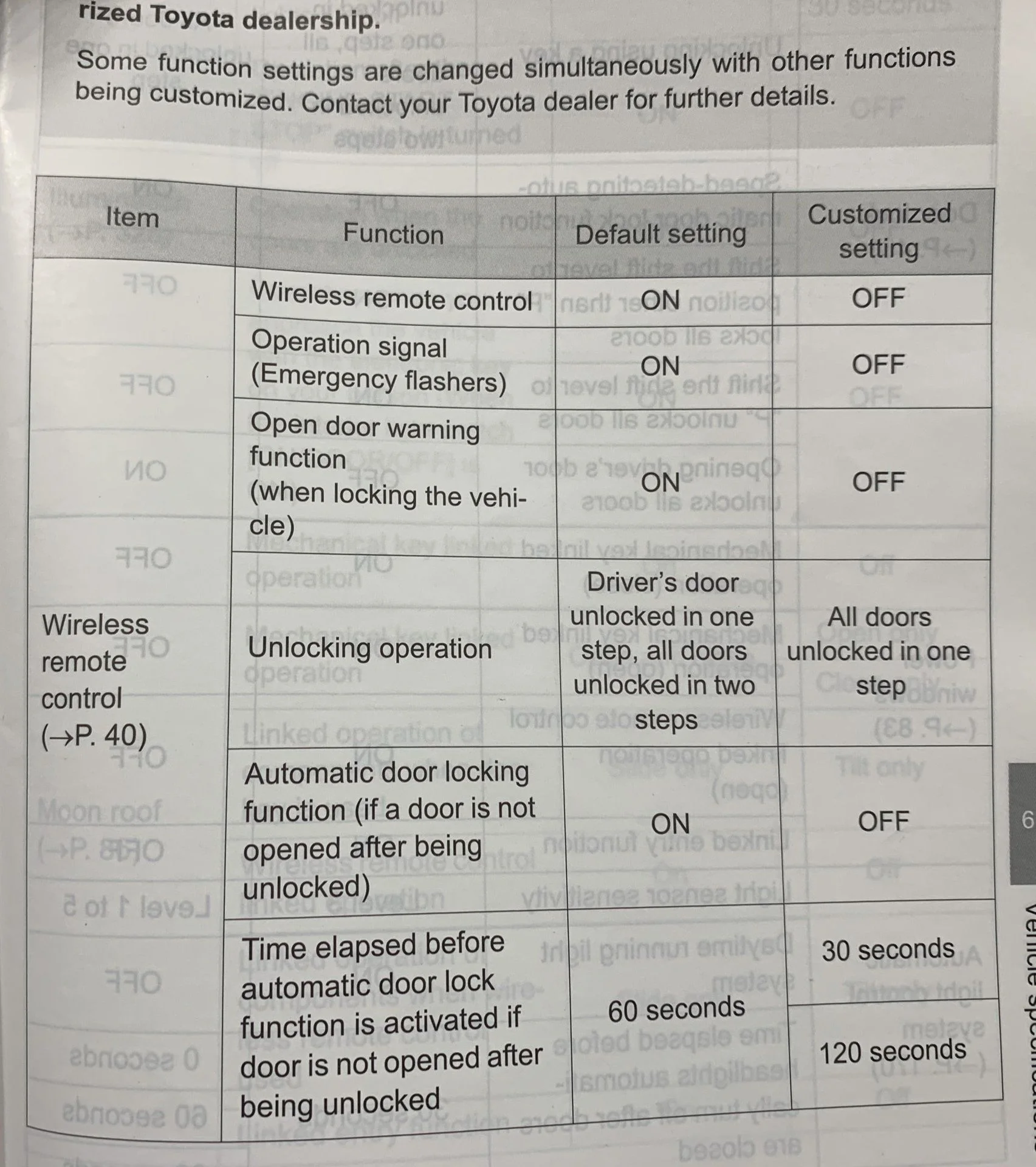

Strange experience this morning. I started up the rig to warm up and thaw the ice off the windows. I left the key/remote in the drink holder and went back inside. A few minutes later I went back out to find all the doors on my truck were locked. Strange but no worries I figured, so I went inside an retrieved my second key/remote only to find it would not unlock the doors. Now I'm getting pissed, I need to get to work and on my way. I then tried the manual key and that would not open the driver's door. I'm F-ed and call AAA and they used a "slim Jim" to get me in. I shut the truck down and tried the locks, everything now seems fine...Anyone have this experience? I sure don't want to go through it again.
Sounds like it auto-locked assuming you were inside and running the truck long enough. Weird it would do that if it was in park.
Any chance you were in D with the parking break on instead of Park?
You can use custom settings to tell it NOT to auto lock after being on and inside and out of park...also whether to unlock other doors when you open your driver door.
Also...Quite a few other tweaks related to auto locking.
For my 2008, here are the relevant pages. Yours may be different:
1911465
1911466
Truck was in park the whole time. I plan to check my settings tomorrow. I have it set to lock all doors when I put it in drive but maybe somehow it got changed? Still odd that my extra key remote would not open up the doors.
Ya, there are custom settings possible that I can’t imagine anyone wanting...but kinda nice they are there.
Will be curious to learn what you find.

What strikes me as odd was hard key not being able to unlock doors?
Maybe a couple things here like low battery in fob + the park detection circuit was open. I bet the car thought it was driving. That would probably lockout the exterior key.
Just for grins I'm going to start mine, get out and lock doors then see if the hard key works? Not wanting to have to call AAA I'll have someone in the car to unlock if necessary.
Roll the windows down first... :)
