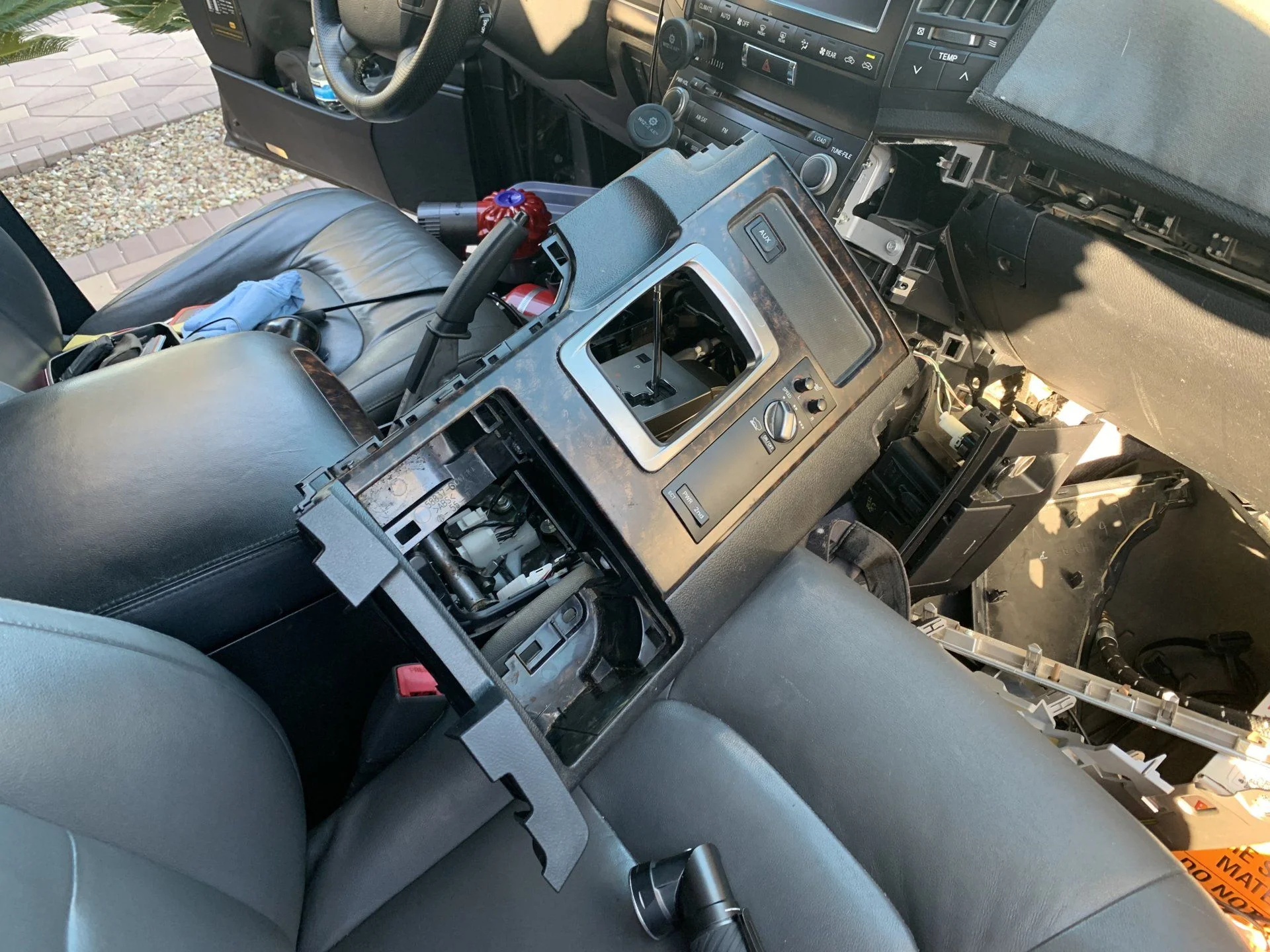

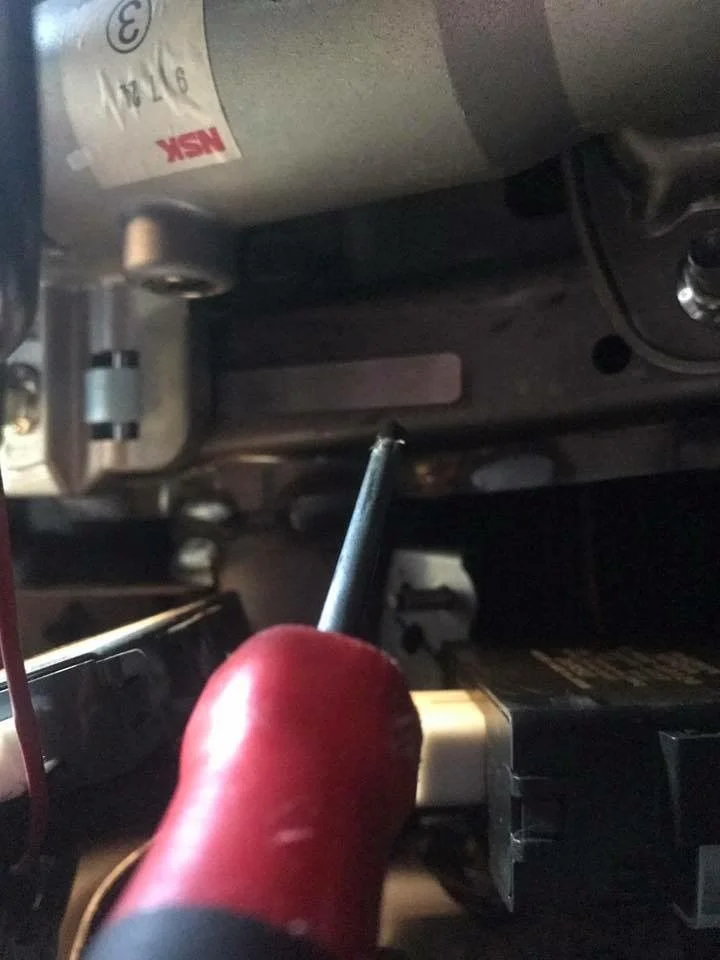

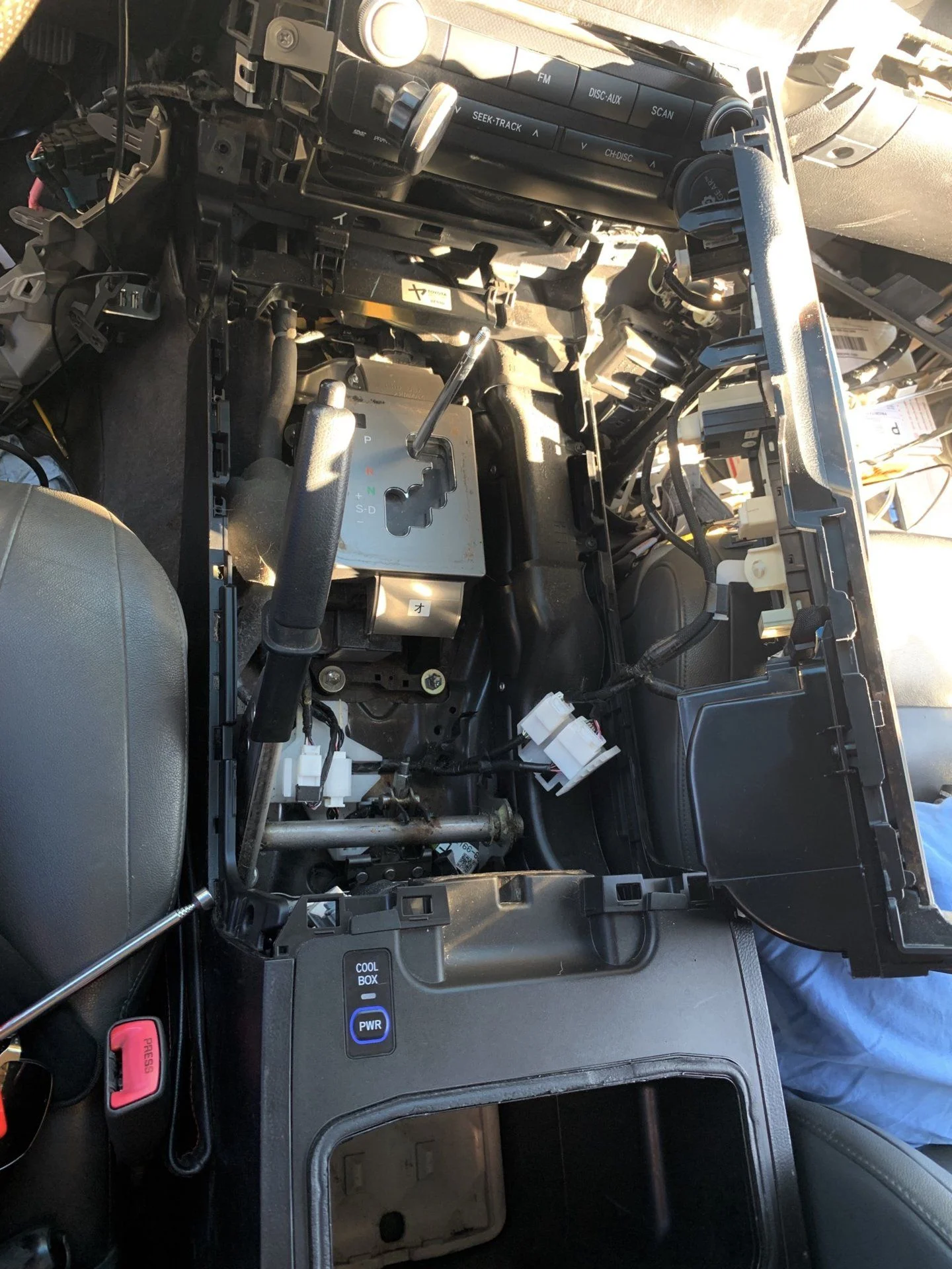

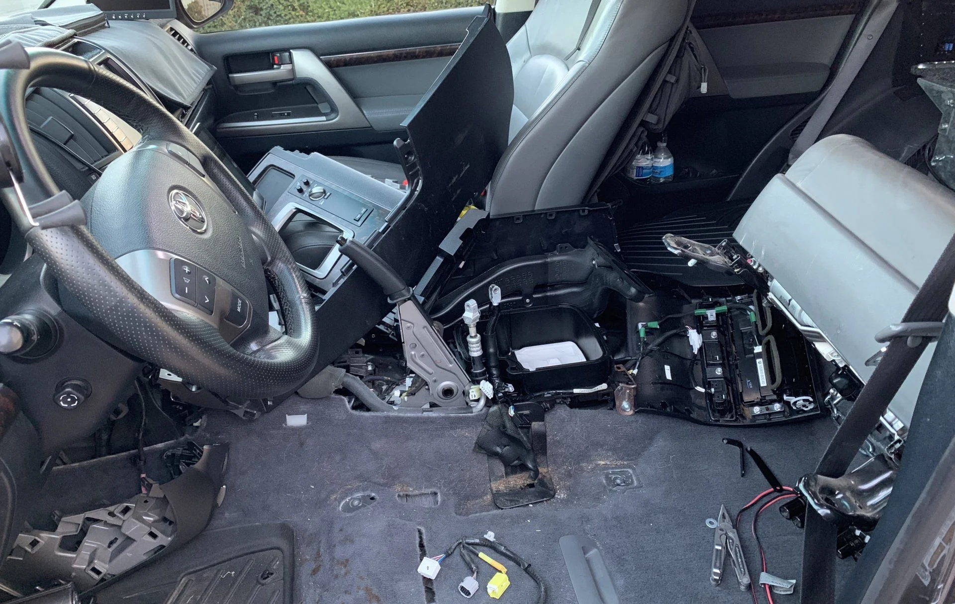

Searched and can't find it. I swear someone had a mini write up or instructions on cool box fan replacement. Can someone please point me in the right direction?
That was my thought too when I did mine...but I couldn’t find such a thread either.
I followed the steps in the service manual...but their direction are NOT always the best.
It might have been easier if my eyes weren’t screwed up...but no matter what, it is a huuuuuuge pain. Right around 120 steps just to dig down to it (screws, brackets, plugs, panels, etc).
My one big mistake mistake can definitely be avoided. Still, it is pretty much an ordeal to dig down to the fan...including one final screw that is impossible to get to without removing the driver’s seat and also using an extremely low-profile screwdriver (as in...one you’d never find at Home Depot).
Run awaaay!

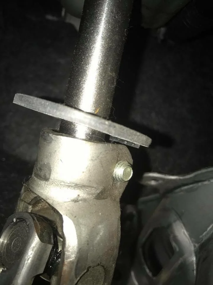

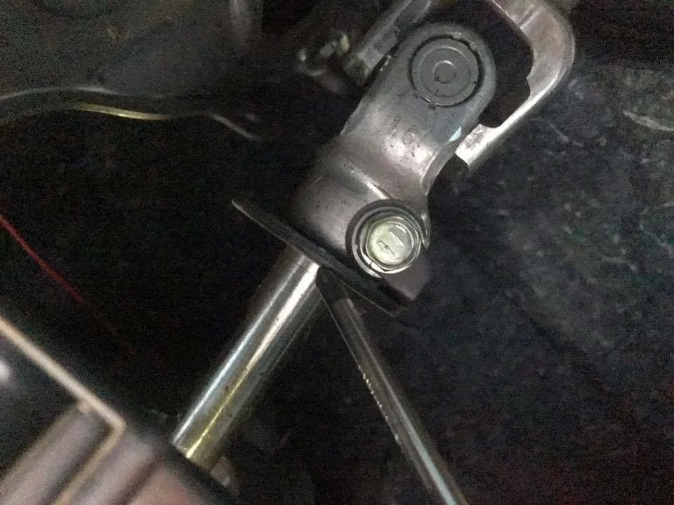

I've noticed an intermittent rattle right behind my steering wheel when driving down the road. When I push forward pressure on the steering wheel, it stops. Searched and couldn't find any others with this issue. Any idea what I can adjust to make this stop?
Look for this washer/component on your steering column and this little plate. Common issue to have it rattle. There is also one right down near the firewall that can rattle offroad
What's the fix for those loose pieces on the steering shaft?
