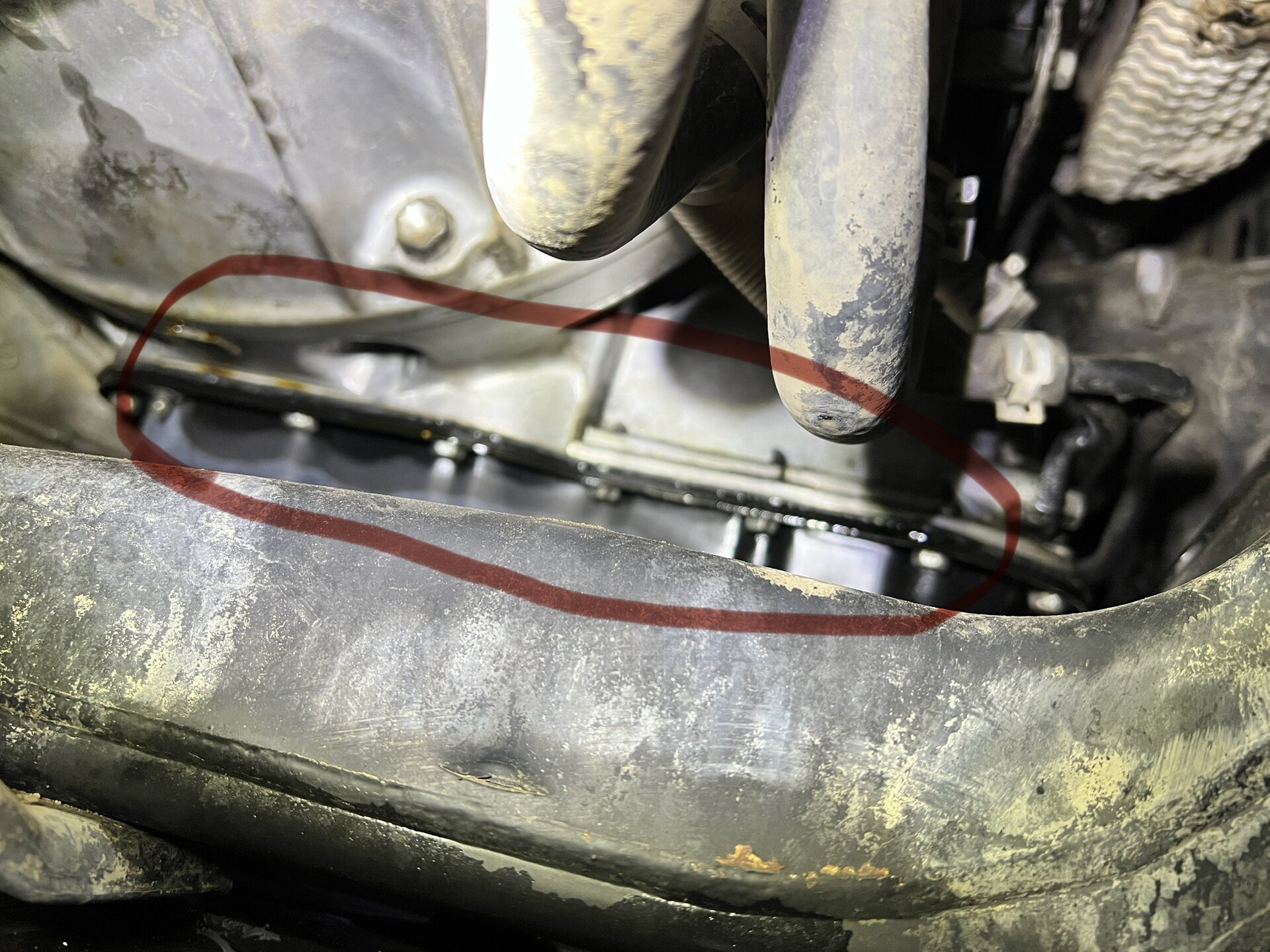

@ryanCA that is the lower engine oil pan pictured in your second picture. Isn't that what you just resealed? It could also be coming from a source inside or above the bellhousing and just accumulating on the lower pan flange, but it is really hard to tell with the out of focus pic. It looks like there is a fair amount of oil around that plug at 6 o'clock on the bellhousing.
I'd clean it off really well/degrease it, and then watch every day to see where the oil is originating from.
ok guys - i did the oil pan reseal. i am still getting some oil drip pooling on pass side
it looks like it’s coming from this pan
help appreciated
It’s hard to follow this oil leak saga when it’s scattered in the SQOD thread. I do remember it being a problem for a while, maybe after a service? Is it coming from up high, or could it be a rear main seal? (Assuming your pan and seal job are ok.)

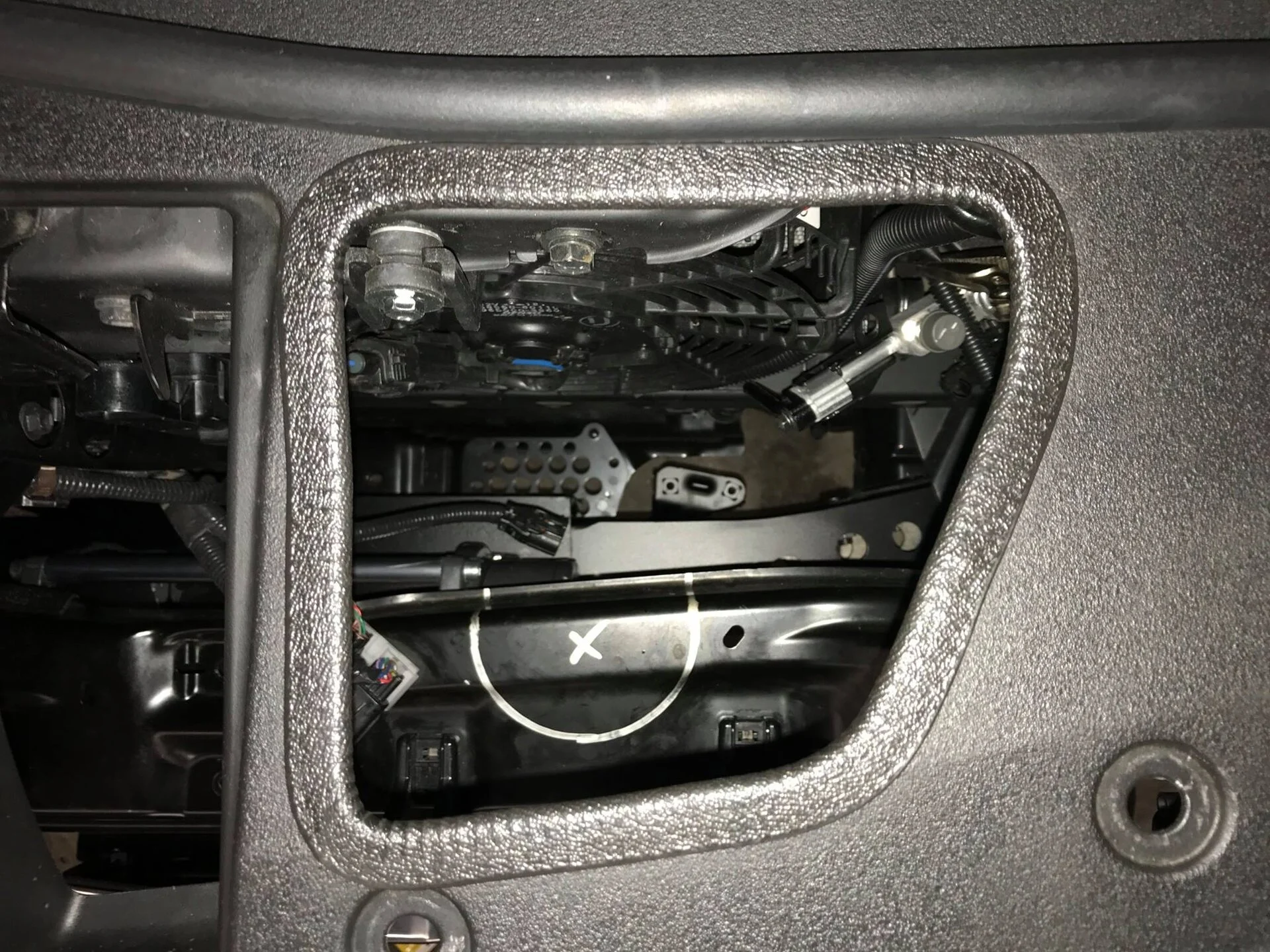

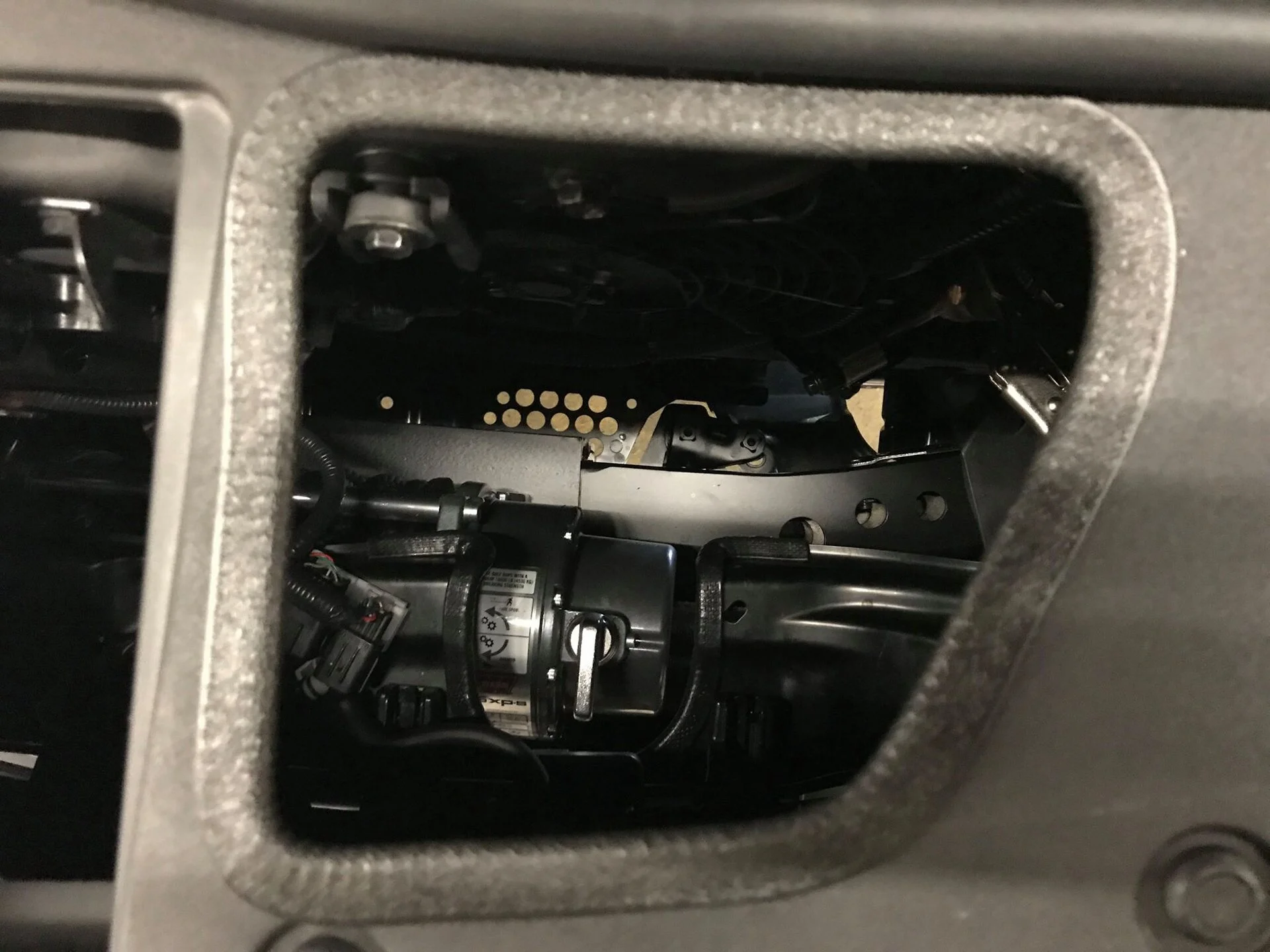

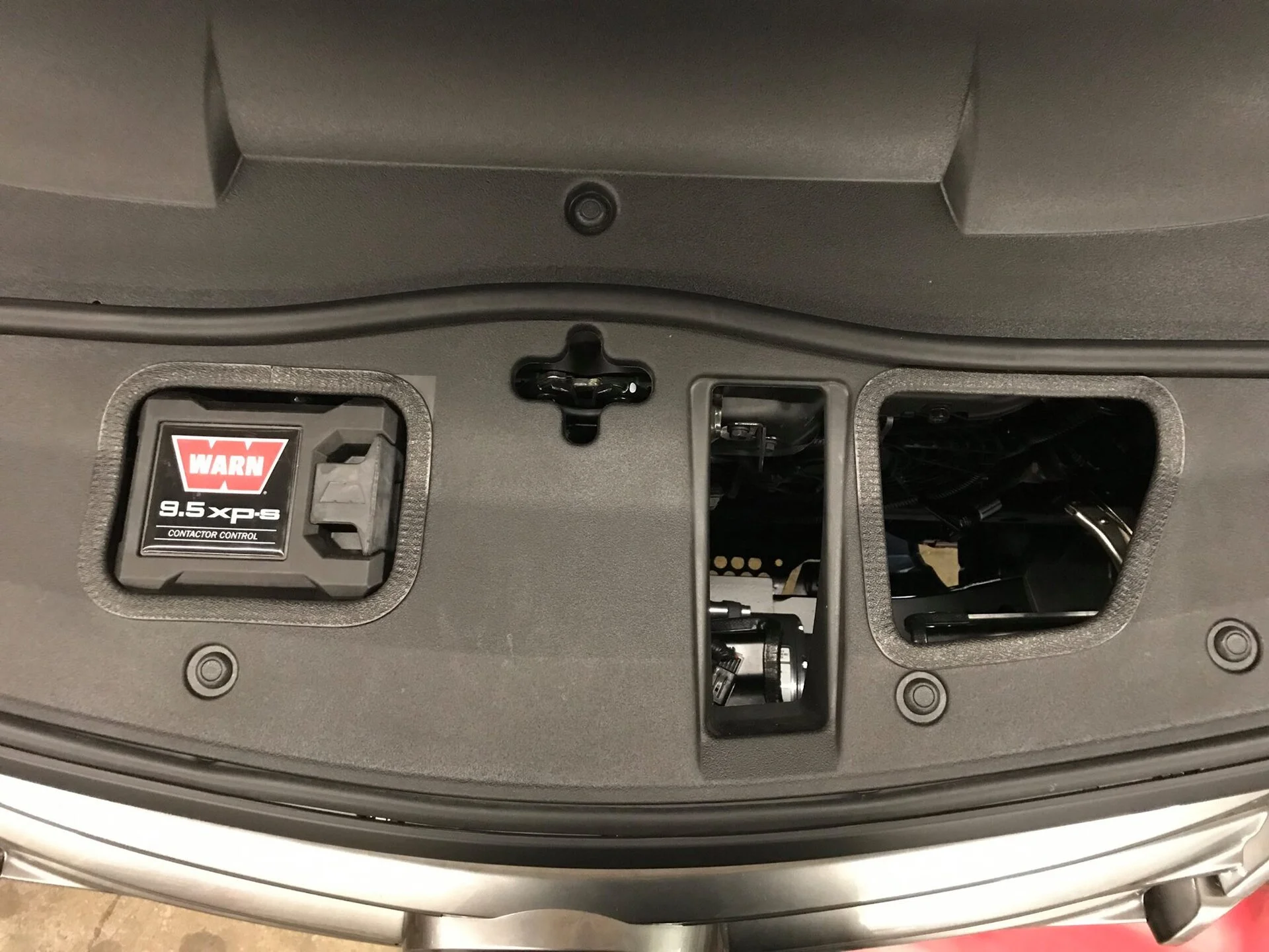

Hey everyone, I’m about to install a hidden winch in my 2016 LX. There’s not much that exists on here on the facelift LX, so looking for advice:
I need to cut an opening in the black plastic engine bay cover so I can access the switch for the winch. What can I put around the edges of the opening over the rough edges of the plastic so it’s not sharp and it looks finished? Here’s a photo of what I’d like it to look like. Credit for the photo goes to ACC Garage (@BMThiker).
that looks like plain old pinch trim, sometimes called pinch weld. You can also get it with a rubber trim piece attached to cover over gaps. You just need to measure how thick the plastic you're cutting is and get the corresponding thickness.
Thanks @grinchy. Do you think something like this would work? I’m not sure about the thickness of that panel that covers the front of the engine.
KX Edge Trim Black Small, 1/8" Fits Edge, PVC Plastic Edge Trim U Shape Black Large Edge Protector (10 Feet) https://www.amazon.com/dp/B07PRHG81Z?tag=ihco-20
