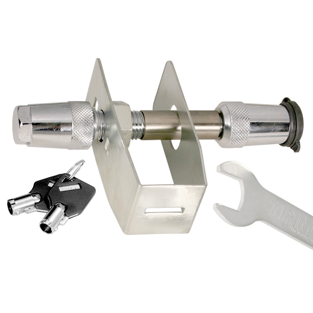

What device iare you guys using to keep the slop out of the hitch receiver? For eight years, I've used THIS style wedge device on my Outback, 4Runner, and 200 to tow an 850 pound Hiker squaredrop trailer. But now that I'm towing a 5000+ pound Oliver using an Andersen weight distribution hitch, I can't get it to stay tight. I've driven it in with a hammer and punch and tightened it way too tight, using removable thread-locker, and it still slips. So every time I start and stop, I get a heavy "clunk" as the hitch moves in the receiver.
With the LC's flush receiver, there's no room for one of the U-bolt style clamps. What are you using?

I ended up buying the Trimax TAR300 Anti-Rattle In-Receiver Stabilizer (which also has a locking hitch bolt):
On first tow, I had to tighten it once, but I've not encountered any slop since that adjustment. I have a Y-frame trailer, so no WD hitch on my setup. I'm not sure if a WD hitch would affect this product's performance or not; something to consider before you buy it I suppose. Overall, it's been money well spent for me.
Thanks for the suggestion. But the Andersen hitch draw bar is solid, so this style wouldn’t work for me.
