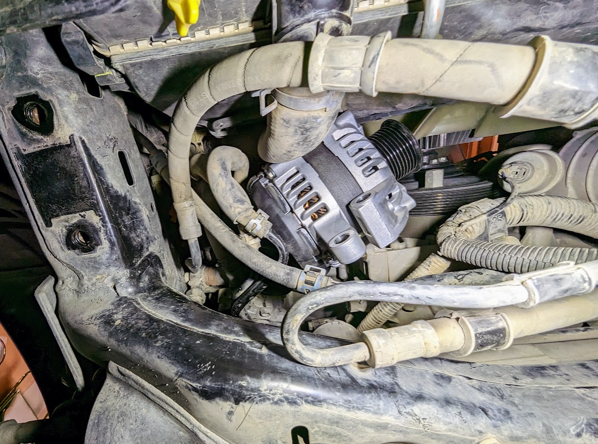

Here's the position I found to sneak the alternator in/out. The major brackets on the alternator casing make it wider than it is long if that makes sense. Smoosh it through all the lines and the lower radiator hose. Now this is for the LX and I was able to swing the sway bar out of the way. Not sure how KDSS would increase/decrease the fun.

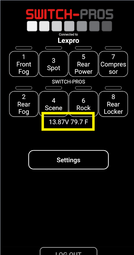

Battery was pretty drawn down referencing a voltmeter. 11.9V before starting.
First power up, mucho better. I was looking for 14V+ but perhaps the battery is pulling things down sucking down juice.
Now to get the rest of the details in place, and back on the road-trip!
Nice work!
KDSS Should be mostly the same other than having to disconnect the lower end of the front KDSS ram and use a jack or something to lower from it's neutral position before dropping the bar. Many of us are used to the relatively mild force on the end of the KDSS arm when we reinstall our sway bar links because of the leverage it has over the ram. but IMO jacking from the ram itself would be a lot more force.. kindof an interesting thought experiment.

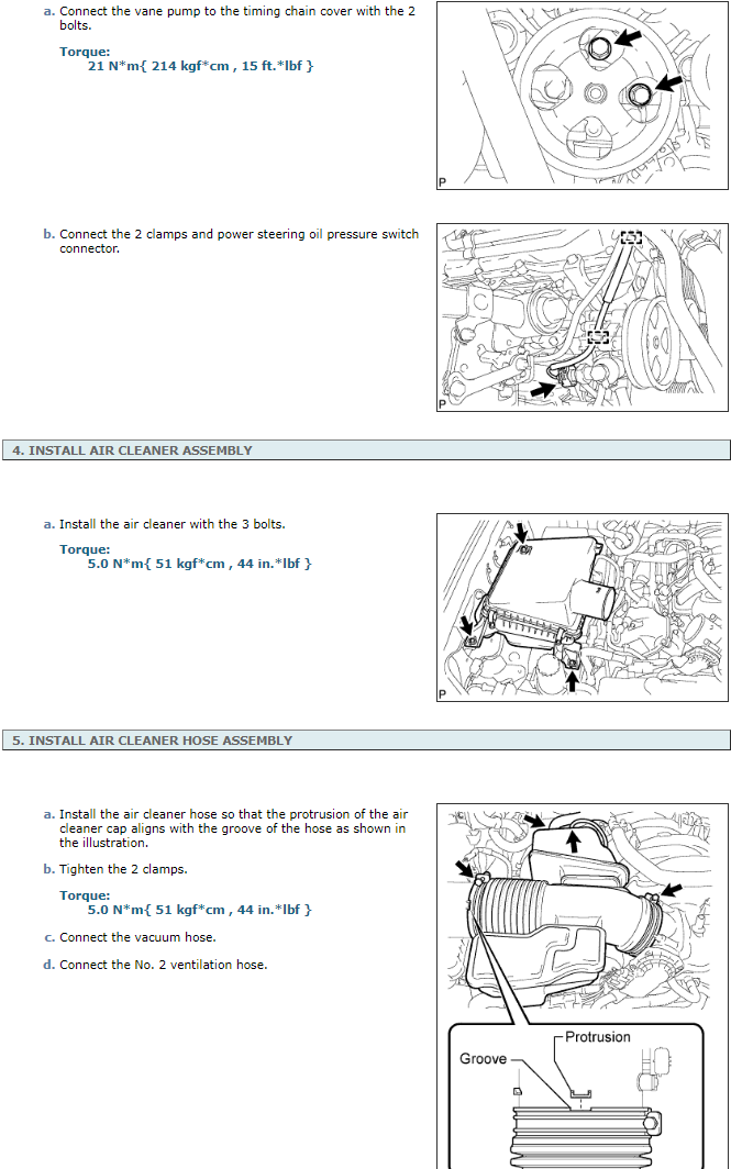

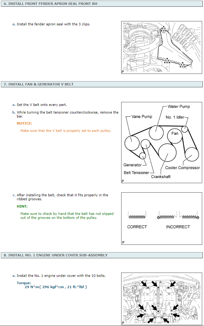

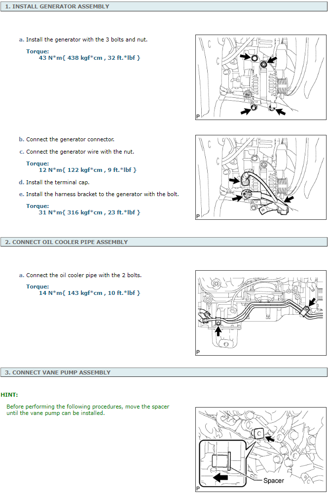

My alternator install is coming up soon. @TeCKis300 what torque did you use for the alternator mounting bolts? Do you by any chance have a pointer to the install manual? TIA!🙃
MANY thanks! I would have guessed 34 for the bolts LOL!

Is there by any chance a FSM set of instructions for alternator removal?
Happy to but looks like the site is down ATM. Will check back.
Thanks! I really appreciate it. This alternator upgrade is proving to be a bit of a nail-biter and I want to get at least the Toyota suggested approach to the mechanic. I just got the new one today, btw.
