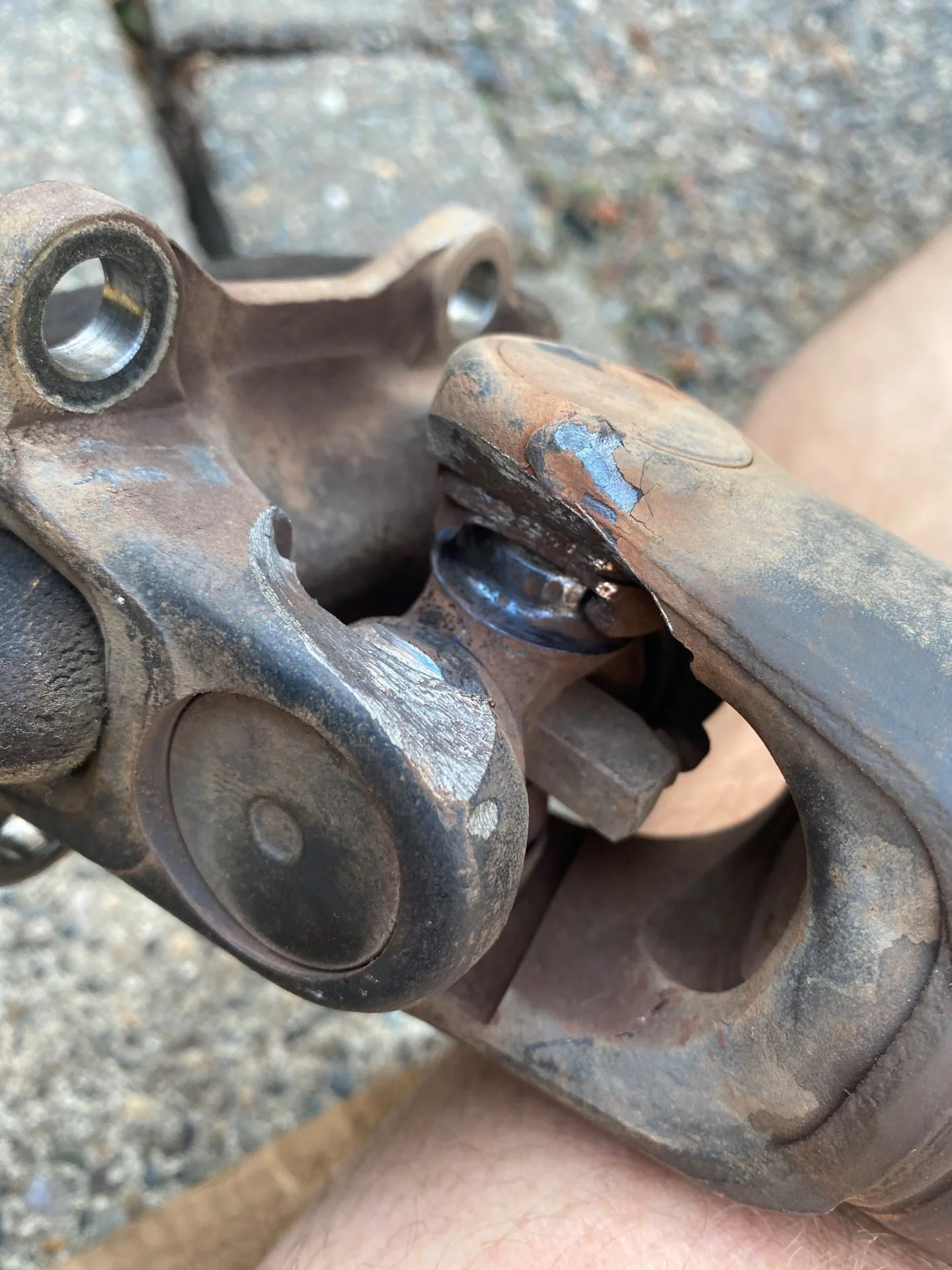

I would say that u- joint failed due to lack of proper lubrication, which has allowed the yokes to contact each other. Looks like an expensive repair. How many miles?
Pretty confident that’s what has been happening. I can hear them contacting now that I know what it is.
190k miles
$317 for an OEM replacement
$317 is a great deal for a new Toyota driveshaft. Just bolt 'er in and as good as new. Keep the new one greased better than the old one lol.

You’ll need the entire driveshaft, not just the universal joints. Too much damage to the yoke. Discount parts places it’s around $500 plus shipping and installation. How is the rear?
I would say that some type of debris, either a lost piece of hardware or a rock got impinged between the yoke ears and the metal became the fuse. If there was enough wear in the joint to cause the yoke ears to contact it would have completely destroyed itself.

I agree. That's really odd wear and could not have come from just bad spider bearings. It shows, however, just how tough those u-joints are!

I ordered a driveshaft (3714060590) from Bell Lexus for $317 shipped. I have a Moab trip scheduled in two weeks so I need it sooner than a custom one, plus it's for the front. I figure $317 is a win.

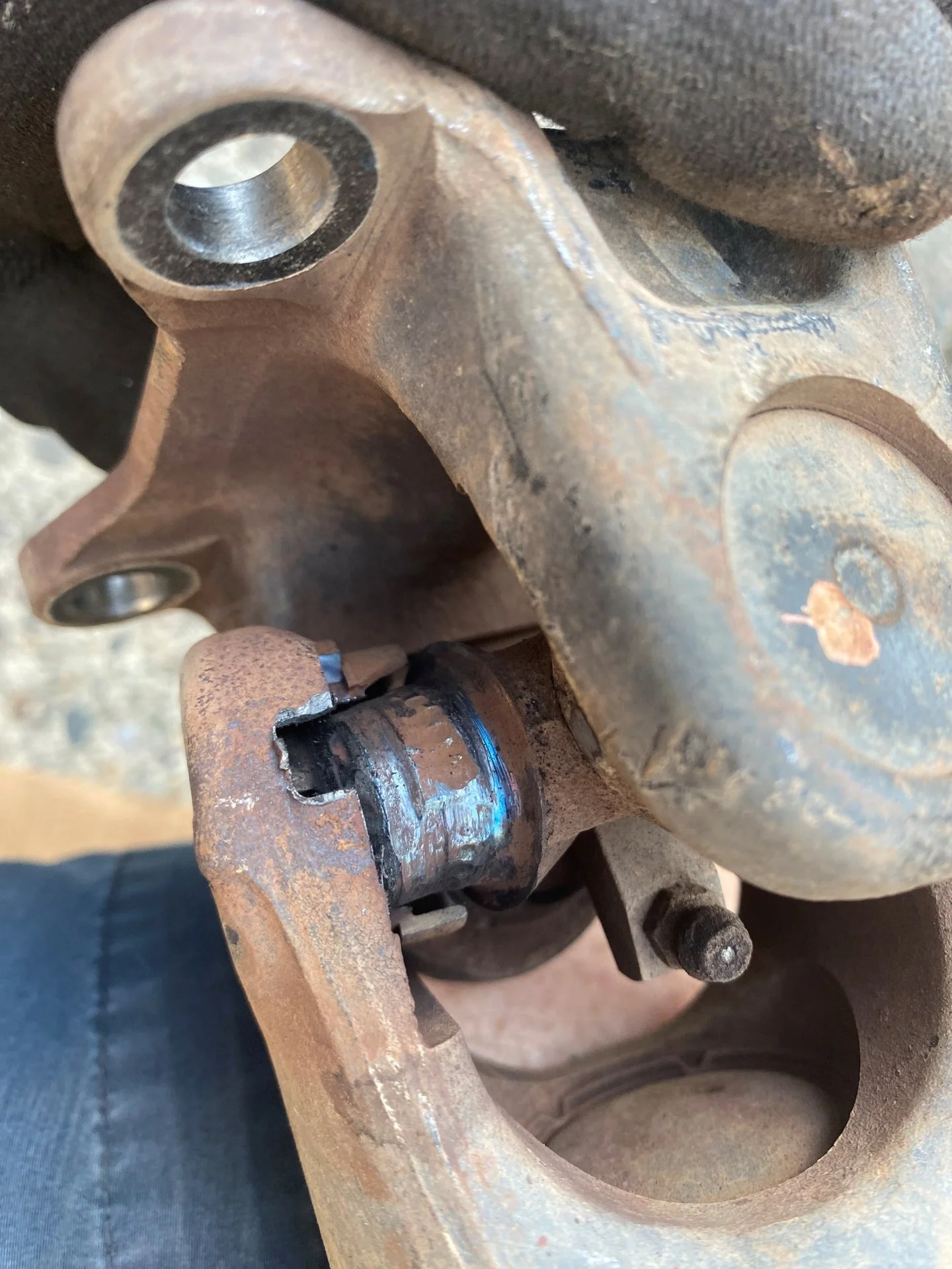

I popped the old one out :)banana: job, 20-30 minutes) and snapped the below pics. I think it looks like maybe a combo of things. Looks like a snap ring came out and lack of grease. Maybe lack of grease caused it. Who knows. The front u-joint was solid.
Anyways, let this be a lesson to make the effort to grease every u-joint... not just the ones that are easy to reach. I'm seriously lucky my driveshaft didn't come loose and do some serious damage.

In looking at this closer, I'm leaning away from my post above. What I thought were witness marks from external abrasion now appear to be the fracture plane.
I thought that's what you meant in your post above. Something got caught in there and broke both halves of the yoke and part of the spider.
I had originally though that it fractured from an outside source, something caught external to the joint. Now I lean toward thinking that the lack of lubrication caused it to seize and fracture from the inside. Once fractured it relieved the impingement and allowed things to rotate again, albeit with slop.
