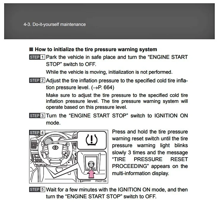

This might help:

Thanks. I followed those instructions. No real confirmation other than manually lowering tire pressure I guess. There is no readout that indicates what the trigger point is. Why can’t we just manually set a pressure value rather than have it check current pressure and then set to 0.8x?

The "trigger pressure" for the system is 75% of the specified inflation pressure used when initializing the system. Door jamb RCTIP is 33psi, set tires to 33psi, initialize TPMS @33psi, alarm "triggers" at approx. 25psi.
You can fool the system to "trigger" at any pressure you want - just set all tires to 1.333 times the desired trigger point, then reset to your desired CTIP.

I seem to recall a place in Techstream where you can change the set point. Has anyone else seen that, or am I remembering incorrectly?
I've never seen that, but I'm no Techstream savant, so...
But in actuality, evert time you initialize the TPMS you are changing the set point (if by "set point" you mean the pressure at which the low pressure alarm triggers).
For example:
Suppose your RCTIP is 40psi. When you initialize your TPMS with all tires set to 40psi, you are establishing the set point as 75% of 40psi or 30psi.
But what if you are uncomfortable running your tires potentially as low as 30psi and want the TPMS to trigger an alarm at 36psi instead of 30psi? Just TEMPORARILY inflate all tires to 48psi instead of 40psi. Initialize your TPMS with the tires at 48psi and you have changed your set point to 36psi. Now adjust all your tires back down to 40psi and you are running your tires at the RCTIP, but your TPMS will trigger an alarm at 36psi instead of 30psi.
So... even if Techstream had such a "set point adjustment" for the TPMS, I see no particular need for it when there is such an easy workaround.
