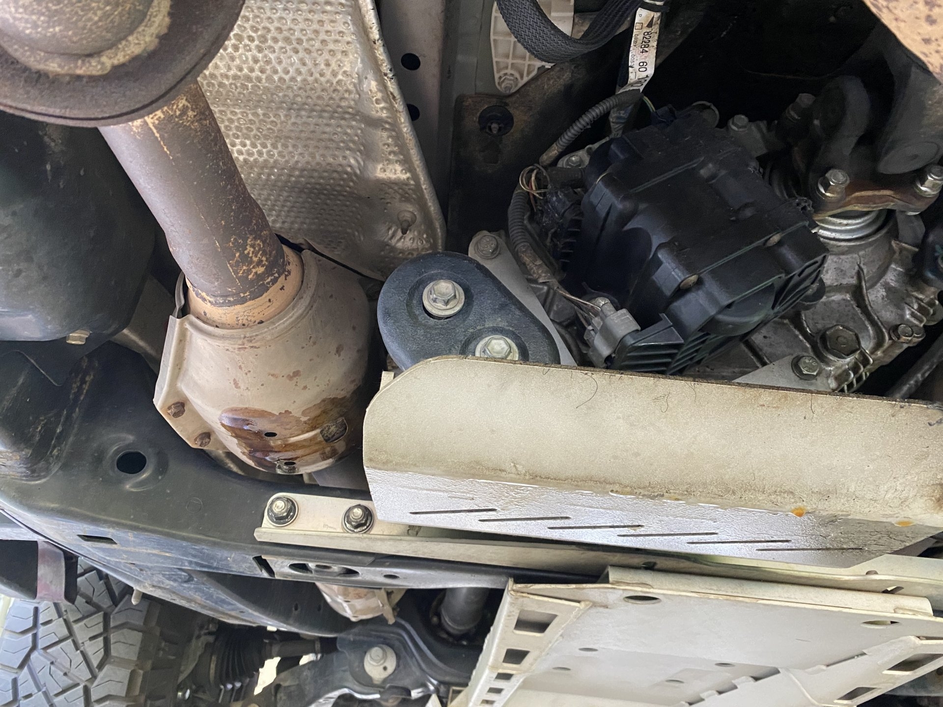

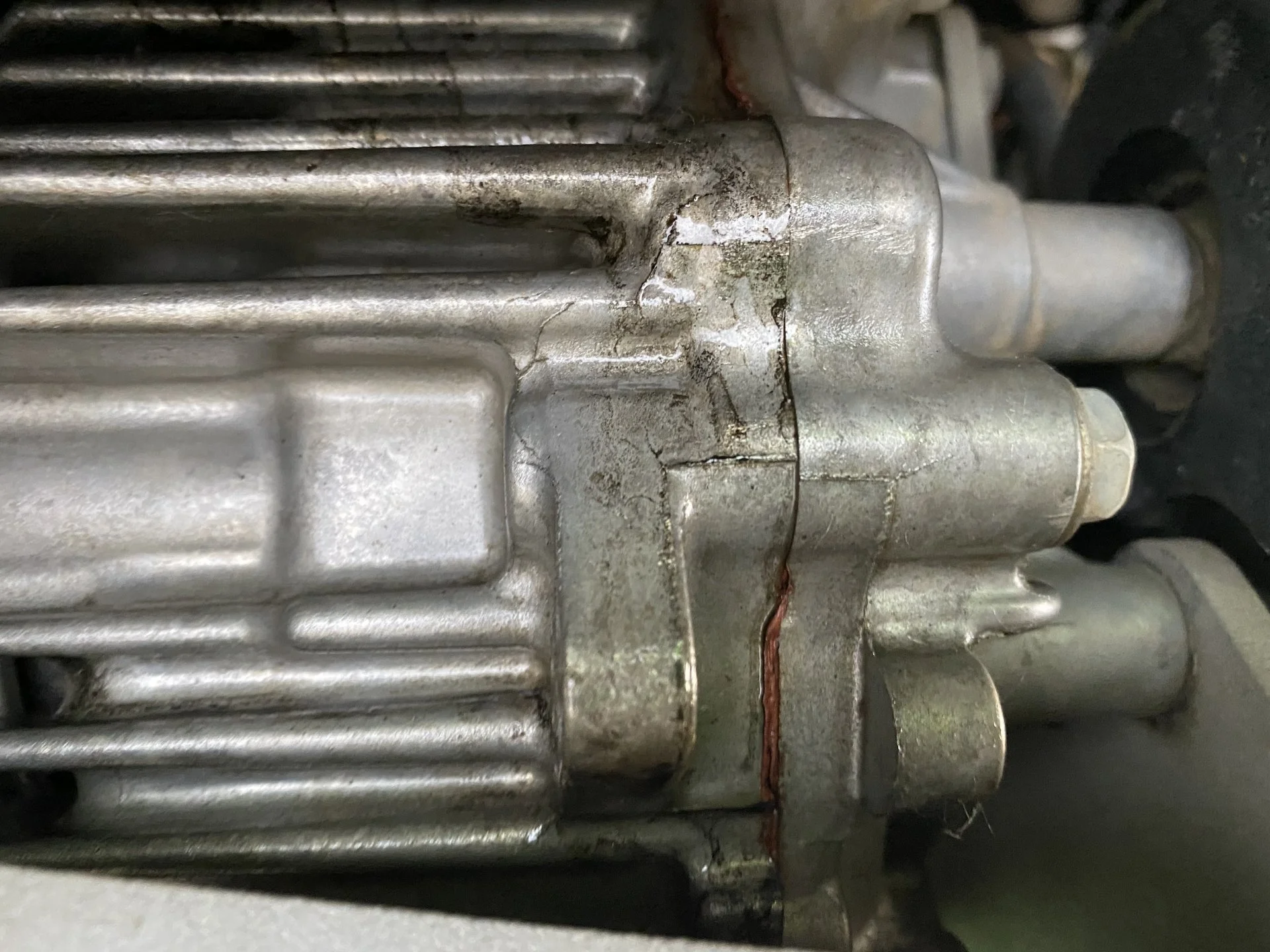

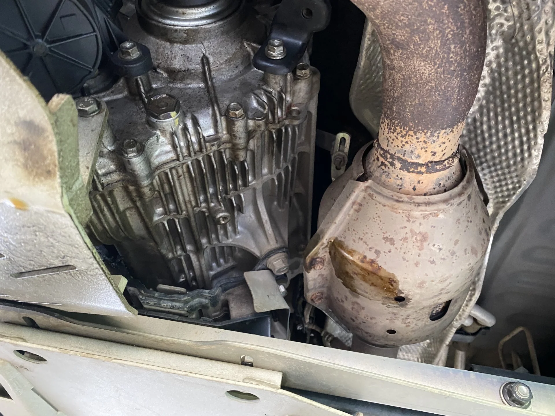

Don’t know if it is gear oil or engine oil. I was due for an (engine) oil change so while at it, took some addl photos.
@indycole no recent / relevant mods (brake pads and rotors), no heavy wheeling recently.
Since re-gearing last year, plenty of wheeling trips as well as a few towing events with a camper.
Only noticed the leak recently.
If you rock crawl at all, that transfer skid is a problem waiting to happen. Mounting to the casting of the transfer is a really bad idea. I had dozens of hits yesterday that would have broken the transfer case if I had a skid mounted like that. Check out the Budbuilt skid mounting for a much better approach to mounting (it only mounts to the frame, a sturdy crossmember, and a new crossmember they add, nothing attached to the transfer case).
