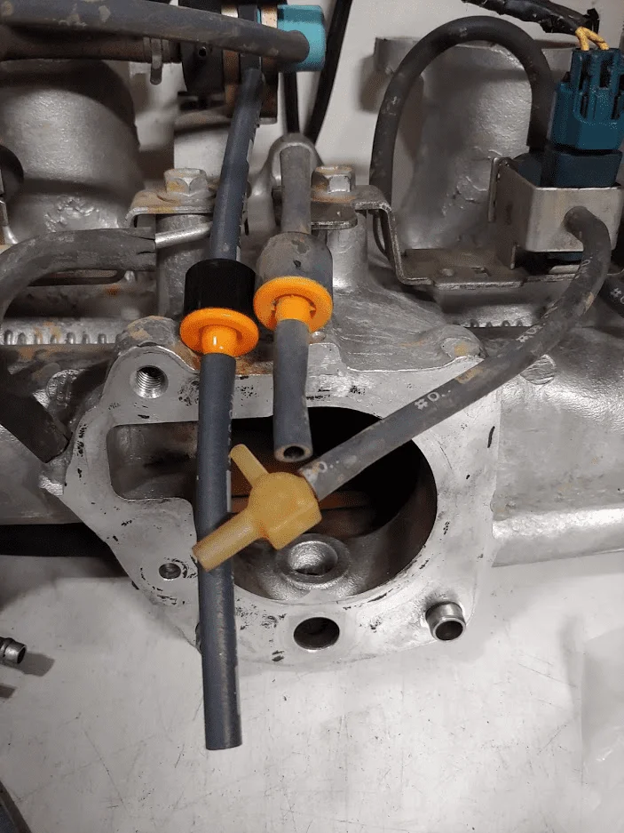

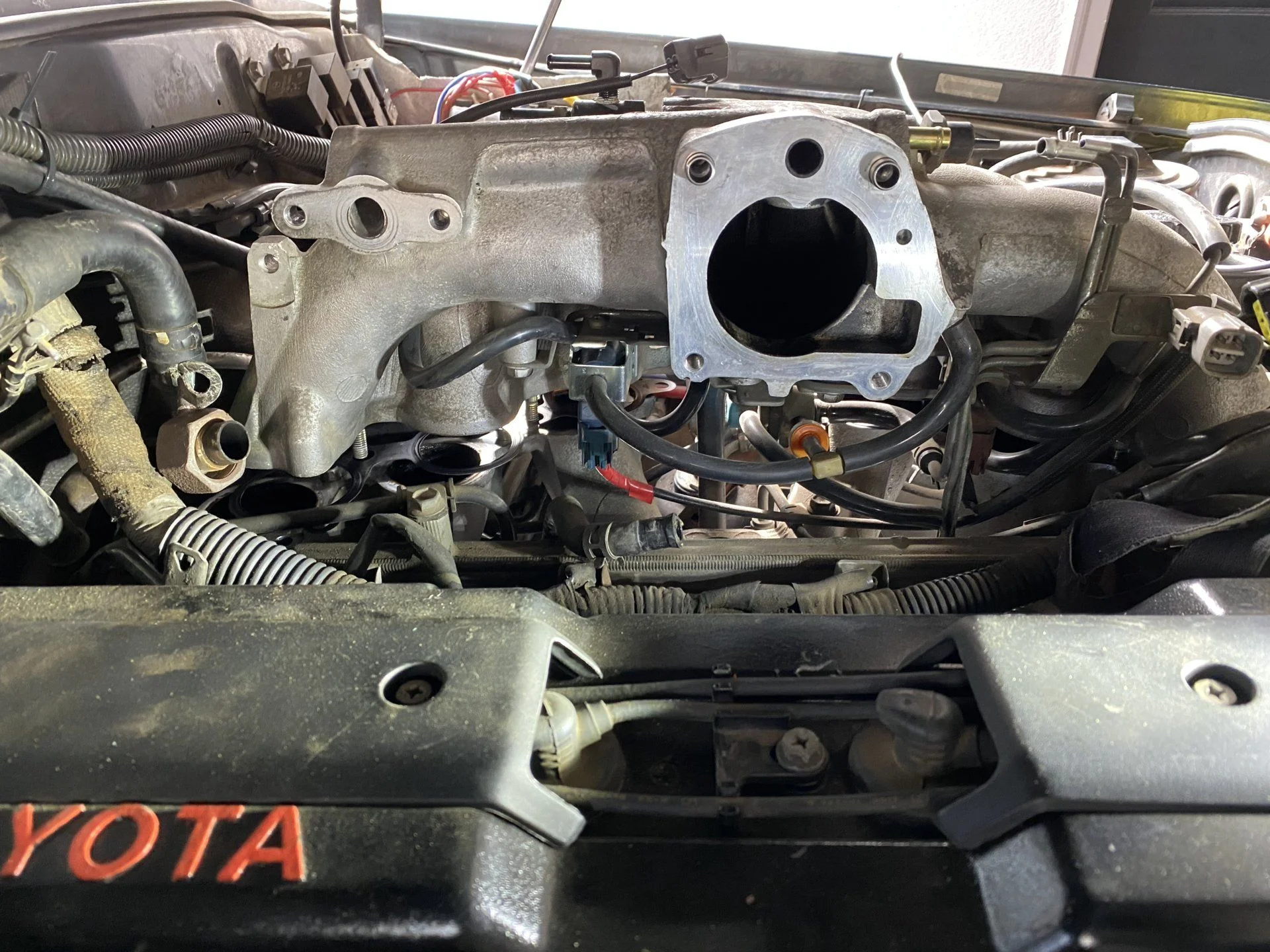

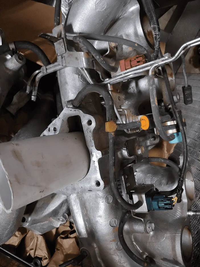

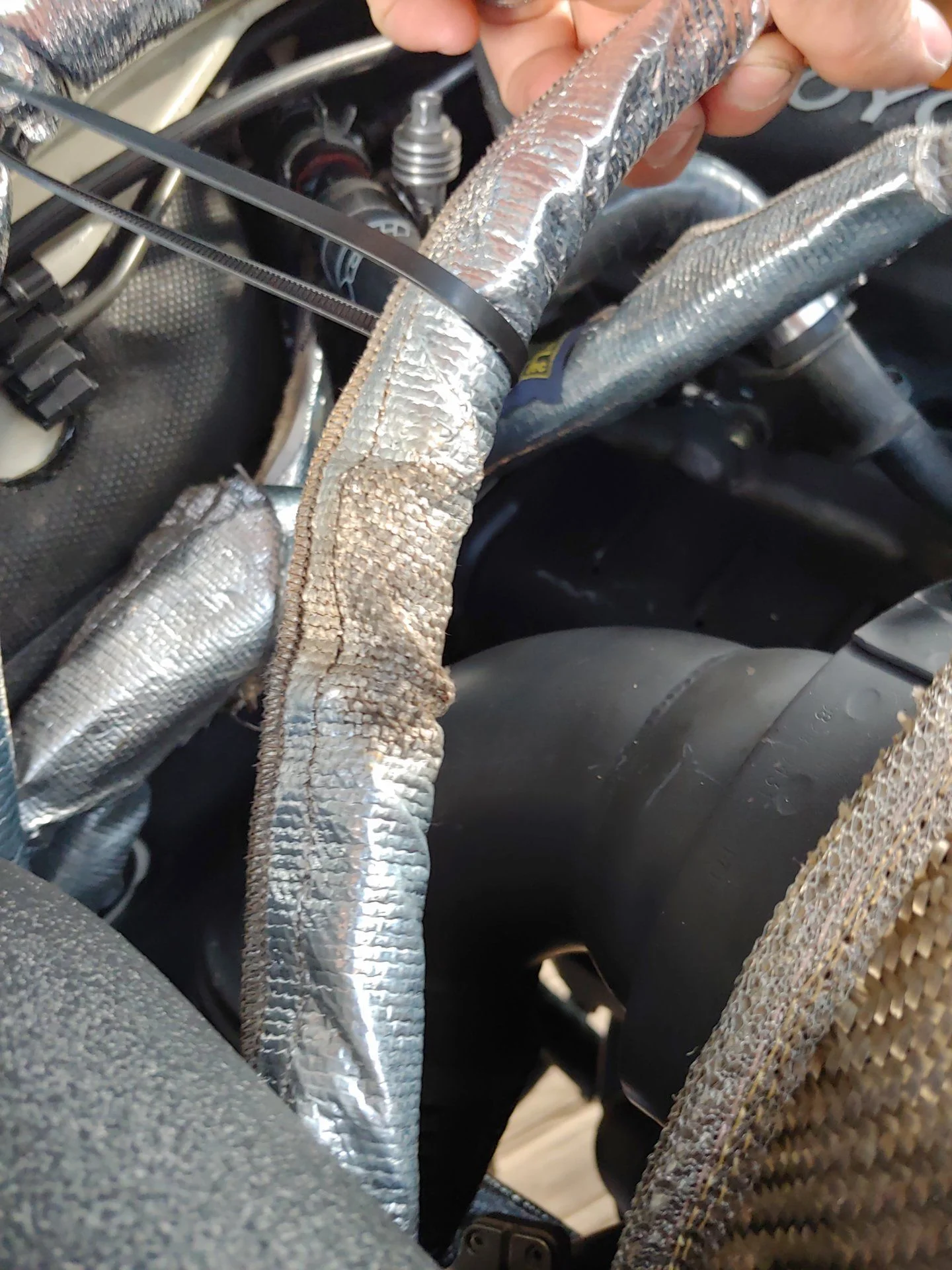

More pics of the old vac lines before I started replacing it with new tube
oh jeez yeah those old vacuum tubes are trashed
yea they were terrible. I replaced them all with your vac hose kit. I changed every freaking hose on the engine. It's as brand new as it gets for a 20yr old truck.
It really sucks when your vacuum lines are jacked-up. Wait, maybe it doesn't suck, like it should. :lol:

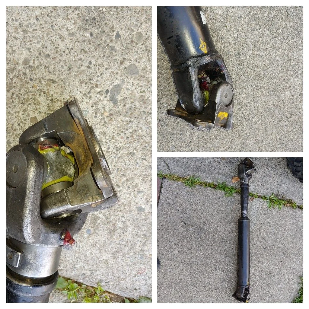

Changed out my ujoints on the front drive shaft. It has been progressively getting worse in the past 6 months. To where it had a constant vibe and sounded like it was going to let loose at any second. Pulled it out and drove RWD for the past 2 weeks. Let me tell you it has way more power in rwd than awd. Was super fun to drive but now I'm back to AWD again. Sorta at least.

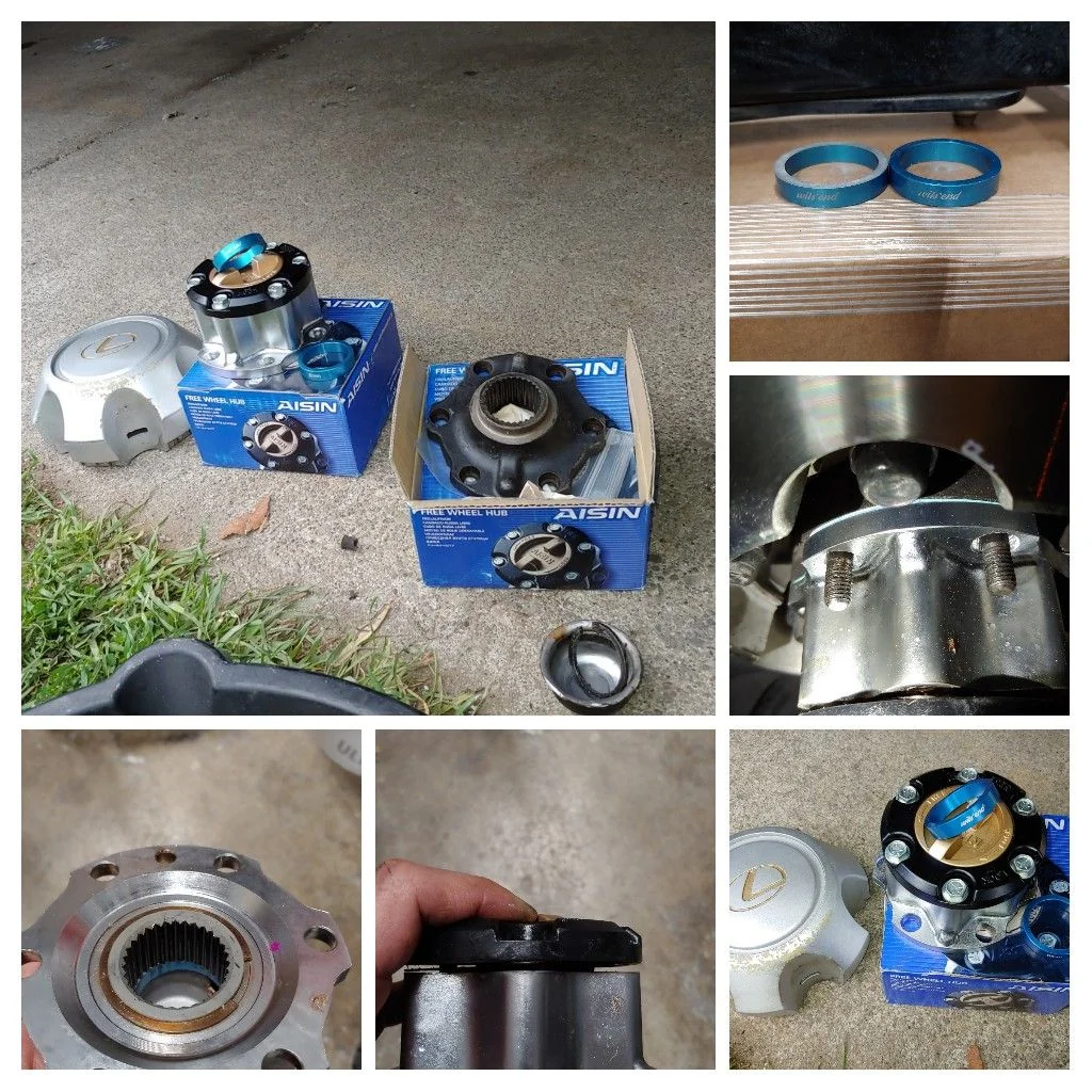

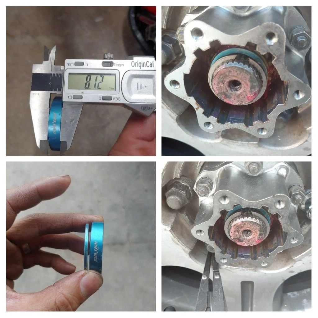

I installed Aisin FHT002 manual locking hubs and had to modify the Wits End @NLXTACY 8mm spacers.
Took a lot of back and forth till I got it right where the spacer fit with the snap ring. It had to be really thin in order to not interfer with the inner hub, dial and gears. I did a test drive and it works fine both locked and unlocked. So now I have AWD and Sorta RWD. Sorta RWD because the front shaft still spins when the hubs are unlocked and center locked. It does divert more power to the rear than the front, but not as much with zero front shaft or PT SPOOL. Both drive and steers totally different. Its lighter steering in RWD with more power. AWD is predictable steering but feels heavy.
I'm tempted to reinstall the PT spool I just removed. Not sure at this point. Going to play with it more.

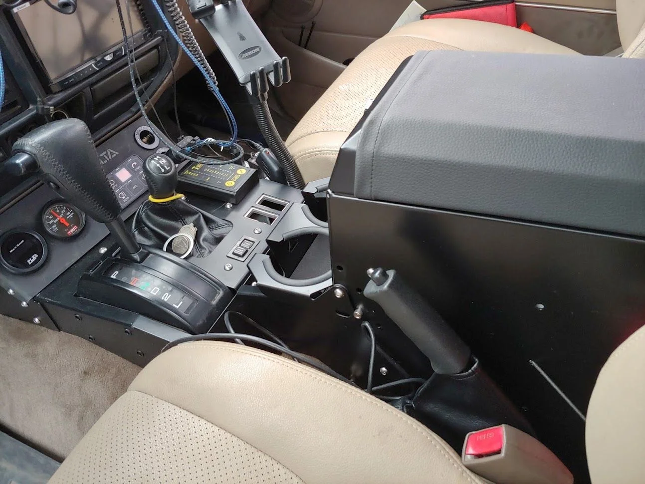

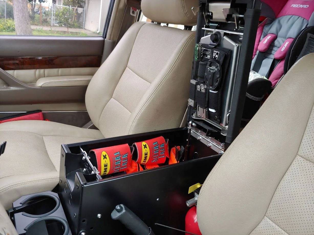

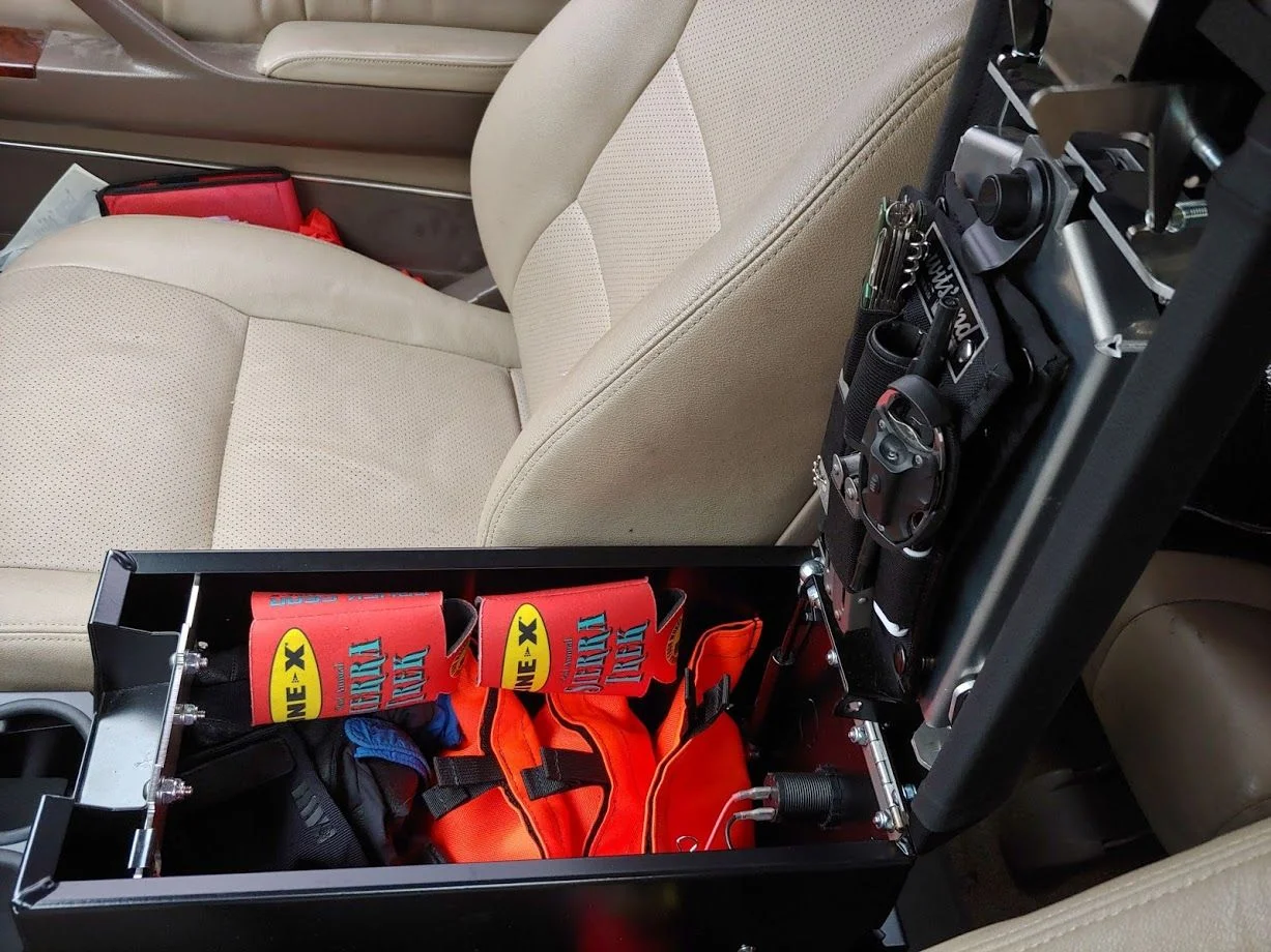

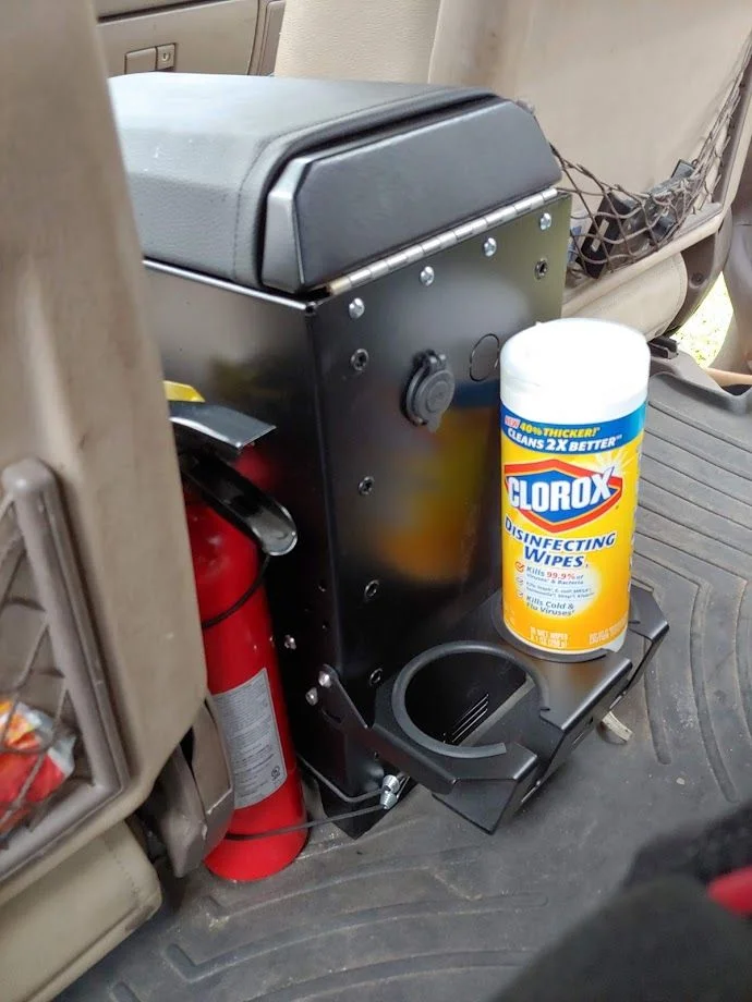

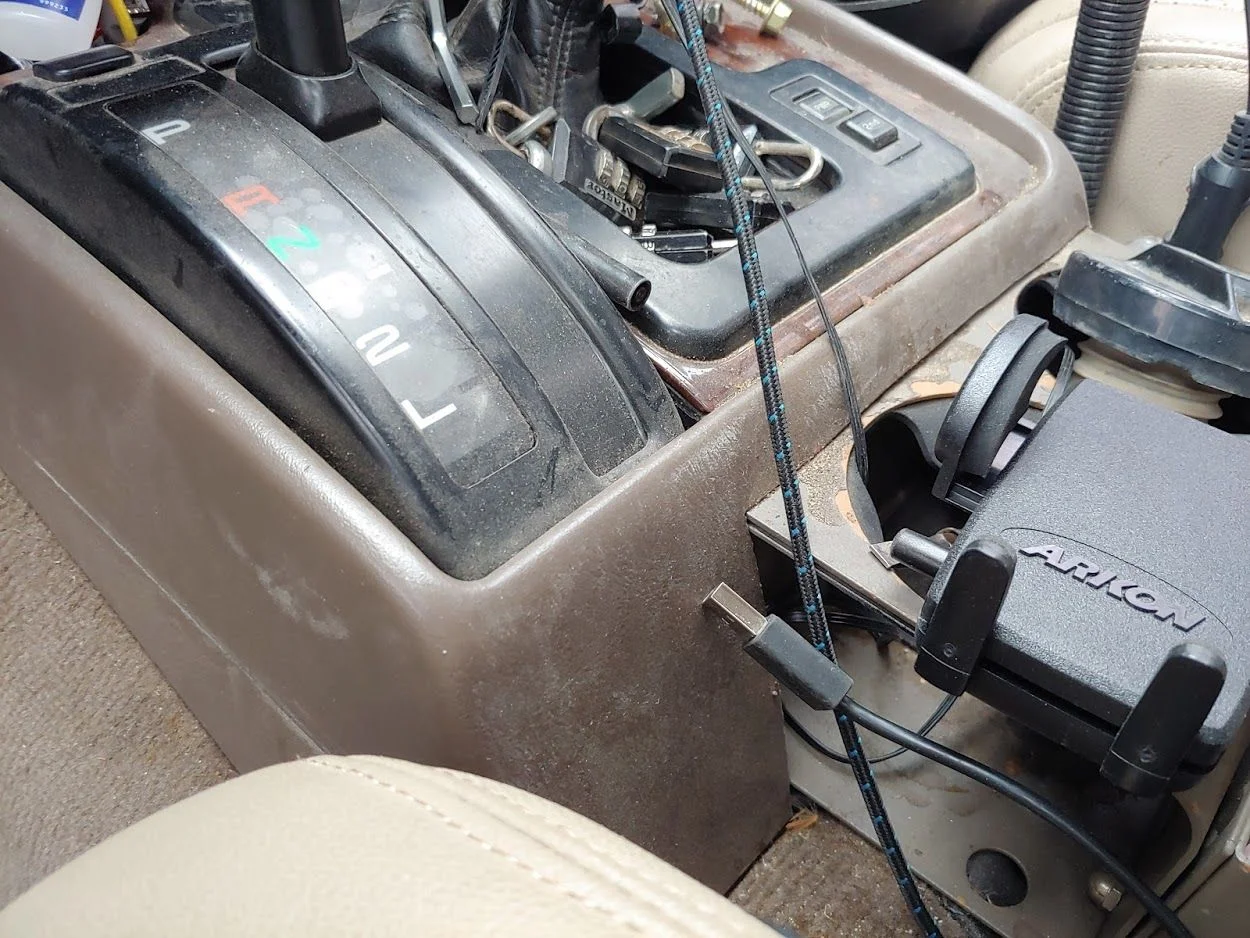

@Delta VS @NLXTACY Finally completed my Delta Console full install and attached my Wits End APU1.
The install went fairly easy. I added 1 extra 12v plug for the rear but I think I'm going to buy some additional (can't ever have enough 12v sources).

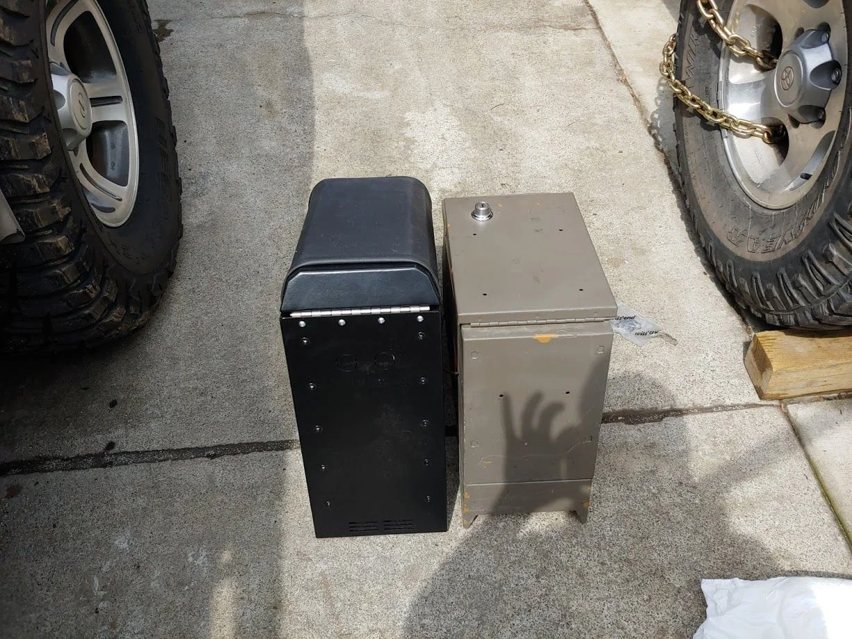

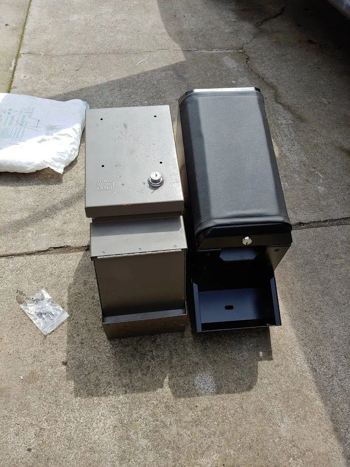

It's definitely more room inside the Delta than the Tuffy. The Delta gives more leg room for the 5th middle passenger. I used the Tuffy for 4 years and loved it. Not sure if I love the price of the Delta though. It's very expensive considering what it does. Otherwise well designed product. Only took me a few times to get a good one but Delta took care of me and got everything squared away.
The rig's coronavirus ready with the Colorx in the rear cup holders. LOL
I'm selling my Tuffy box w/ the tuffy dual cup holder, Tuffy center console (new never used it) cushion/pad, 2x keys, 1x1 tube mount and hardware, the OEM LX450 center console trimmed and modded to fit with the Tuffy cup holder. It's a little dirty but cleans up nice. I'll throw in the spray paint can I used that color matched perfectly with the oem interior color.
