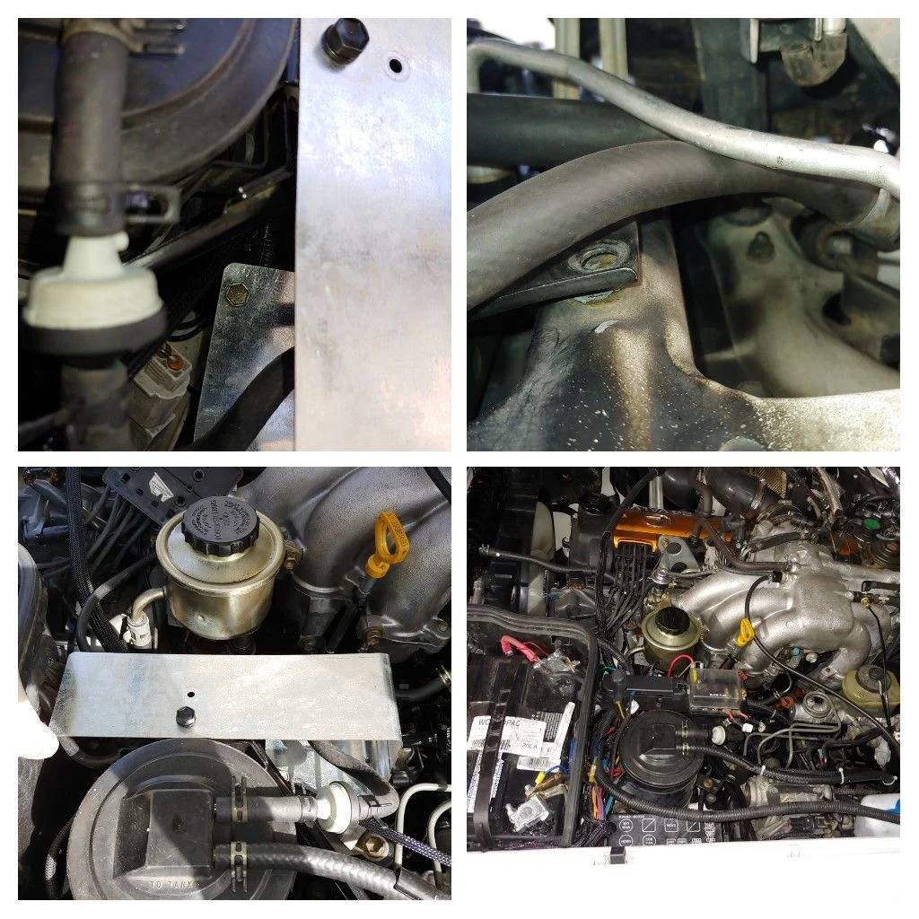

There is an added step of relocating the charcoal canister and fuse block if you want to use the left fender washer bottle. Landtank back in the day made a bracket to relocate the canister and you can still get the factory fuse block mounting bracket...but I don’t think the charcoal canister bracket is available anymore...would need to fab something up.

if brackets are still available I could turn on the CC mounts again.

I just ordered one up...would be great to have the lanktank CC bracket. I installed the little napa bottle but it's tiny and i'm not a fan of the mount design...its too cheaply made for my nice LX.

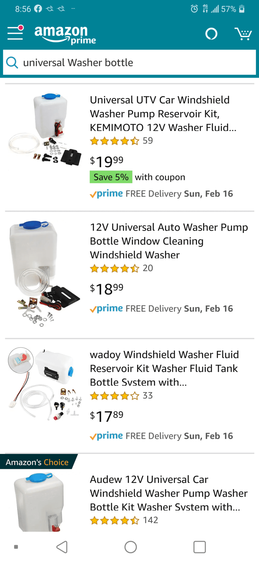

Amazon bottle works in the same spot as @Briano. Used a spacer and a longer bolt for the bracket. Its a really small bottle but its better than zero washer fluid. This will work for Dual battery turbo owners.

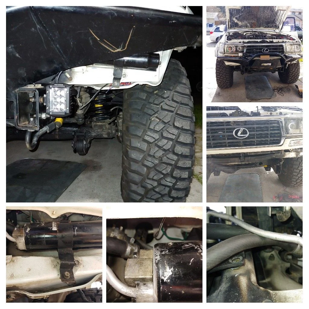

Wired Switch Pro and the relays with old school switches I had in the dash. Both work independently. Switch can turn onoff and inside dash switch onoff. Pretty cool. Took forever. Made my own custom bracket for the ground and fuse block. Bent my AC lines and AC dryer as high as I can to protect it from rocks. Wired up my LEDs again (front rack, bumper and rear rack). Wired up the dual batts and isolator again.
Need to work on rock lights, interior wiring and winch tomorrow.
I didn't know that A/C dryers work sideways! That's good info.
It doesn't work as well sideways. I'm going to test it out some more. I might bend it the other way or rob my 93 LC AC lines for the battery box relocation and swap AC lines
