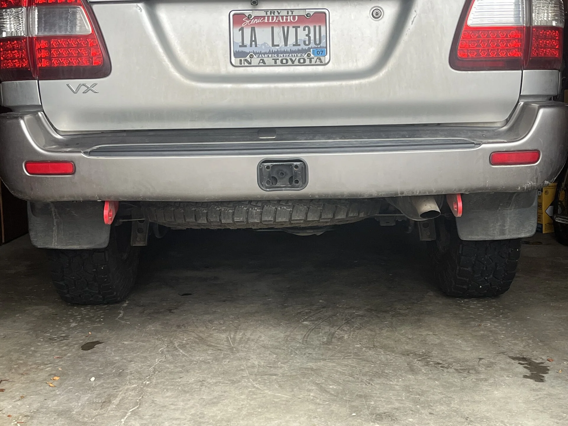

Since no one else replied: I believe the recall was in Australia/not the US. I could be completely wrong. I myself would actually love the chain hoist as I’m concerned if I didn’t have the tow hitch bracing the tire from behind the tire would certainly come off from dragging on the ground.

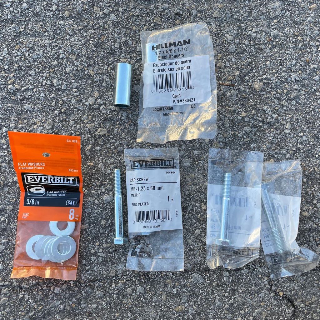

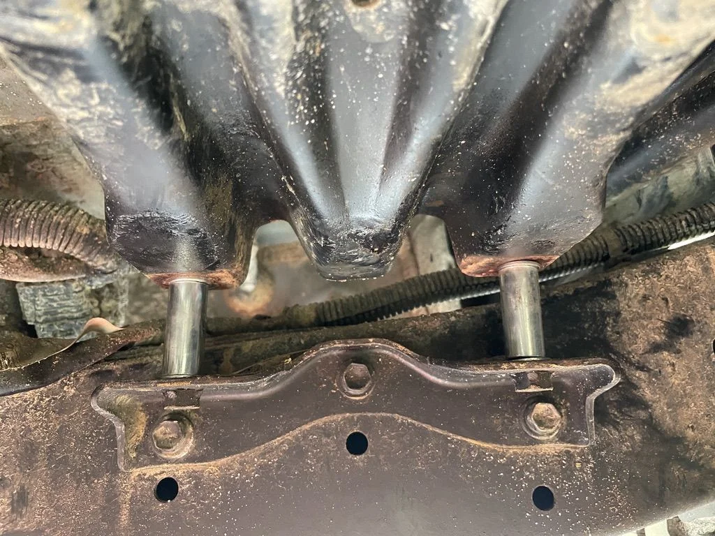

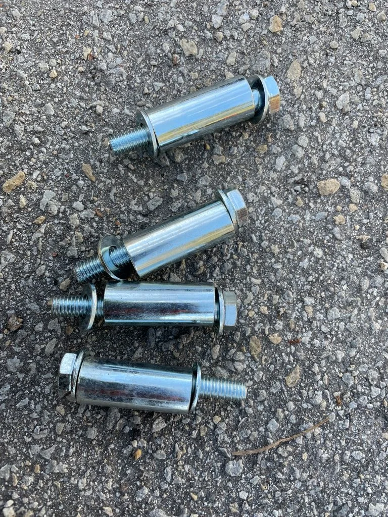

I did the spare tire mod on my 2006 Land Cruiser to fit my new full size spare 275/70R18. I ended up flipping the front bar, angling the back bar with 3/8" wedge spacers, and raised up the crossbar with the winch using longer bolts (M8 x 1.25 x 40mm) and ll washers on each side (5/16"). This worked perfectly. I made a quick YouTube video in case it helps anyone in the future:

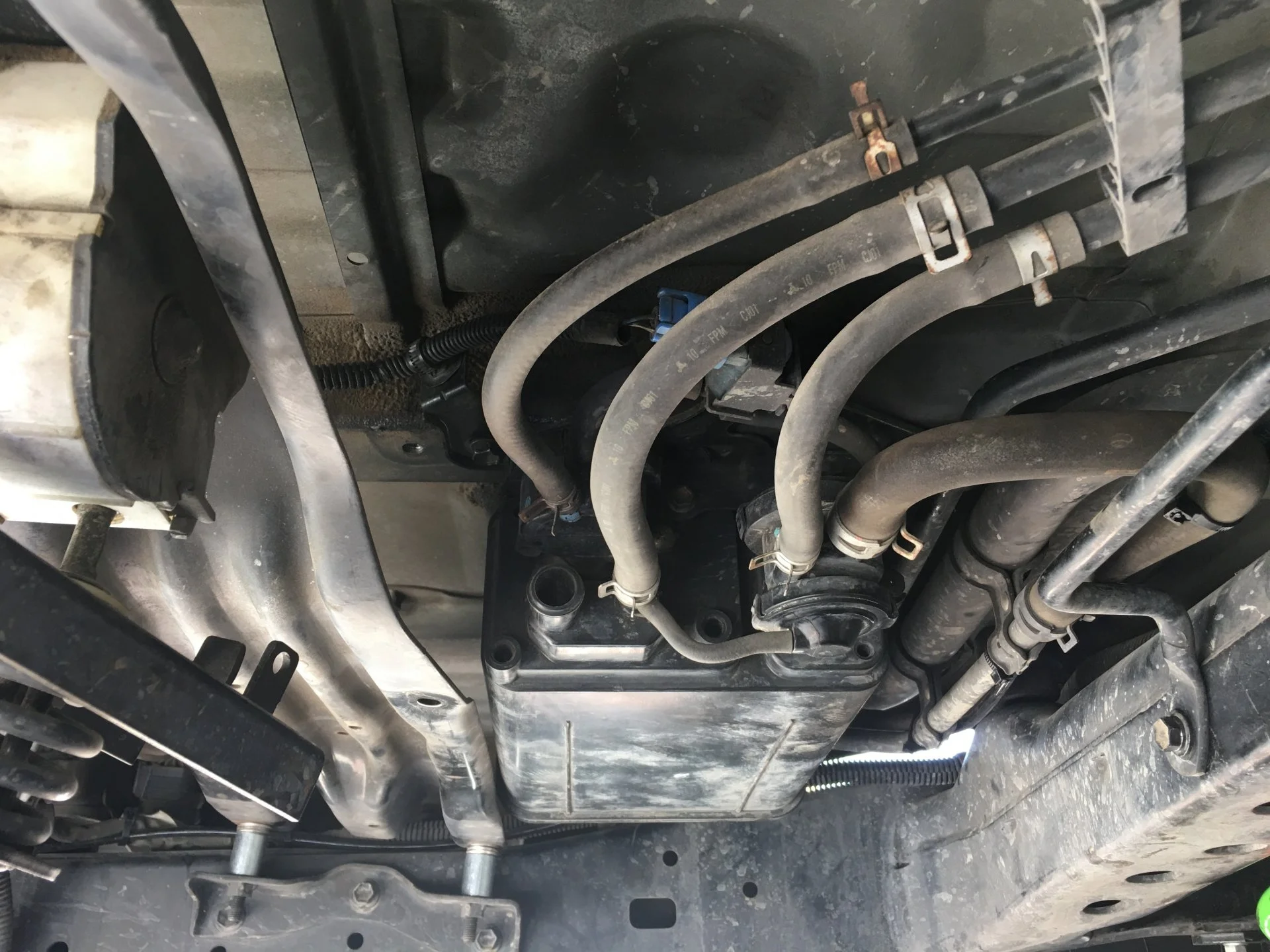

Thanks. I looked under mine and thought for sure the canister was in the way enough to make this mod not as impactful on later models. Not so. And the wedge spacer idea is clutch.
Did this with 1.5" prefabbed steel spacers and the usual extended bolts and washer shims. Worked great and netted me right about 1.5" of extra clearance in the back. 285/75/16 tire fits no problem still.

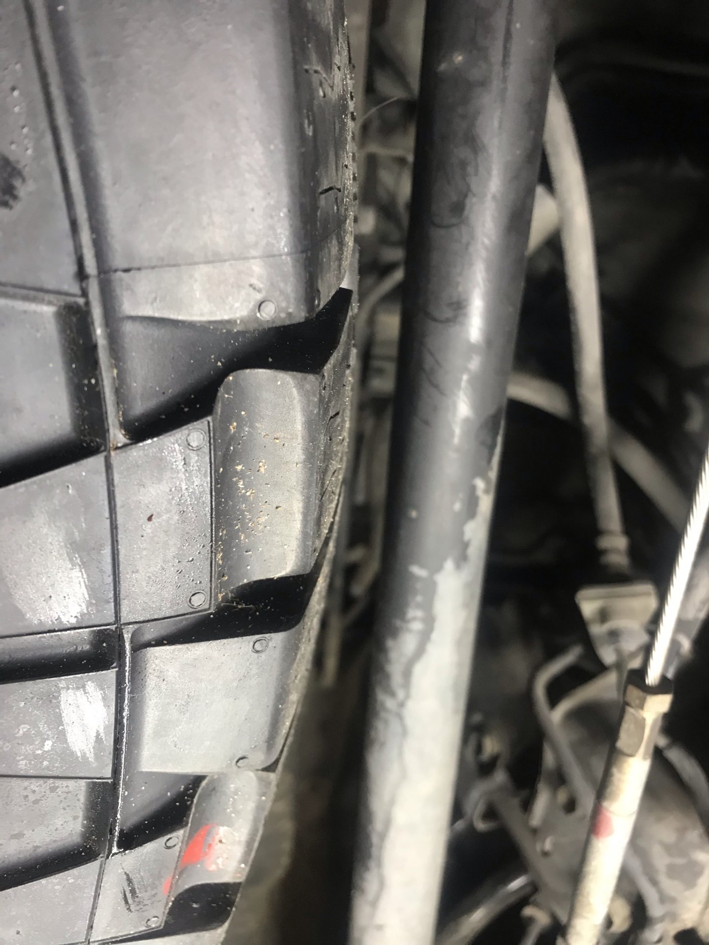

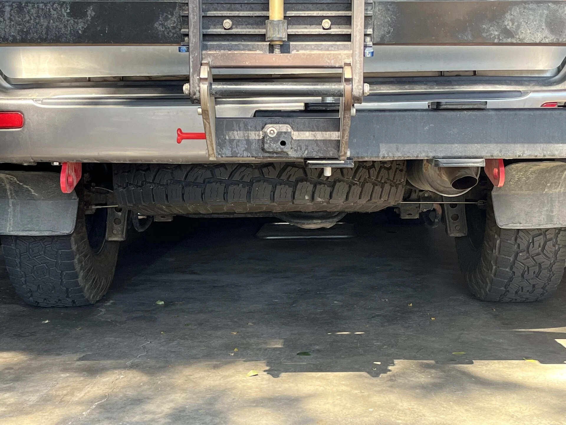

Has anyone had any luck using this mod to fit a 285/75/16 KO2 with a Curt aftermarket hitch? Installed the hitch today but the tire won't fit without serious rubbing. Might be the catalyst for a swingout mount on the bumper but that is overkill for my purposes. Appreciate any thoughts.

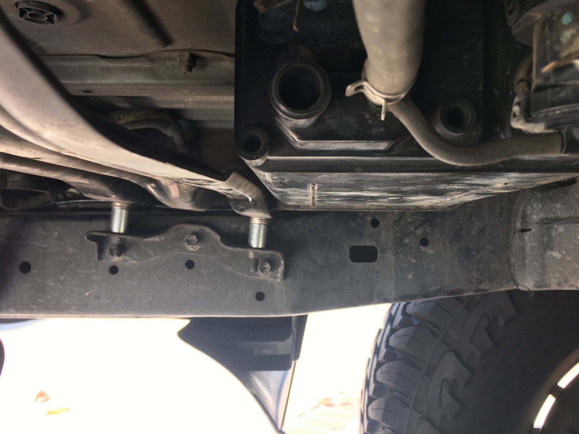

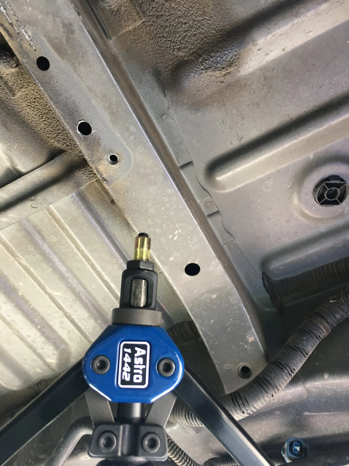

Interesting… on my ‘04, the canister was angled, and blocking the beam (tire winch)…
i was able to rotate it back straight and also clear the beam as well. Only took 1 hole drilled and 2 rivnuts to reposition the charcoal canister. The ‘06 in the vid looks like its already straight… maybe different canister?

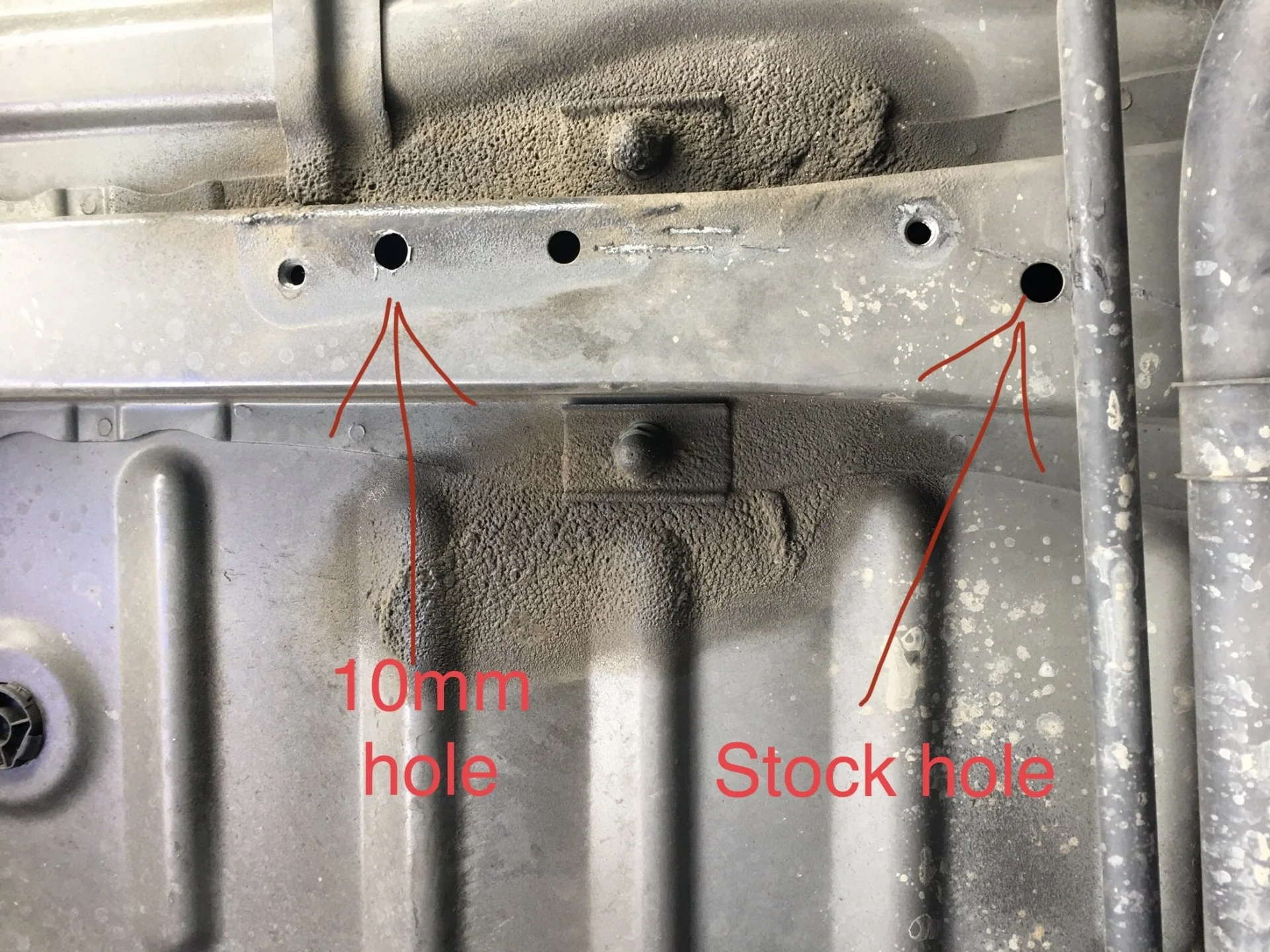

I had the same issue, I have the Cooper AT3’s and they are 33.5” …. What I ended up doing was taking the curt hitch off and drilling one more hole in the hitch itself to actually move the hitch back more. As far as structural integrity I didn’t get it certified by an engineer 😳😳 but there was certainly enough iron left on the hitch that I’ll never worry about it… I’ll see if I can dig out some pics of the holes drilled…
edit… just found the pics and apparently drilled 3 holes per side, I think I gained almost 1-1/2” overall and now have about 3/4” space at the pan hard. I’ve already towed quite a bit with it like this and it is solid.

Nice video. Where did you source those wedge spacers? They look perfect for the job.

will do, after doing a couple of hours of work and the very popular mod of adding spacers to increase the height of the carrier I made a couple inches of vertical space and almost 2 inches of horizontal space between the tire and panhard bar. as of now I know that a 34 would fit no problem with no rubbing, and 35's will be here very soon so I can get on the soon.

i was able to put the hitch on 1”spacers to lower it a bit and get it on, im not running it anymore because it was ugly, but you only really need to drop it by 1/2”. i hit plenty of rocks on the hitch and jacked the back up from it, so no strength issues

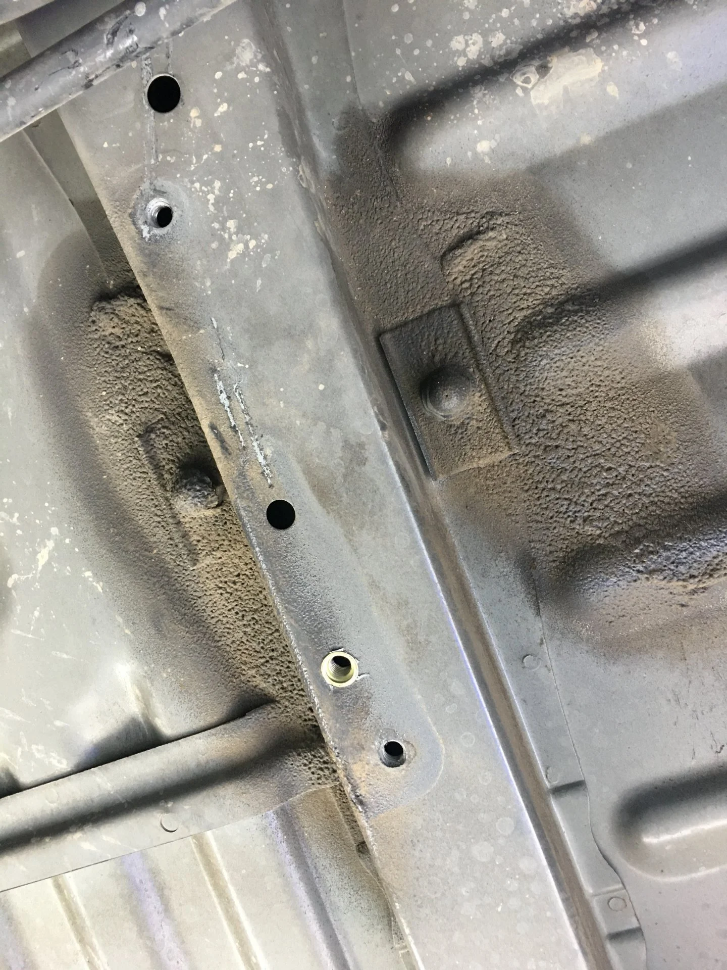

Finalized the spare raise this weekend. I removed the front and rear bars completely so the spare rests directly on the forward crossmember and the rear bumper step plate. With 20mm spacers in place the tire wasn’t quite high enough to make contact with the forward crossmember and therefore wasn’t solidly mounted. I exchanged those for 1 1/4” spacers (≈32mm) and now the tire rests firmly against the forward crossmember. I also lowered the winch with some 1/2” spacers.
I discovered that it is pointless (and actually worse) to raise the spare higher than 1 1/4”. You can raise the spare crossmember higher but the forward crossmember and the rear step plate are your limiting factors. Raising the spare crossmember higher than 1 1/4" will decrease the contact area the tire has, it will only rest against the front & rear and the spare crossmember will essentially float above the tire.

never got back on this thread, i was able to have the 35x12.5x17 km3 and had it like that untill we got a rear bumper. it did rub on the panhard bar a little and i had to relocate the evap cannister but it worked fabulous.
