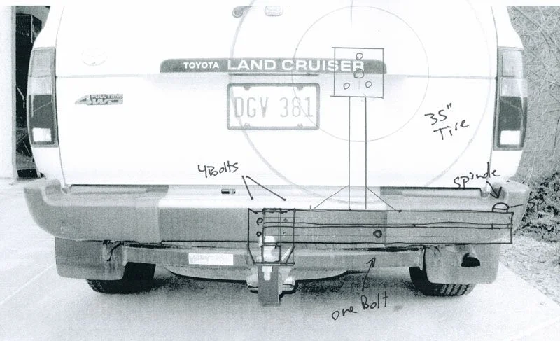

Those are great references, but I was thinking of something more along the lines of this. Bolt to bumper only, not welded on arm, not hidden. Removable / Resell-able if I decide to get a bumper later.
I figure the only actual vehicle mod would be drilling an additional hole in the bumper for additional mounting support.

Take a look at some of the Hummer H2's or H3's. They have a bolt on swingout as an option. Those may give you some good ideas. They seem fairly similar to your sketch from what I recall.

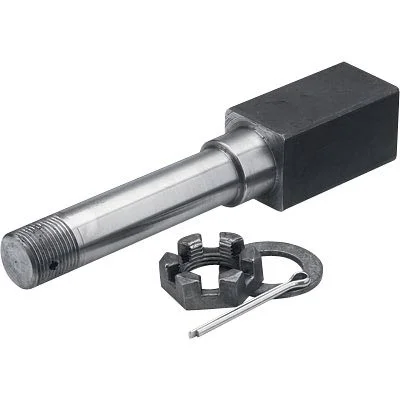

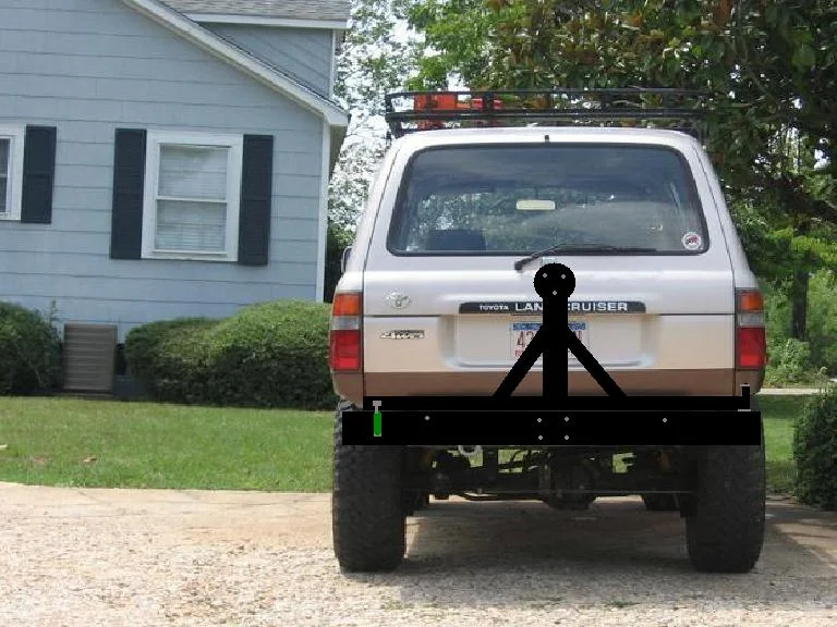

Funny you bring this up. I drew something up on paint a little while back with the same concept. I planned on using some steel 2x4's and 2x2's. I also found some end caps that I found would work well in my design. I also had some crazy ideas of using a steerer tube from an old MTB fork I had lying around with a MTB headset as the spindle until I found one of these axle spindles from Northern Tool for $15....
Buy at Fit-Senior.Com Plastic End Caps, Finishing Caps, and Inserts For Tube Steel
Here is what I had in mind. Hope Land Speeder doesn't mind me getting creative with his rig!

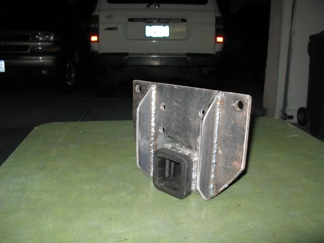

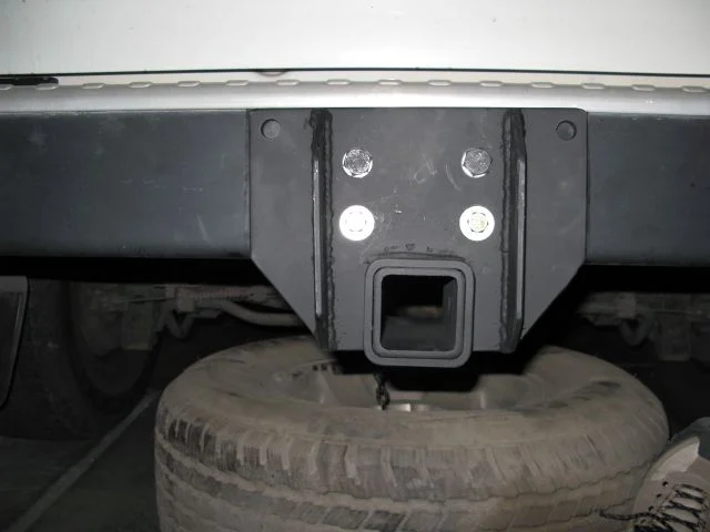

Update - Hitch Portion Finished

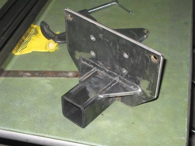

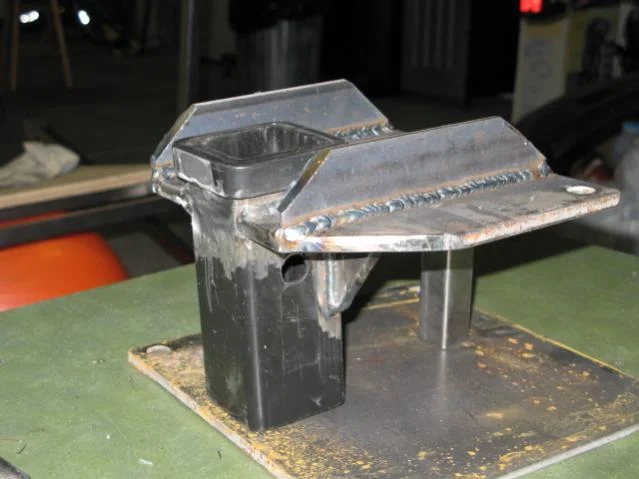

I got the first stage of the bolt on done. This comprises the 3/8 plate and the new hitch now that the factory Valley hitch is removed. The main plate and the rear reinforcement is 3/8 plate, holding a 6" receiver. Cut from a 10" square.
Con't
Primary assembly:
Con't
Then I realized that although the 3/8" plate is strong, I should have some vertical reinforcement, so I cut some 1/4" plate.
Con't
Mounted to truck with Grade 8 hardware.
Top two bolts are 12mm Extra Fine Thread metrics. (Regular fine thread not fine enought...:o) I had to go to probably 6 places in Las Vegas to find this.
The bottom bolts are 3/8 SAE, because the bottom holes are not threaded.
This assembly will act as the primary mounting point for the tire swingout - I just received the spindle hinge, hope to start fabbing the swingout in the next couple of weeks.
Forgot to add, 1/16" rubber gasket material between plate and bumper to keep wear to a minimum. 10"x 4" piece.

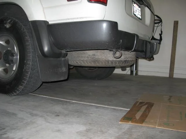

Last pic shows hitch clearance with spare tire mod raising spare 2", until I finish the swingout.

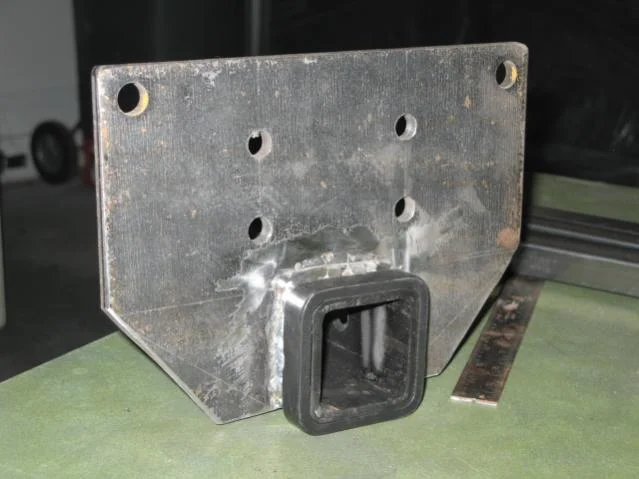

Any pics of the backside?
Hope the swing out works the way its planned. Keep me updated cause I also want a swing out and money is an issue.
Great project, it looks awesome!

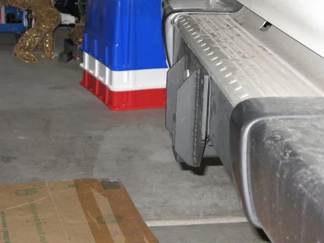

Yeah, don't know if you mean from the back of the truck, or the back of the hitch assembly, so here:
