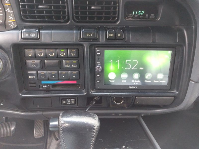

I just put one of these decks in my Landcruiser. My main reason for choosing this one was the low key, oem looking appearance and the rotary volume knob. Still have to wire in the camera I got for it. But it looks great in the dash. Turns out its a pretty popular one to have on here.

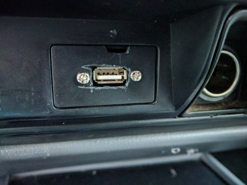

No, not quite that easy. You’ll have to cut a rectangle in one of the switch blanks and then snap it in. The finished result is a bit cleaner as the lip covers the cut
Thanks, just ordered one. Hoping it'll clean up my USB plug-in a bit.

I picked up a circular replacement USB connector from amazon - and removed the 12v lighter socket and installed the USB 3 socket there.
It looks factory - or close to it for a super clean install using the adapter harness.
I've got some sockets for console mounted 12V USB points to fit into the center console coin holder slots for additional charge points.

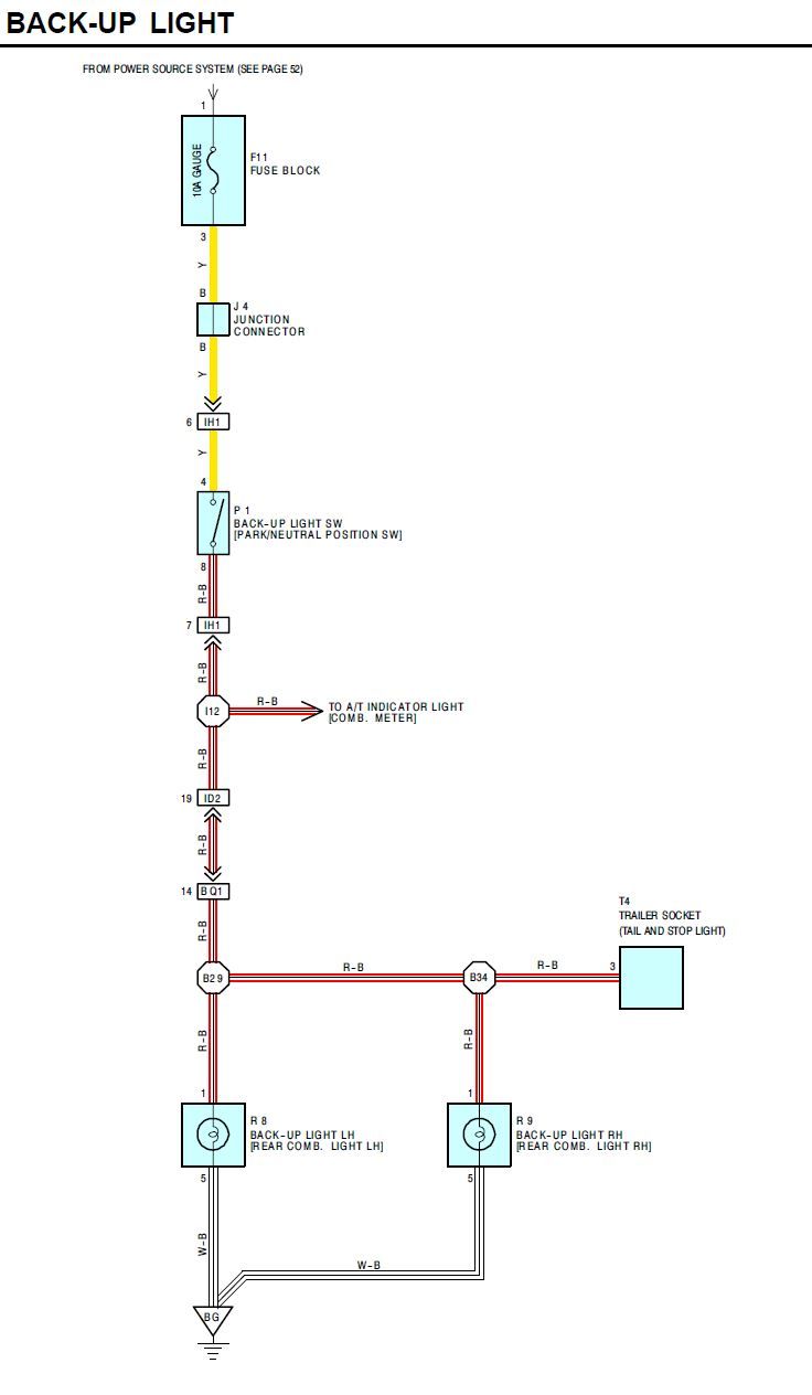

I think the reverse signal can be picked up from the shifter - I'd need to dig out the EWD to review that. My camera has a built in signal wire that runs with the video signal so I'll just pick it up from the reverse lights in the tail.

Edit : Reverse light circuit - looks like you can pick it up on the shifter on the backup light switch P1 on the EWD.

Lately, I've been on track to modernize the Cruiser a bit. I've owned it for over 10 years now, and aside from getting t-boned, I don't plan on getting rid of it anytime soon. And Thanksgiving was a pretty good time for deals this year.
I ended up snatching a Viper 5806v security and remote start system for $139. Called around to a couple local shops and had one install it for $315. I didn't want some high schooler from Best Buy tearing up the wiring harness. But that's not what this thread is about.
Was able to snatch a Sony XAV-AX100(http://a.co/1pVc8wd) stereo on an Amazon warehouse deal for $297. Then grabbed an Esky 170 degree backup camera(http://a.co/c4EQQTb) in a license plate frame for $26.

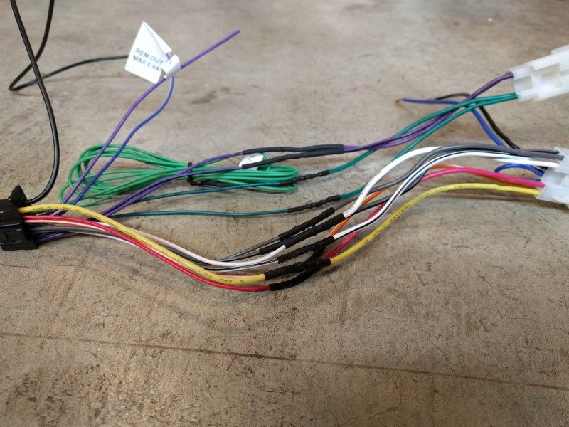

Using the Metra 70-1761 harness was a snap. It automatically bypasses the factory amp. I soldered and shrink wrapped the wires. On the Sony, I also ended up grounding the parking brake wire to the ground wire.

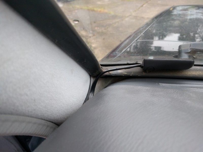

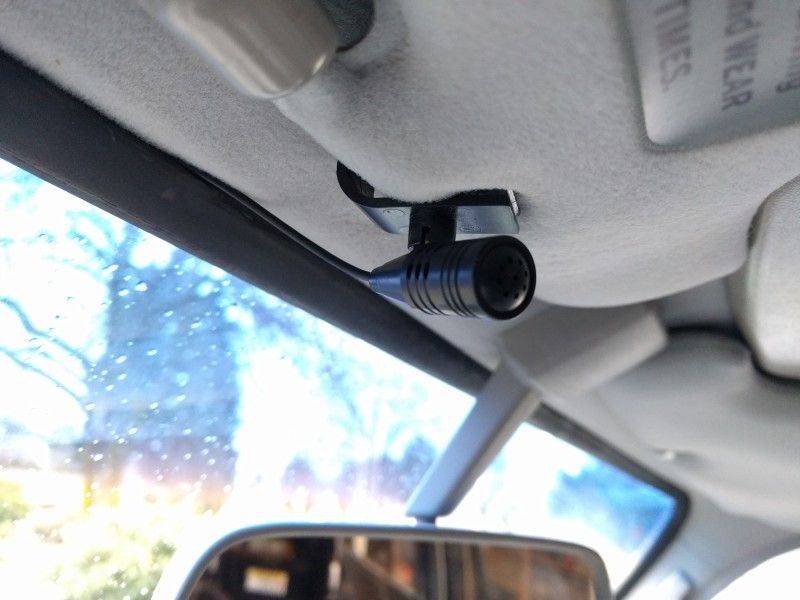

I ran the microphone wire up and around the driver side footwell, then up the a-pillar to the visor. All while tucking the wire into the windshield gasket. Worked great for concealing the wire.

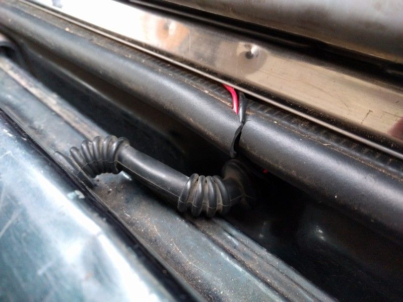

I then ran the video wire in a similar fashion, but then took it all along the driver side floor area. Neatly tucking it under the plastic snap pieces and back through the rear tire jack storage area. Then along under the back carpet cover trim piece until I dropped it down to the tailgate wire run and back to the license plate frame.

The ugliest part of this job was probably my USB mount. My dremel was making a mess of the little plastic piece next to the cigarette lighter. But it works.
