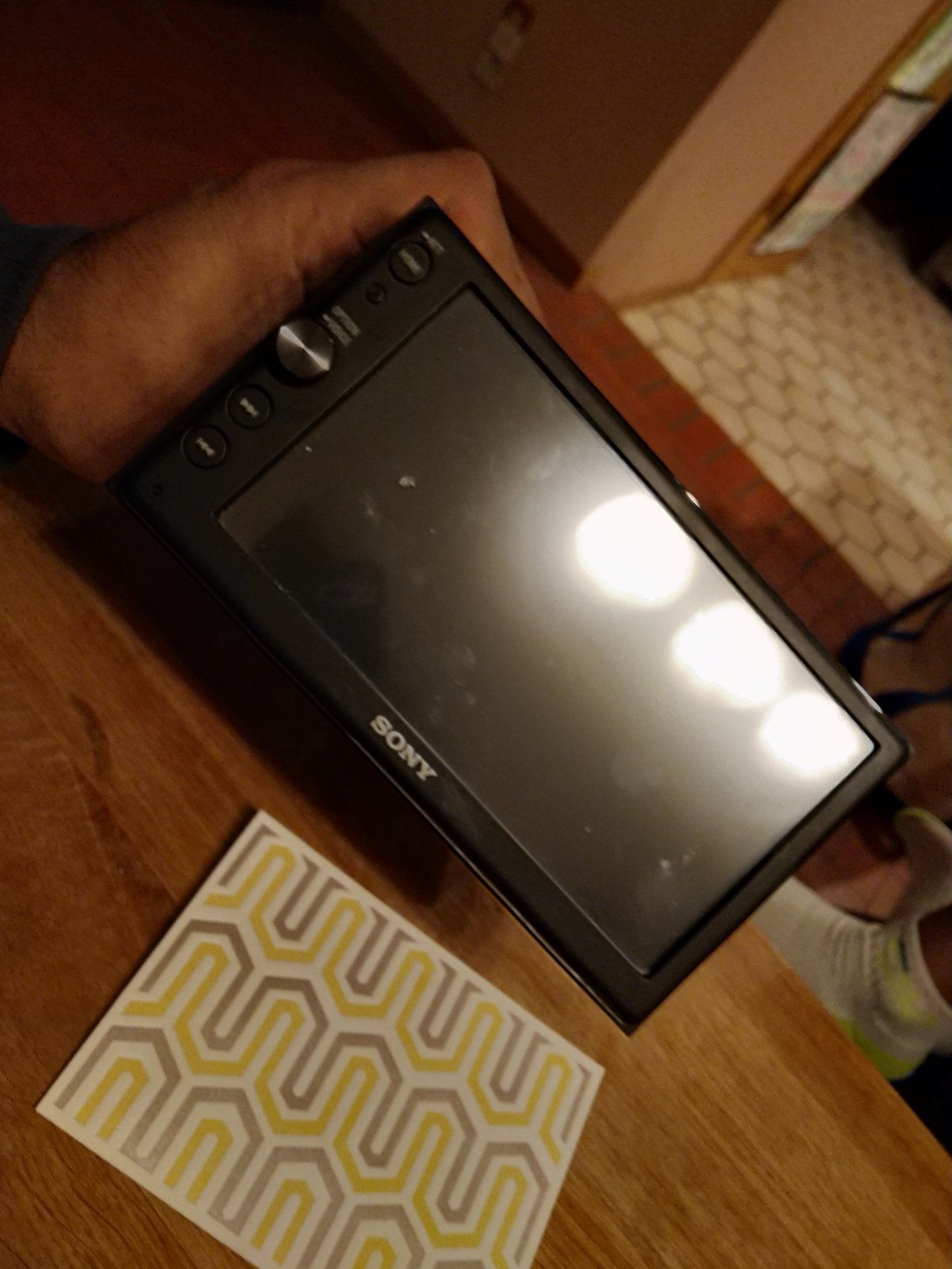

Here's what I bought. I don't see an USB port but there's an USB cord in the package.

I have the one with the USB slot under the volume knob. It's capable of connecting via bluetooth, but just not capable of Apple CarPlay via bluetooth. It functions via bluetooth wonderfully for both music and calls, but you just don't get the fancy CarPlay interface unless you plug in via USB.
Ahhh okay I was confused I’ve never used apple car play before and wasn’t exactly sure how it works. My buddy has a head unit where his phone is detected right away as soon as he hops in the car and will play the music from his iphone so that’s all I really cared about. I guess I don’t mind hooking up my phone to access maps and all those other apps.
Wireless carplay actually uses both bluetooth and a local WiFi hotspot created by the head unit. The intial connection uses bluetooth but video/audio/data is transmitted over WiFi. Only a few high-end aftermarket units support wireless carplay (Pioneer and Alpine) although I’m sure more will be coming out soon.

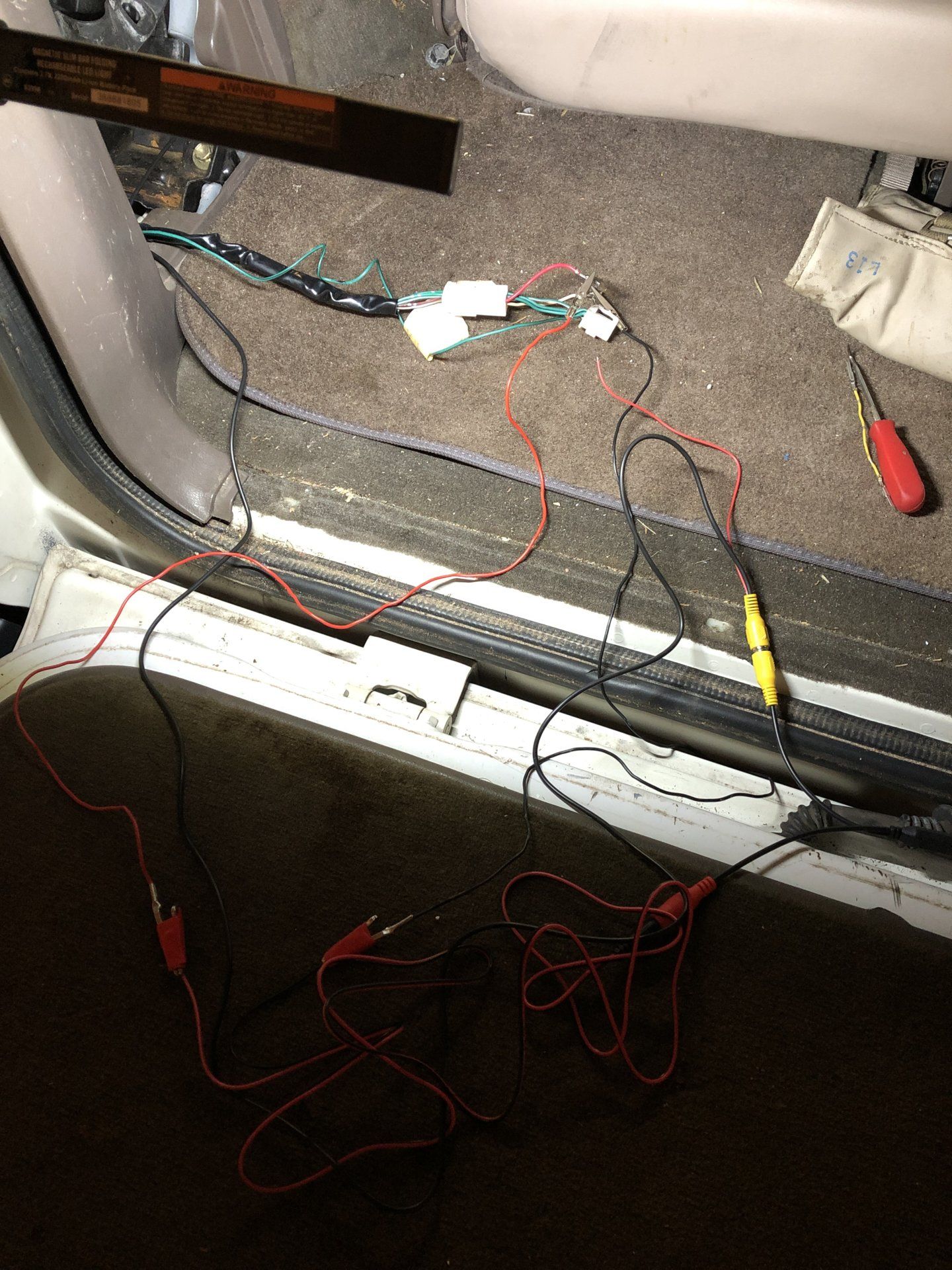

This was the hardest part - Thanks to OP, I was able to figure out the right wires, but his 80 is older than mine. So I had an extra short adapter in the middle. Off that short "adapter" ran a green black wire that went under the carpet across to the RH side of the rear end. Don't know what it was for...didn't care. The adapter changed the wire colors to RED and WHITE for the reverse light power and ground. Red HOT, White GROUND. I popped them out with a shiv and tested before I did ANYTHING.
Once I knew I had the right wires, I started the process of actually feeding the wires through.

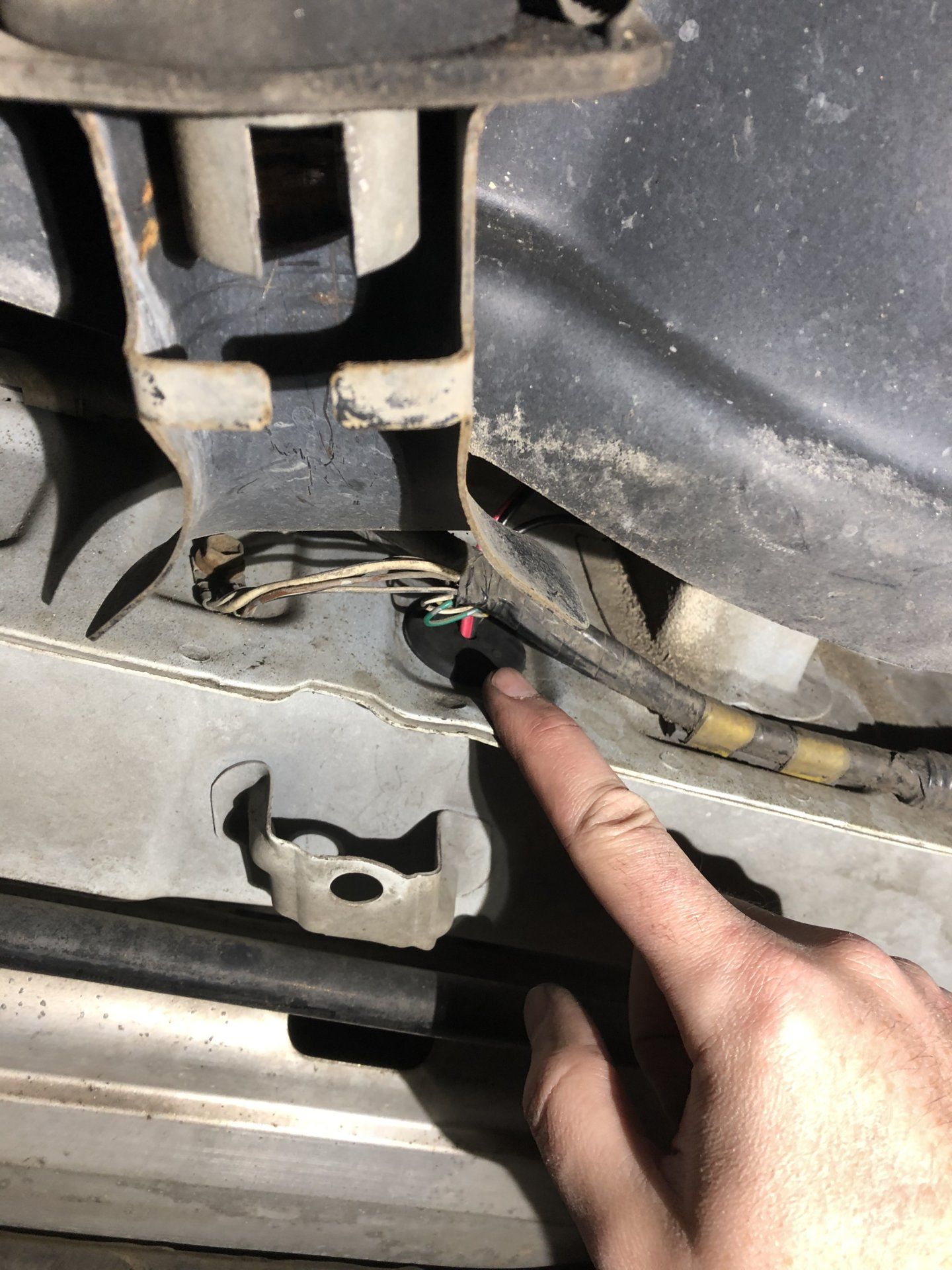

Underneath the JACK in the LH rear panel I saw there was a grommet with a drain. I was able to coerce it out and run my wires through it without too much issue. I recommend lowering the spare tire and getting it out of the way for the rest of my images.

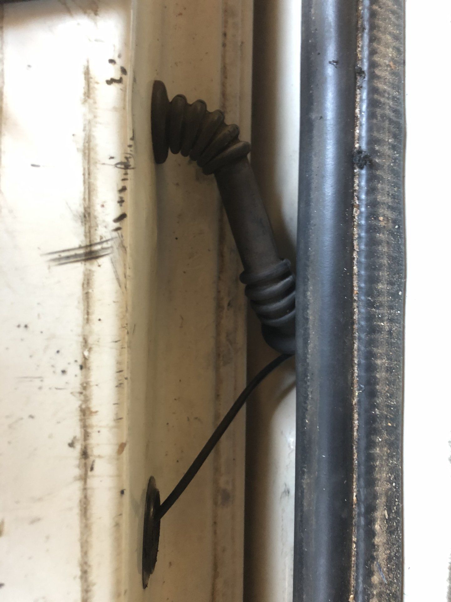

I found another grommet that keeps the wires that go to the license plate lights and the "snorkel" that connects to the tail gate. Mine was SPLIT from the center hole on one side. I made it bigger in the center to accommodate the extra wires I was going to push through it. Then I put some lube on it (Spit) and worked it back into place. You'll only see this with the spare out of the way.
I got shy trying to push the fat head of the RCA cable through that little rubber snorkel. There is a plastic plug to the right of it, I hollowed out the middle and plan to go back with some silicon to seal it back up. I actually don't imagine it causes any harm to be left with a gaping hole...but I wanna isolate the wire better. I wasn't excited about this solution, but I also didn't want to cut the weatherstripping.

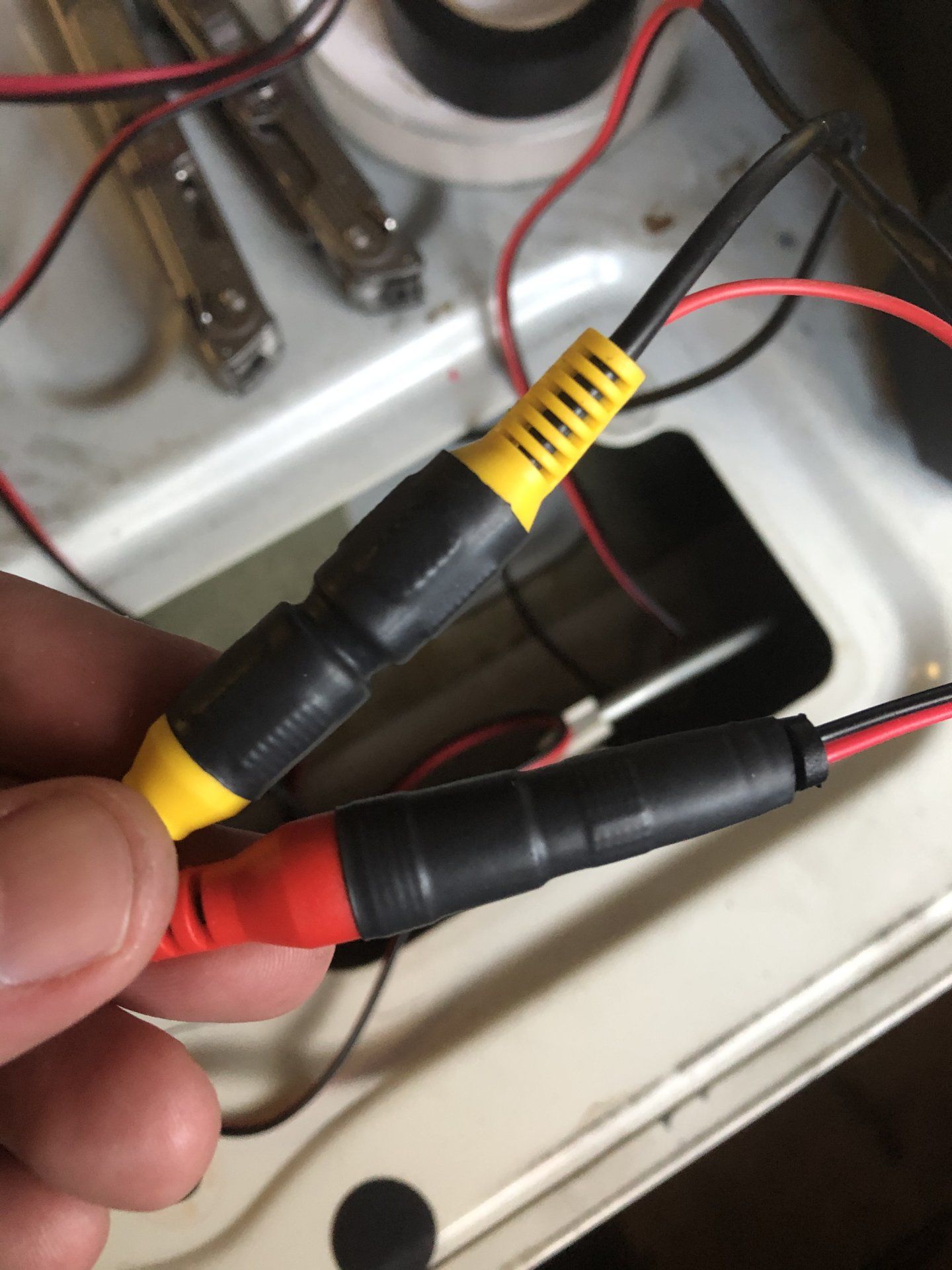

When I decided to do the splices needed for powering the camera, I decided to do what I believe @LINUS suggested. I popped out the pin, stripped away some of the jacket. Soldered on the new wire, coated it with some dielectric and heat shrink-ed it down.
I then went one more step to ensure these plugs don't get moisture in them or vibrate loose. I found some heat shrink that fit over and sealed them up.

Not pictured - The camera wire had a trigger wire chaser that I soldered to the metra adapter harness that OP posted. Then I ran it down the LH side of the truck in the cable chase. When I got the rear wheel well I pushed it gently under the rear panel and then pulled it over the filler nozzle, then down below/behind the jack. The whole time I did this I kept thinking "Will this be in the way in the future?" I soldered the other end of that red wire chaser to the positive power side of the reverse light power that came into the tailgate. This meant that I was soldering 3 wires together for positive and two for negative (ground). You could likely just ground the negatives, but for some reason that didn't make my camera trigger right.
I also ended up buying a spool of "Speaker" style wire to pull from the LH rear through. What came with the camera was too short and very thin (20 guage?) I was worried it would shear off while pulling on it.
I also found that the backup camera was sensitive to polarity. My vision didn't notice that I had soldered a RED/BLACK trace to a RED wire. That was a real head scratcher for a moment.
