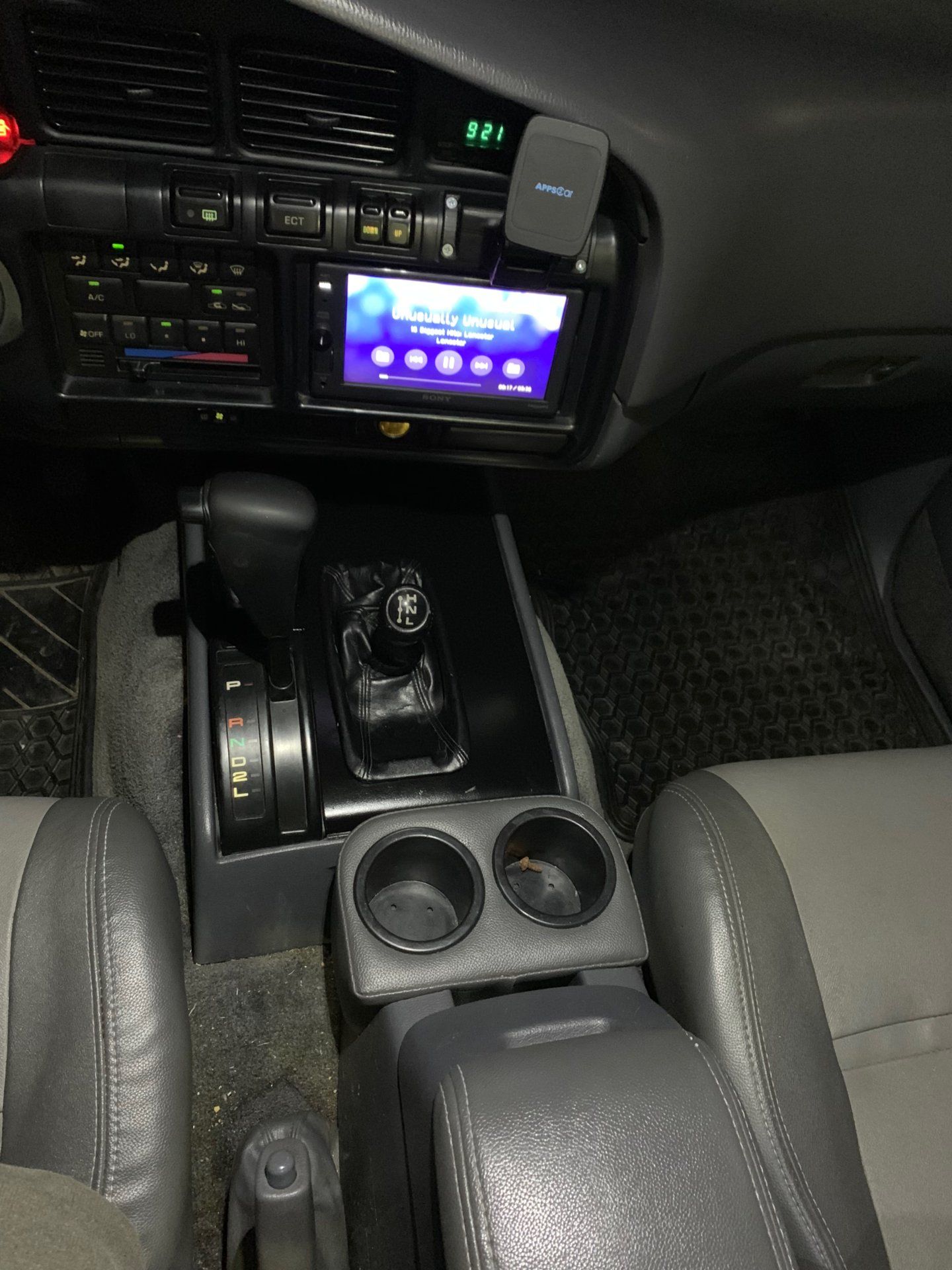

Having just gotten the Sony installed last month, I must say I really, really appreciate the volume dial. I don't need much in terms of features, so this wasn't much of a struggle for me, but do heavily consider how much you will use those other features versus the daily/constant use of the volume controls. I love being able to rest my wrist on the shifter and adjust the dial.

Sorry to hikack, but what do you have attached to the BHicks dash phone mount. That doesn’t look like what came with mine. Mine was a clamp style.
The ball and socket connection used between the dash mount and the phone holder was a relatively standard size (about 5/8”), so I was able to swap the clamp-style holder for the magnet I already had. I much prefer the minimalist look and functionality of it.
