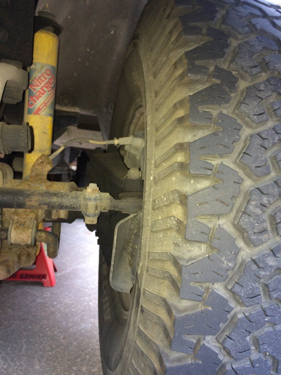

The 62 (not sure about 60s) disc backing plates also have air scoops in them to funnel air flow to the discs. Obviously only works when moving.
