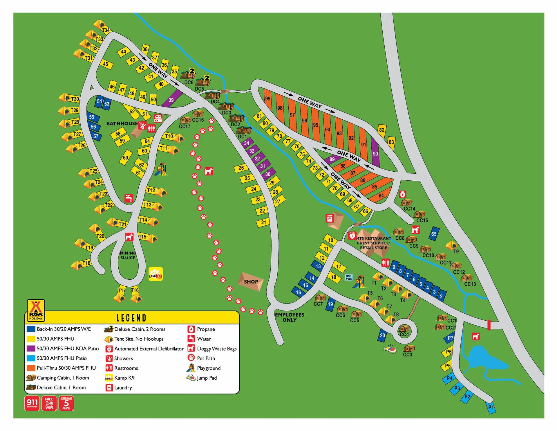

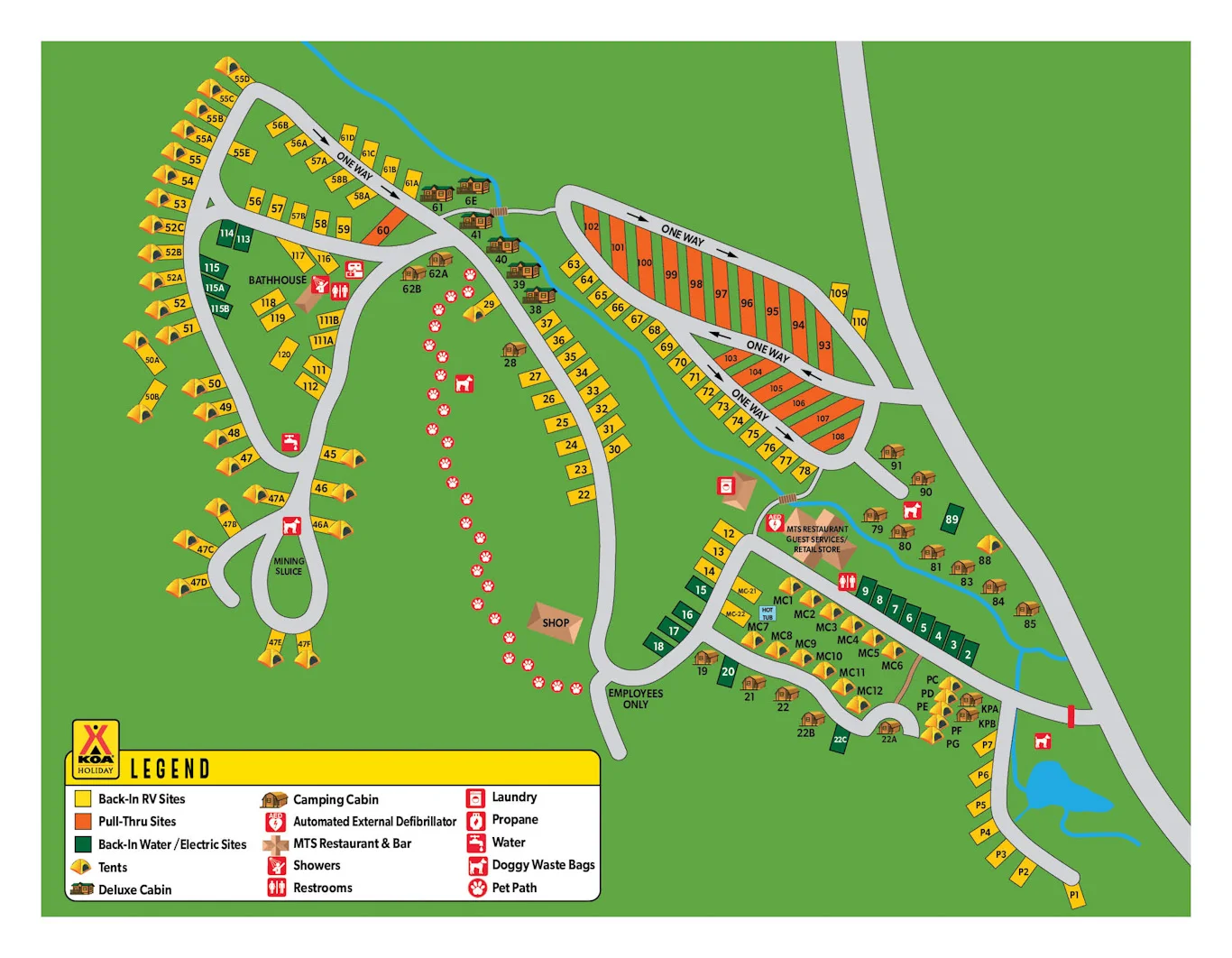

Just an FYI - Looks like the site numbers for KOA have been switched up since last year. (New on top) I also see a new playground and a blob, which the kids loved at a KOA we stayed at in Michigan earlier in the year. They declared that place was the best campground ever because of the blob. Sounds like Ouray KOA is stepping it up! View attachment 3385574View attachment 3385575
