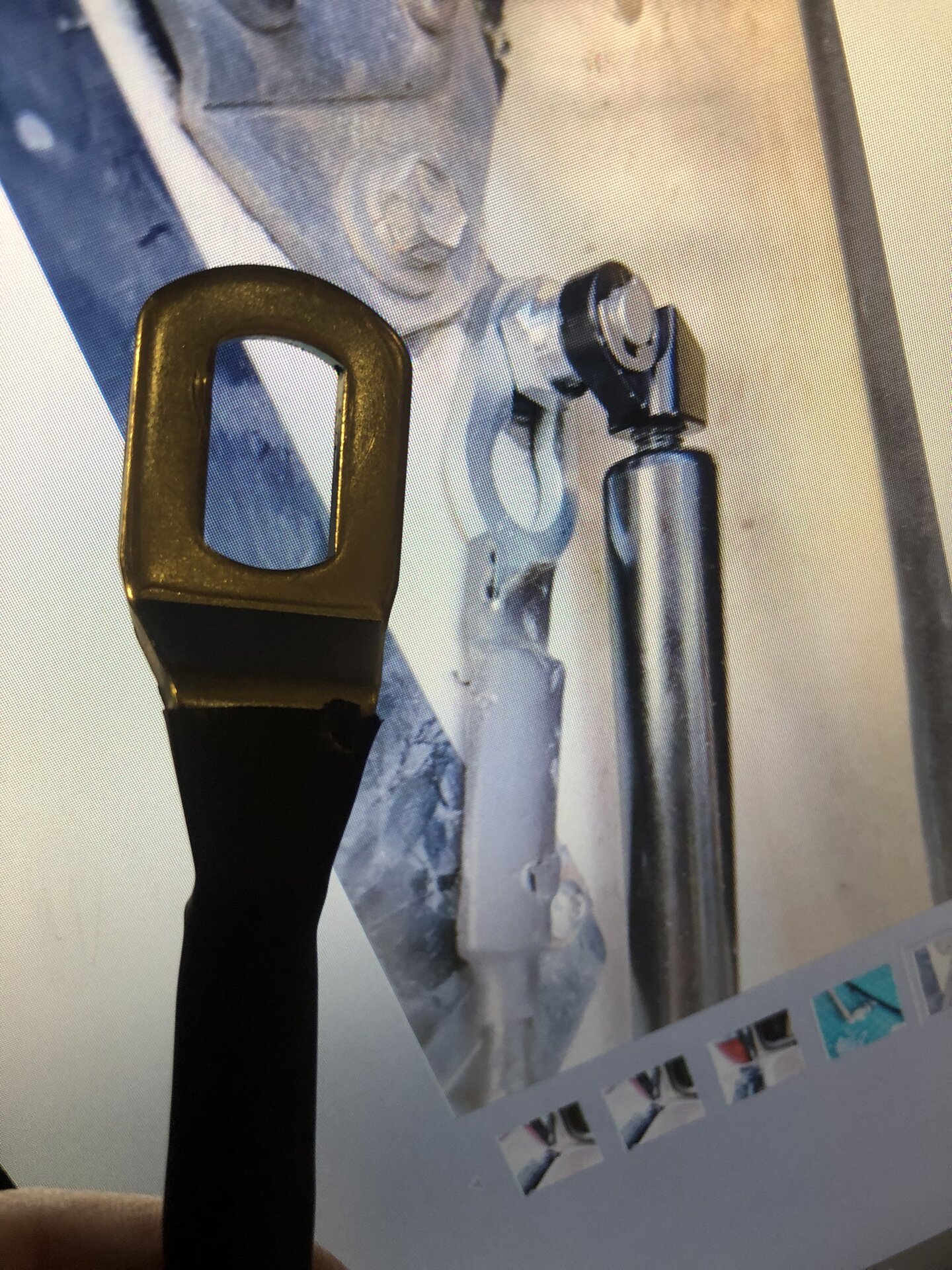

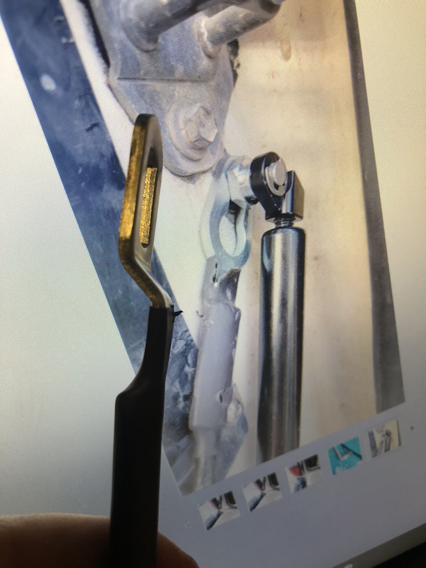

Please confirm the Correct Cable was sent?
This has a 1/4" Offset unlike the one in Picture which is Flat.
One in Picture has a Keyhole Slot this is a Straight Slot.

I got the kit and installed. The new cable binds up and does not fold in well. Not sure if I did something wrong but here are a few photos.
Got my kit in the mail. Doing the install now. It has the new cable. Not sure how that is supposed to work with the custom machined stud. The old style had a reduced width at one end. The new one does not, it is a full width slotted opening. The custom machined stud floats in there like a hot dog in a hallway. Also, because it is full width to the end, the outer dimensions on that end of the cable are wider and it binds up on the "U" latch bracket that is attached to the body of the LC. Can you post up instructions on this new cable?
there is no way for that cable to fold nice because of the clearance between tail light and shock
plus that bolt on tailgate must be 90 degree to shock otherwise it will eventually brake of
also the existing hole on tailgate is to high , new hole must be drilled in order for tailgate to close without forcing it
