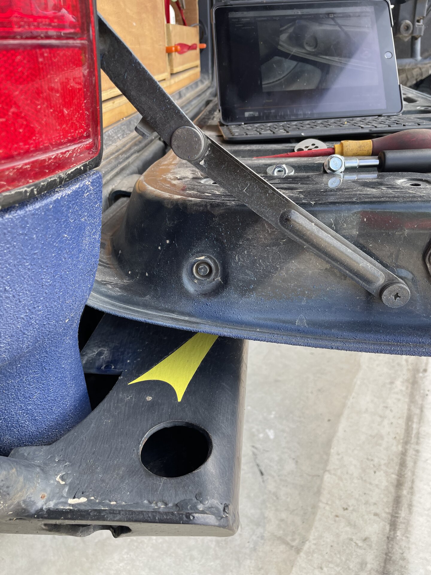

Sorted it out. There is enough metal to drill the hole in the correct place.
Drilled a hole in the Template washer and used a 6mm Rivnut and a suitable bolt to make sure that things will be rock solid. More pictures to come. Works really good and isn’t too slow.

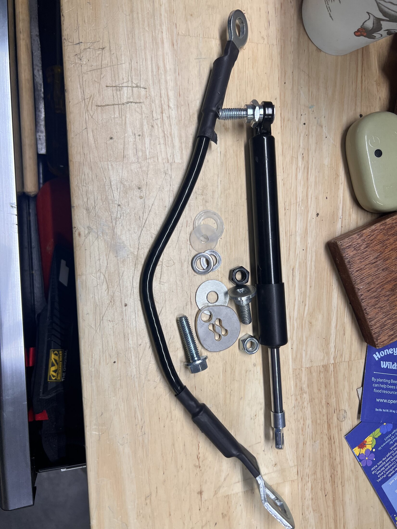

Tried to install this, messed about for a few hours but never found a setup that allowed the cable to pass between the strut and body/taillight screw. The cable seems overly large for the loads or the top screw is too short to space the strut far enough out from the body.
Anyone want what is left? I'm over it...send coffee $ to cover the postage before it goes in the trash. EDIT: Gone, good luck with it. pending shipment to its new home.
