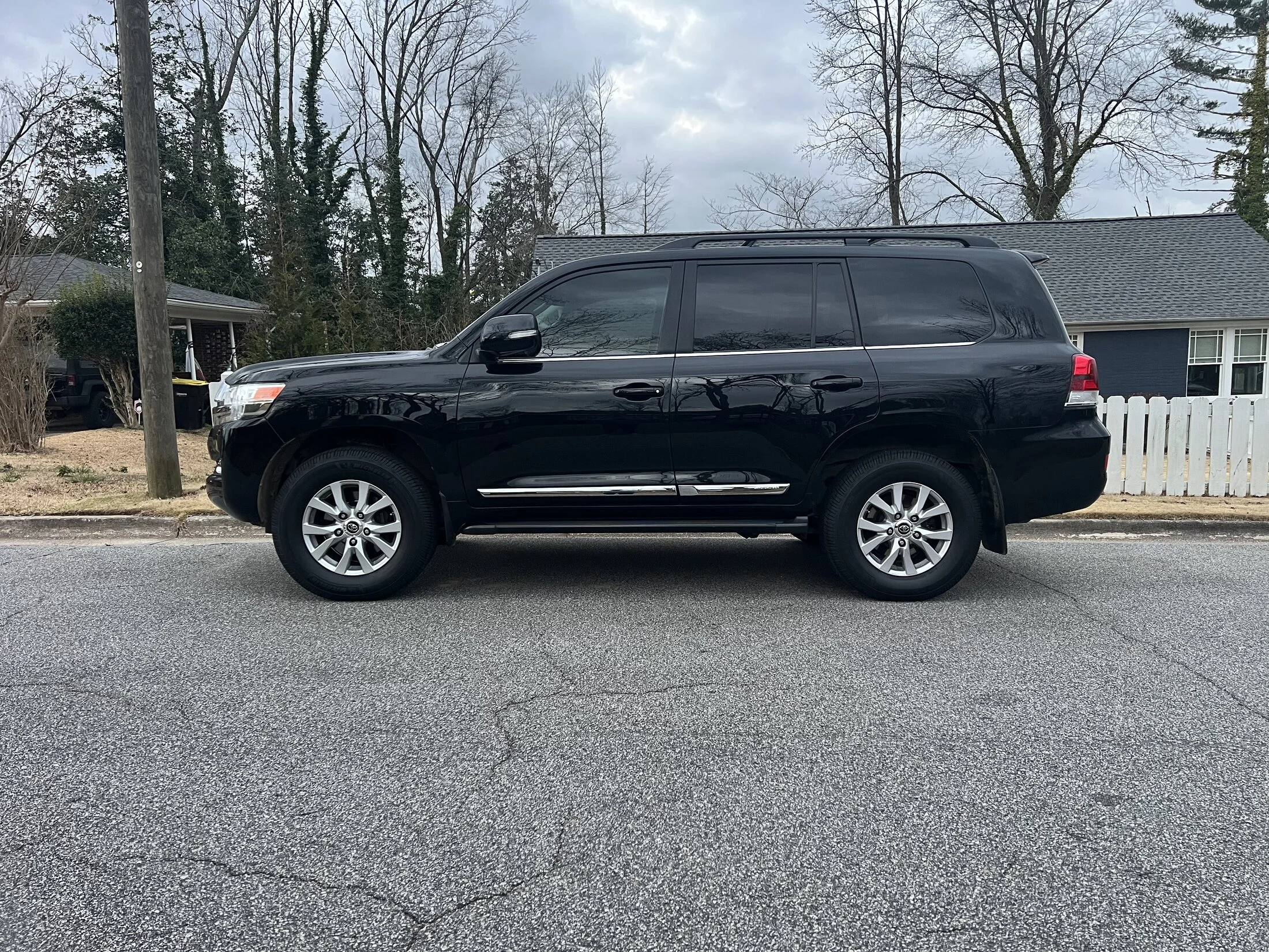

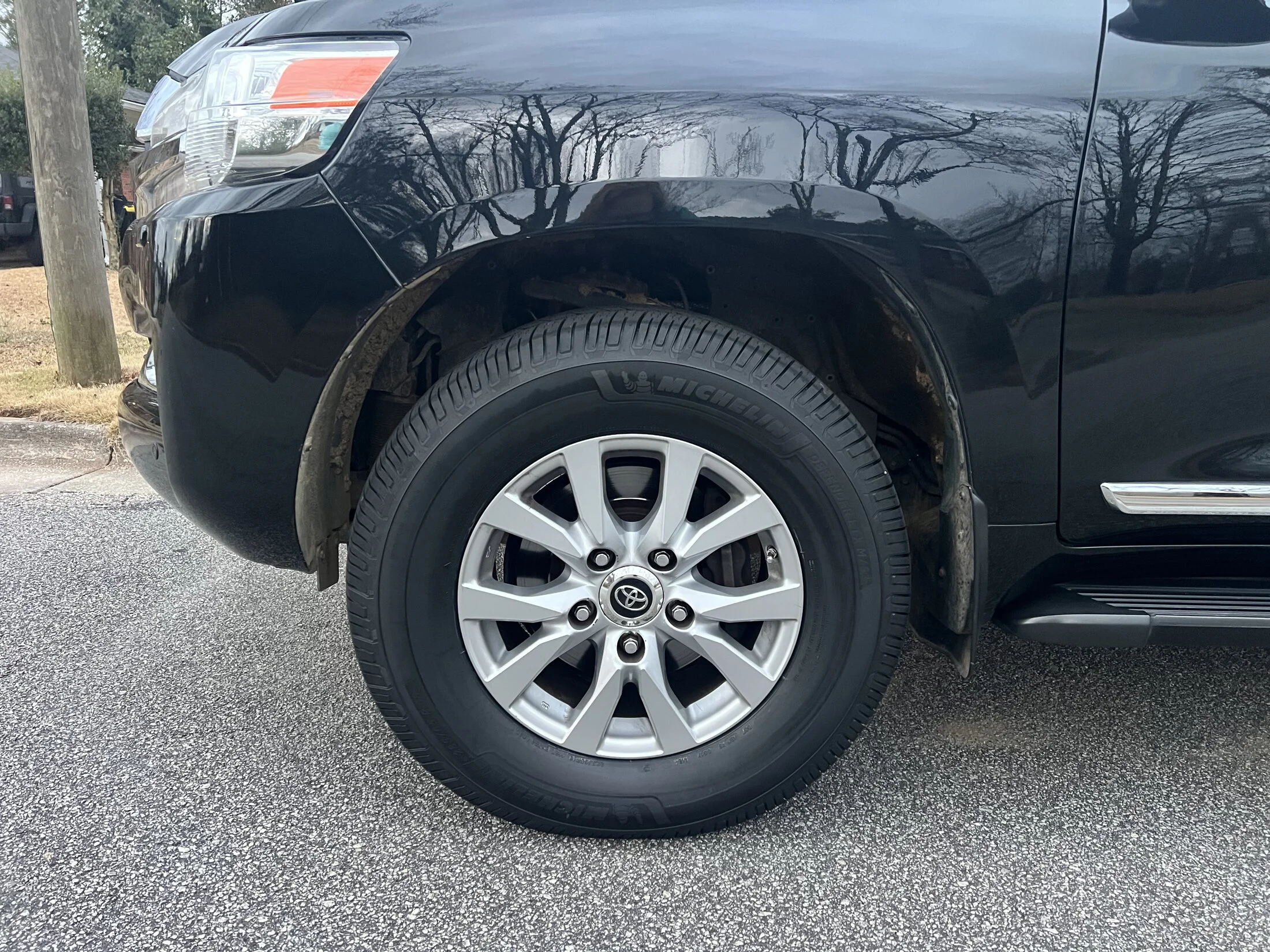

Brand new set of Michelin Defender LTX M/S2 in 285/65R18 (XL). This should have been the stock size on the 200. Note: my LC200 has the Toyota OE front spacer and a 15mm rear coil spacer.

Nice new rubber! Where did you get the rear spacer? What’s your measurement from the hub to the top of the wheel arch? TIA

Rear spacers came from Cruiser Teq.
Measurements from hub centerline to wheel arch, with Toyota OE front spacers and 15mm rear spacers, unloaded, with third row seats in, are as follows:
Left Front and Right Front: 20 1/2"
Left Rear and Right Rear: 21 1/2"
I hope this helps!
