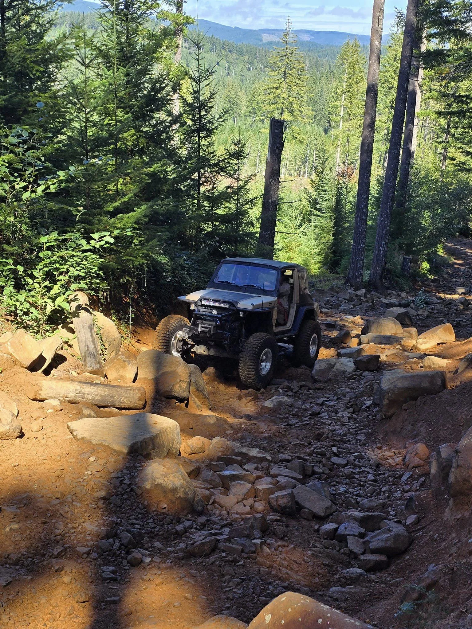

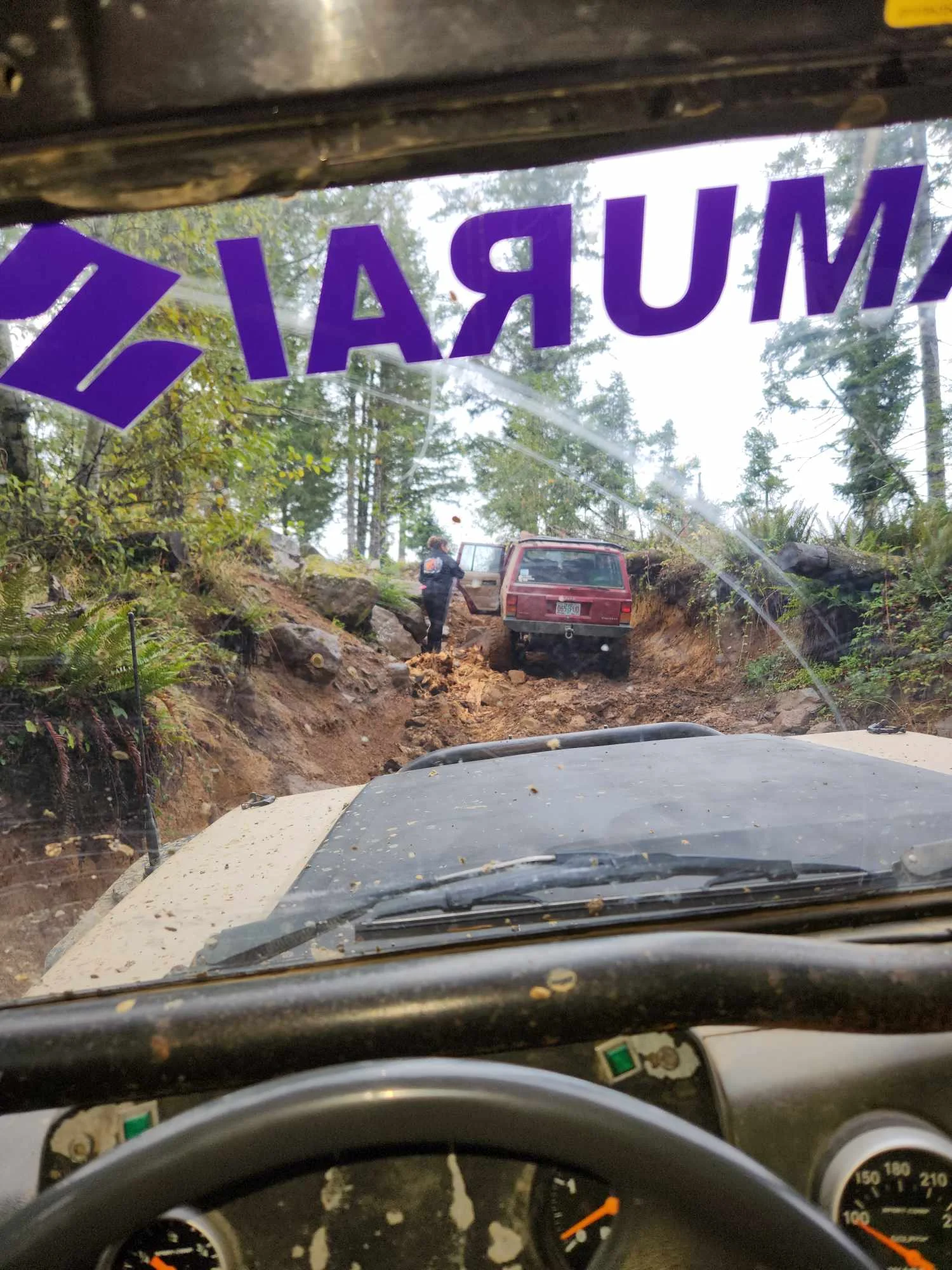

Last weekend was another local 4x4 club's poker run. I was able to take my 5 yr old son with me. This is the first time that he has ridden in Snuggs and he had a blast! Everything worked great and it was super challenging this year. Everything was slimy... I didn't get too many pics though, I was busy enjoying the moment.

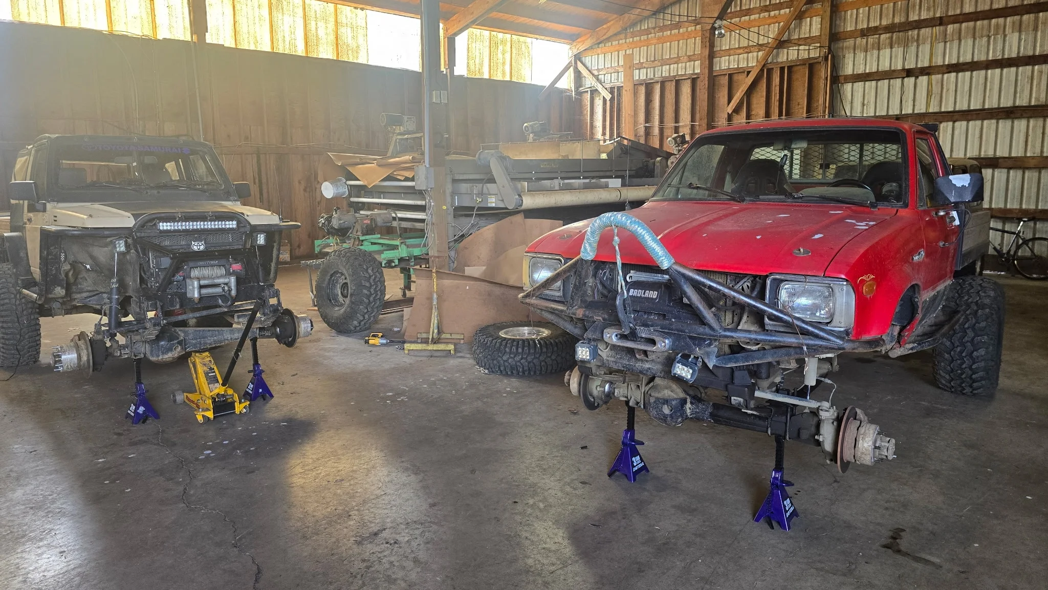

Not much has happened with the Sami... I ended up moving this spring, which took a lot of my free time. This summer was chock full of different trips and kid stuff. However, I did end up buying an '83 Toyota Pickup from a buddy. I have decided to swap some parts between it and Snuggs. Unfortunately, I can't keep both, so the Sami will be up for sale soon. If anyone is interested in the Pickup, here is a link to the build thread: Builds - 'Ol Red - 1983 Pickup RN38L - https://forum.ih8mud.com/threads/ol-red-1983-pickup-rn38l.1368049/

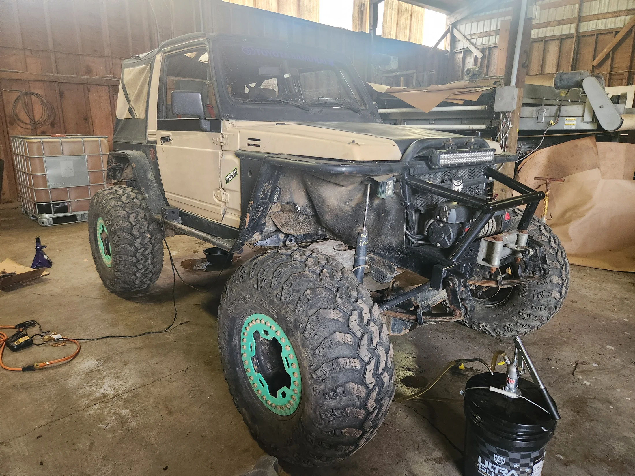

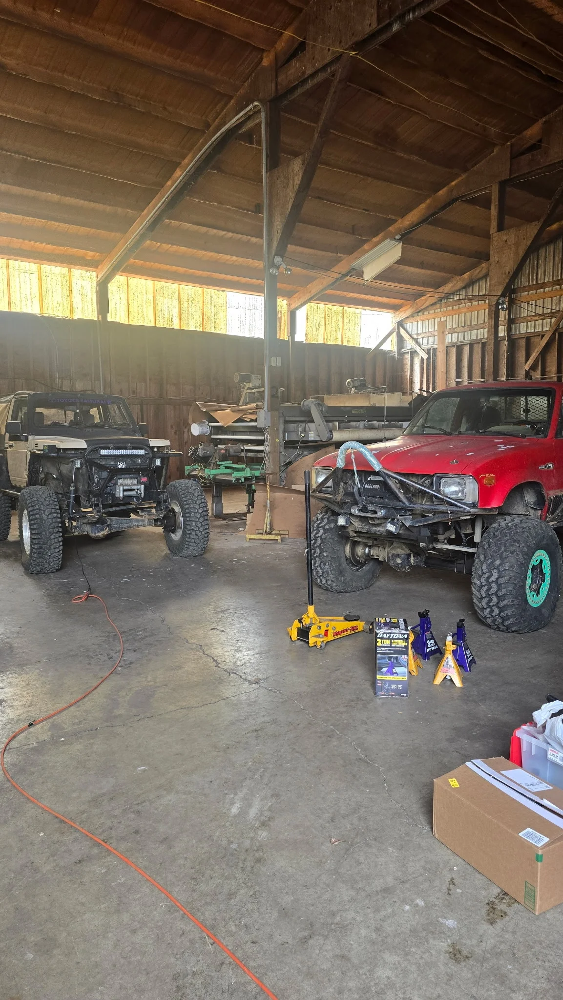

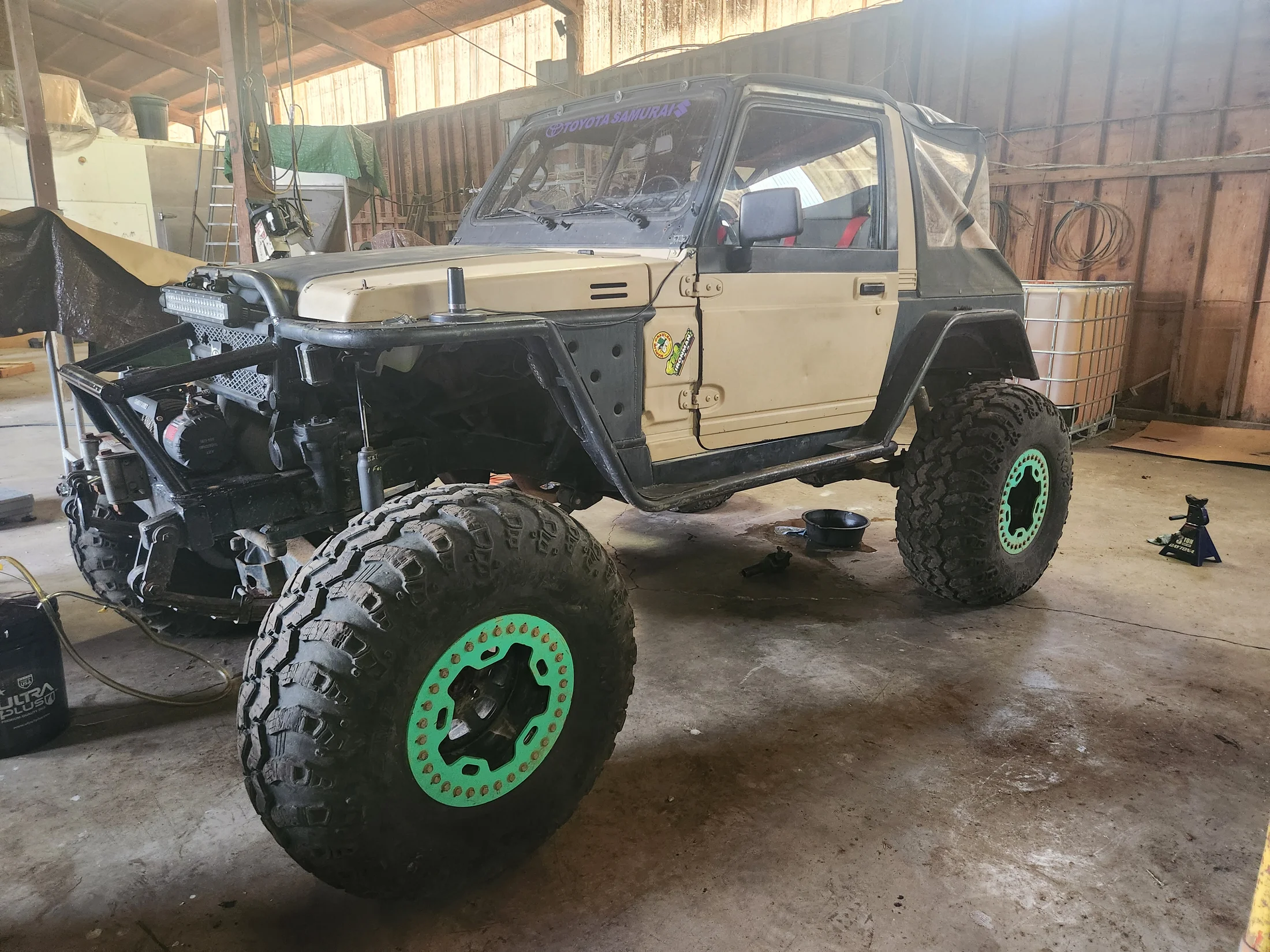

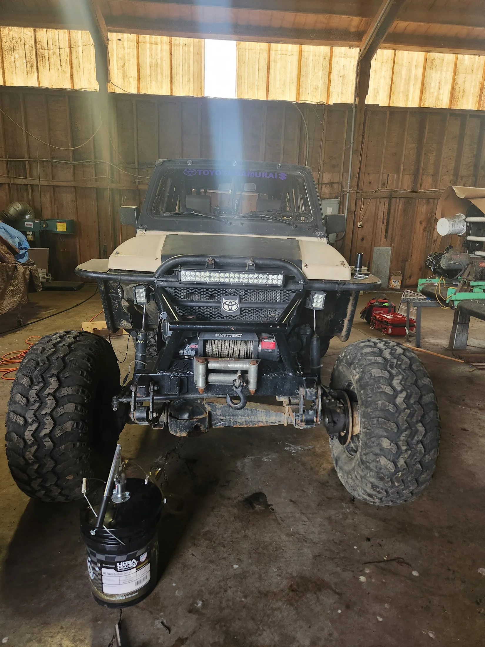

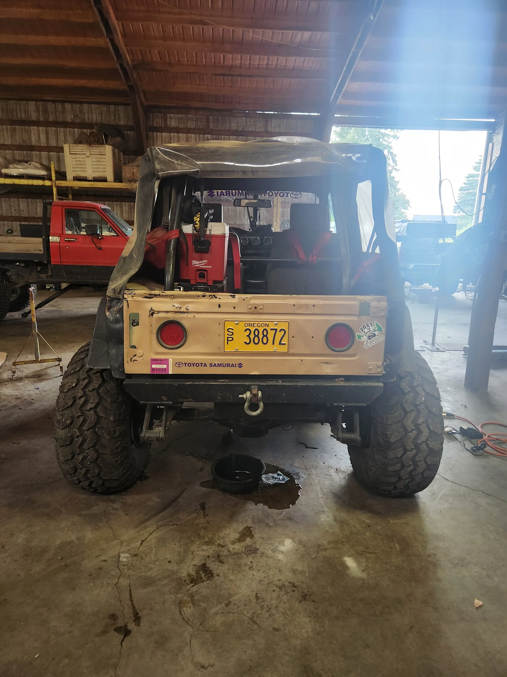

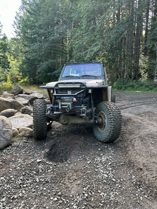

I friend of mine let me use his building to move some stuff around. A couple buddies and my daughter helped me swap out the 3rds, tires, and wheels. Now Snuggs is running 4.88 gears with a lunchbox locker in the front and a true spool (not welded) in the rear. She is also sporting 37x14.00x15 Iroks on DIY beadlocks. I gotta say, the pics don't do it justice... This thing looks so mean!
