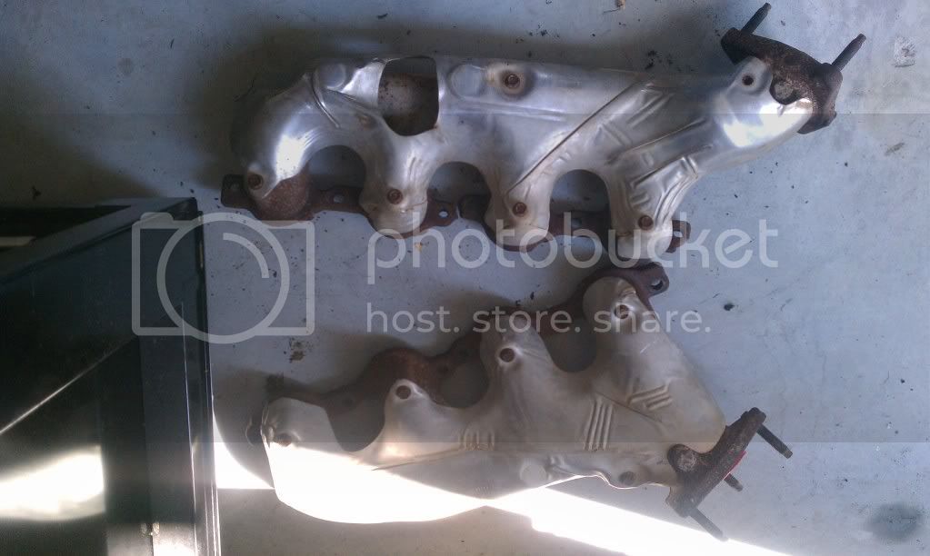

I guess without looking at it myself, how would the 5.3 truck manifolds fit? instead of having the center dump, it dumps towards the rear (away from your mounts.)
had a pair of these laying around i would have sent you for free a year ago lol

Npulver, My 5.3 is from a truck and came with those manifolds. They dump right on top of the frame. No room for the collector. Wish it was that simply, but thanks for thinking about it. I can use all the help!
I had the truck manifolds on my engine when I picked it up. No joy. They output flange comes out on top of the frame with no clearance to work with. I thought about cutting them and rewelding them but that isn't much fun and its a pain to to correctly.. I ended up with a set of Sanderson headers.
