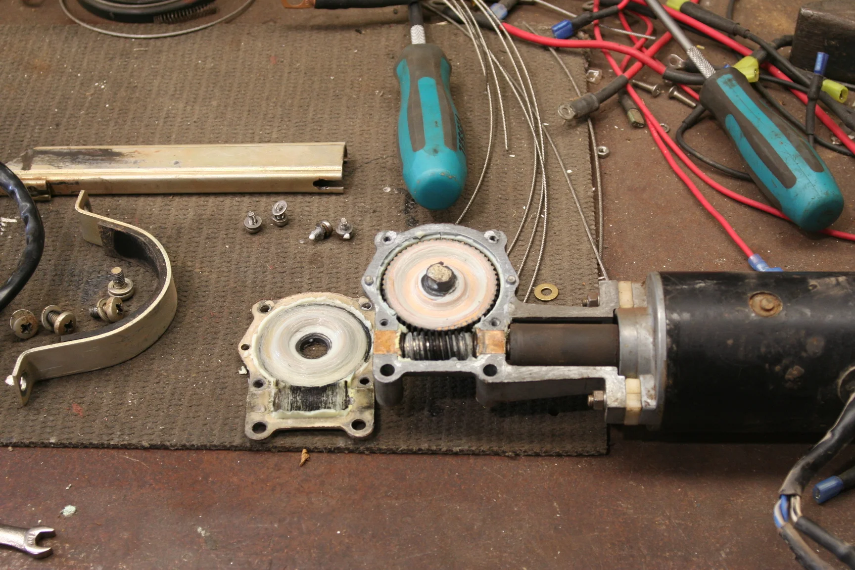

I got it apart and found one of the screws stripped on the terminal, so replacing that, too.
Mandatory picture, because it's happening. :)
Well, I took apart the motor gear box, just to give a report on the Super Lube grease I used and found something interesting. The Super Lube was great, no caking, drying out, etc. So I cleaned everything up to put in fresh grease since it's been something like 10 years, not sure, but the pinion gear ( steel ) has very badly worn teeth on it and the brass ring gear has very little, but some marks on it. The pinion gear is so bad, I'm replacing the whole thing with my OEM gear set, still in the Toyota bag, yeah, I know I'm cool. :cool:
One other thing, one of the white plastic spacers in the first picture is cracked, replacing that, also. I can't get a better close up of that pinion gear, but it's bad. What do you think, the brass ring gear caused that or something else?
Pinion gear or worm gear?
If you’re talking about the worm-drive gear that engages the brass/bronze gear and not the gear that engages the teeth of the lift arms, then my guess is that Super Lube is no bueno for that application. IMO there shouldn’t be any wear on a steel gear that engages brass or bronze.
Agree with Rush on this one. That lube ain't lubing and the friction is filing the worm gear down. If you had the plastic gear in there the worm gear would be fine and that lube may have been enough due to the difference in coefficient of friction between the plastic and bronze. Use a different lube or put the plastic gear in.
I like the worm drive lube like the SKILSAW brand or any of the readily available brands for their saws.
More reading on the worm drive lube requirements.
FYI; I don't know anything about the lube @scrapdaddy uses and it could very well exceed the ratings of the lube I used in mine so don't go changing yours based on my opinion do your own research.
Must be mo dan 3 limit
Bob was right, I had my head up the Bud bottle. The pinion gear is worn out, not the worm gear, so the brass gear wasn't doing the damage. I didn't take take a close look at the lift arms, yet. I did see some rubbing on the arms and the two supports of the tailgate body. That whole thing is cadmium plated and you can see where it's rubbed off. Let me do some more looking. Good feed back guys! 👍

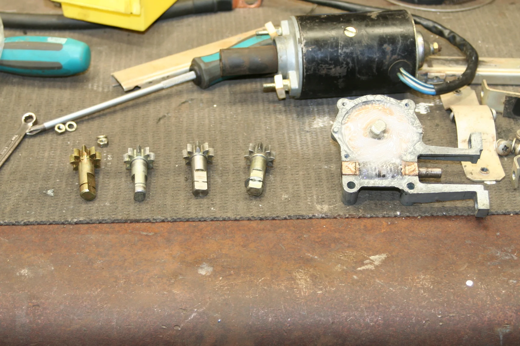

I've got 5 other used pinion gears and that new set in the bag. I don't know why so many, but I do. Only one other had significant wear on the teeth. I looked at the teeth on the lift arms, some wear, but not bad. I'm replacing with a better unit, as I think those arms are bent.

Yes they were sold as a set and you may be right as to why. I'm thinking on staying with the brass gear since it wasn't the cause of wear. Good to have some spares. :)

The new pinion gear on left.
