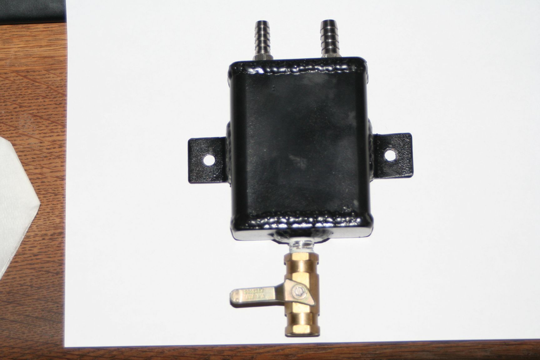

Well, after all that work on an extra vent in the rear axle, I still have oil coming up the ARB line. After talking with both reps from ARB and Diamond axle and not getting any answers other than "nature of the beast" I'm going to let it pump oil out. Hooked up a drain hose to the solenoid and ran it outside the body into a catch can. The can has a drain on it, so I'll do that for awhile until it gets old and I replace the ARB with an E-locker. At least I had fun making the catch can...
Wow, that is disappointing!
