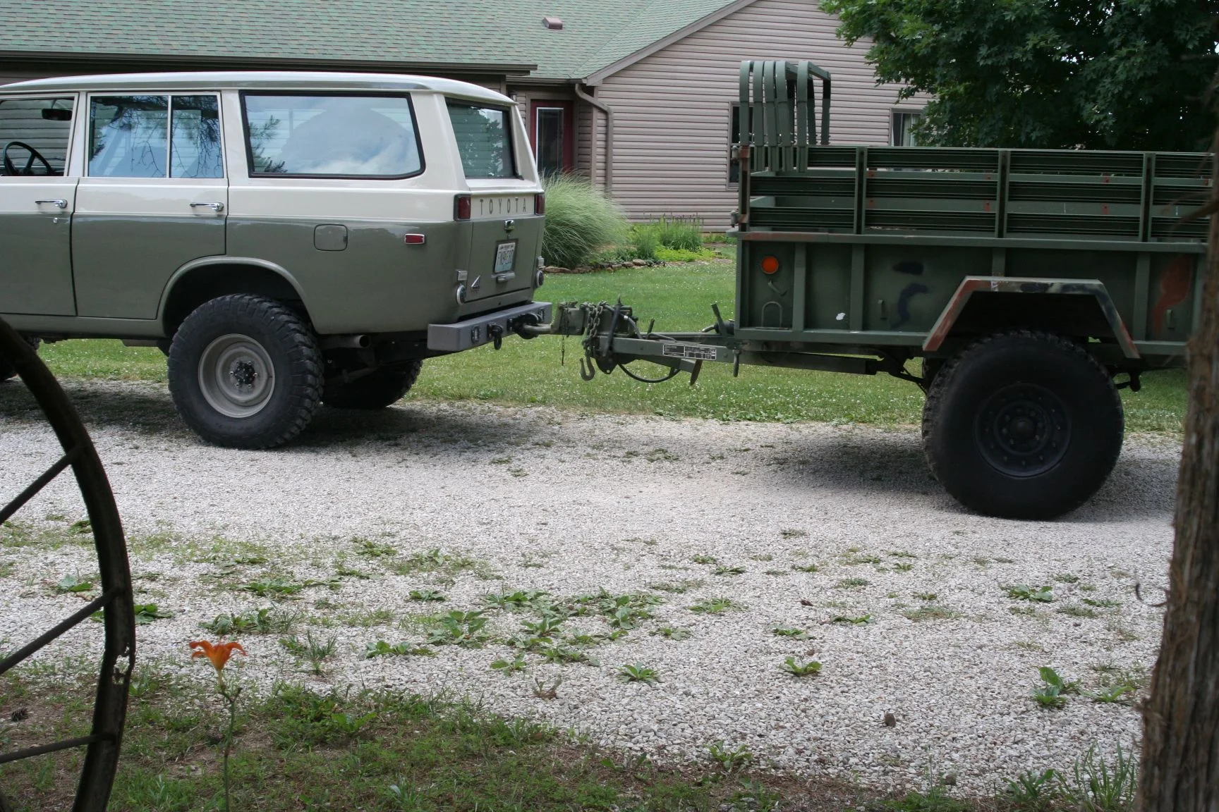

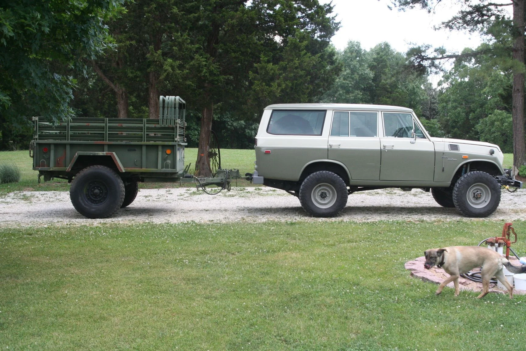

Drove it out of the shop today, runs fine, but have a steering wheel issue, I think is fixable. I didn't get it on a highway to let it run yet, but it feels good. I'm toying with the idea of pulling a military trailer with us. I hooked one up just to see how it would sit, not too bad empty.
That one is a M101A3, it was redesigned for the Humvee. The military finally went with a new trailer for the Humvee and it's a totally different model, M1101. The M101 started out being built for the M37 3/4 ton vehicle. I like the M101A3 because of the new axle it has. Great heavy duty trailers. If I take it, I'll have to rewire the lights for the 55.
It has the 37" Humvee run flat tires on it.

The one I'll build for a camping trailer will have the same wheels and tires as the 55 and the same width axle. The trailers really pull nice. My Son pulls one with his Xterra

I wired the lights up on the trailer and shot some camo paint on it, don't want any points removed for rust at the Shine n Show. I really can't think of anything else to do for the trip.
