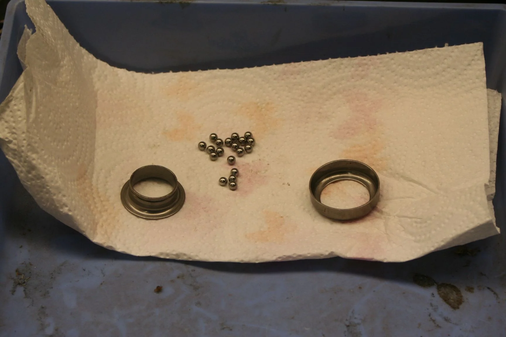

Take a trip and then take it apart, seems to be my mantra. Transfer case rebuild, rear axle puking oil out the ARB solenoid, wiper arm falling off, steering column dragging. I've got a handle on all of it, so hoping we'll be ready for the party. Not many pictures of the tear down, but here's the top bearing in the steering column. I repacked it once before, but something isn't right in there.

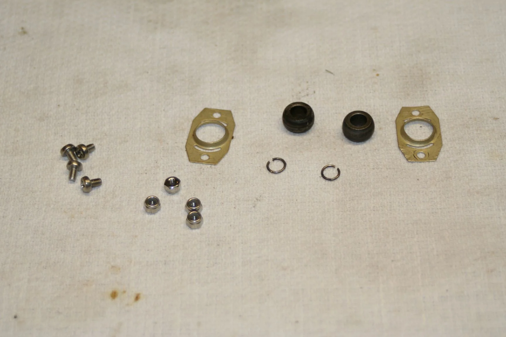

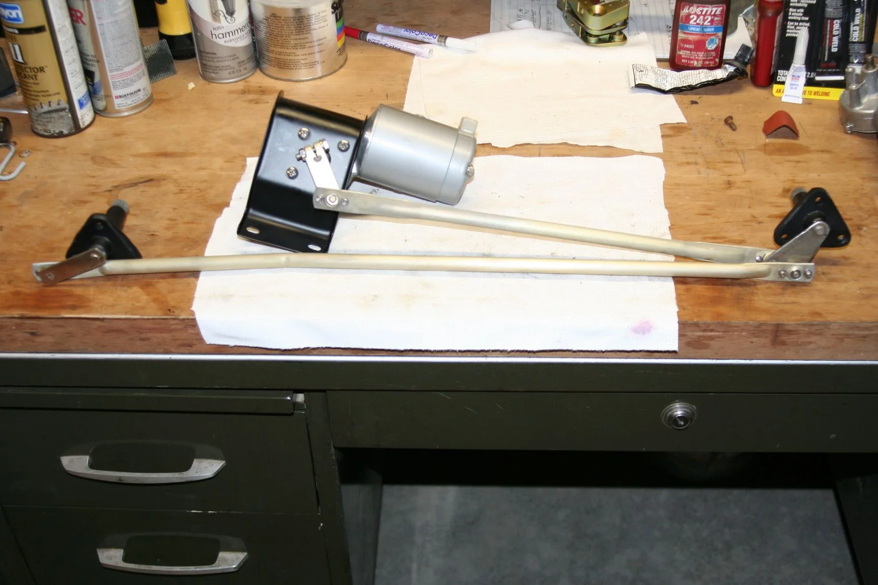

Wipers are fixed, I drilled and taped a hole in the wiper shaft and screwed the arm down. No picture, but I'm glad I replaced all the rivets with little screws when I rebuild all the wiper arms, made taking it apart a lot easier.
