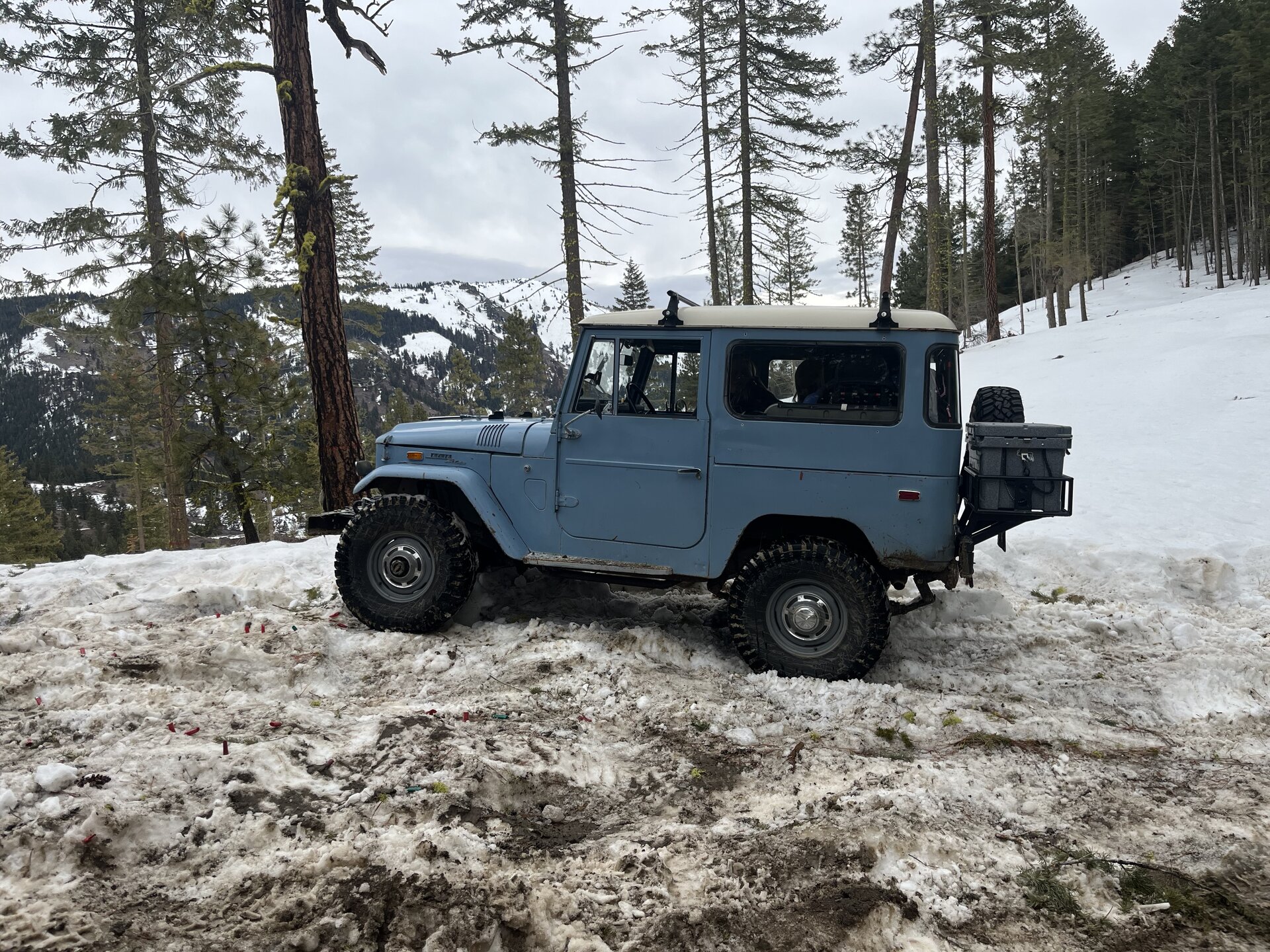

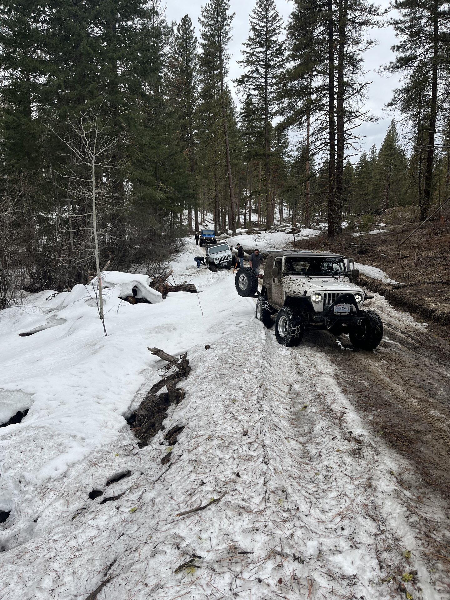

Good day in the hills. My cruiser and 5 jeep rubicons. Everyone got stuck in some fashion at least once. Everyone commented the cruiser seemed to be having the easiest time.
Does your Cruiser have lockers like the Rubicons?
Nope, stock open diffs. And half of them didn’t know how their lockers operated.
I think it was the narrower profile of the cruiser and tires and they all had wide tires with wide stances and were getting pulled into ruts and stuff. Just seemed to be able to point the cruiser and it’d go.
Good to know. Thanks. Your Cruiser looks great btw.

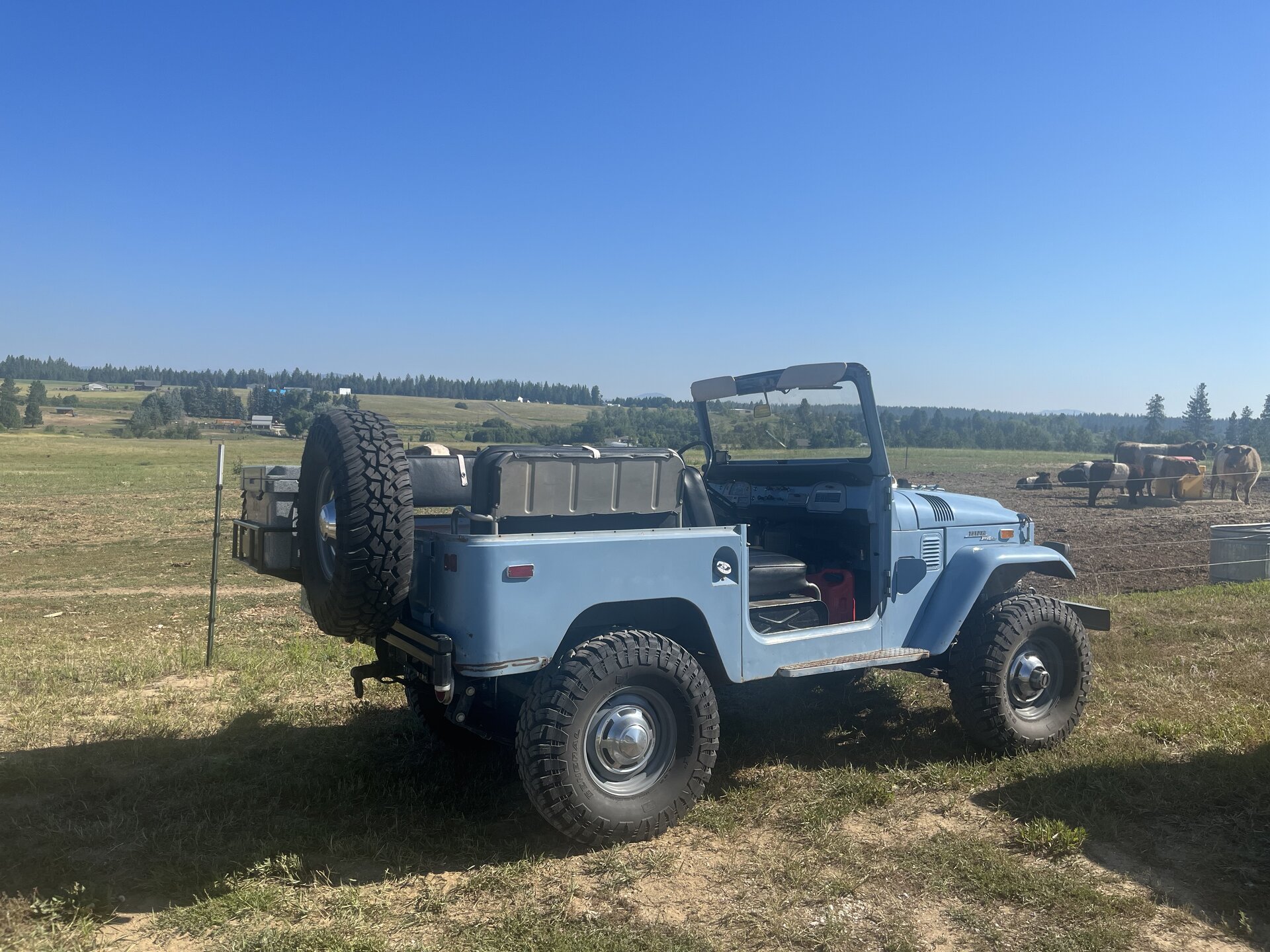

Top off and went to help a buddy on his farm for a little bit. 40 has been daily driver status until it got just too damn hot with the top on.
First time I’ve ever drove with the windshield down.

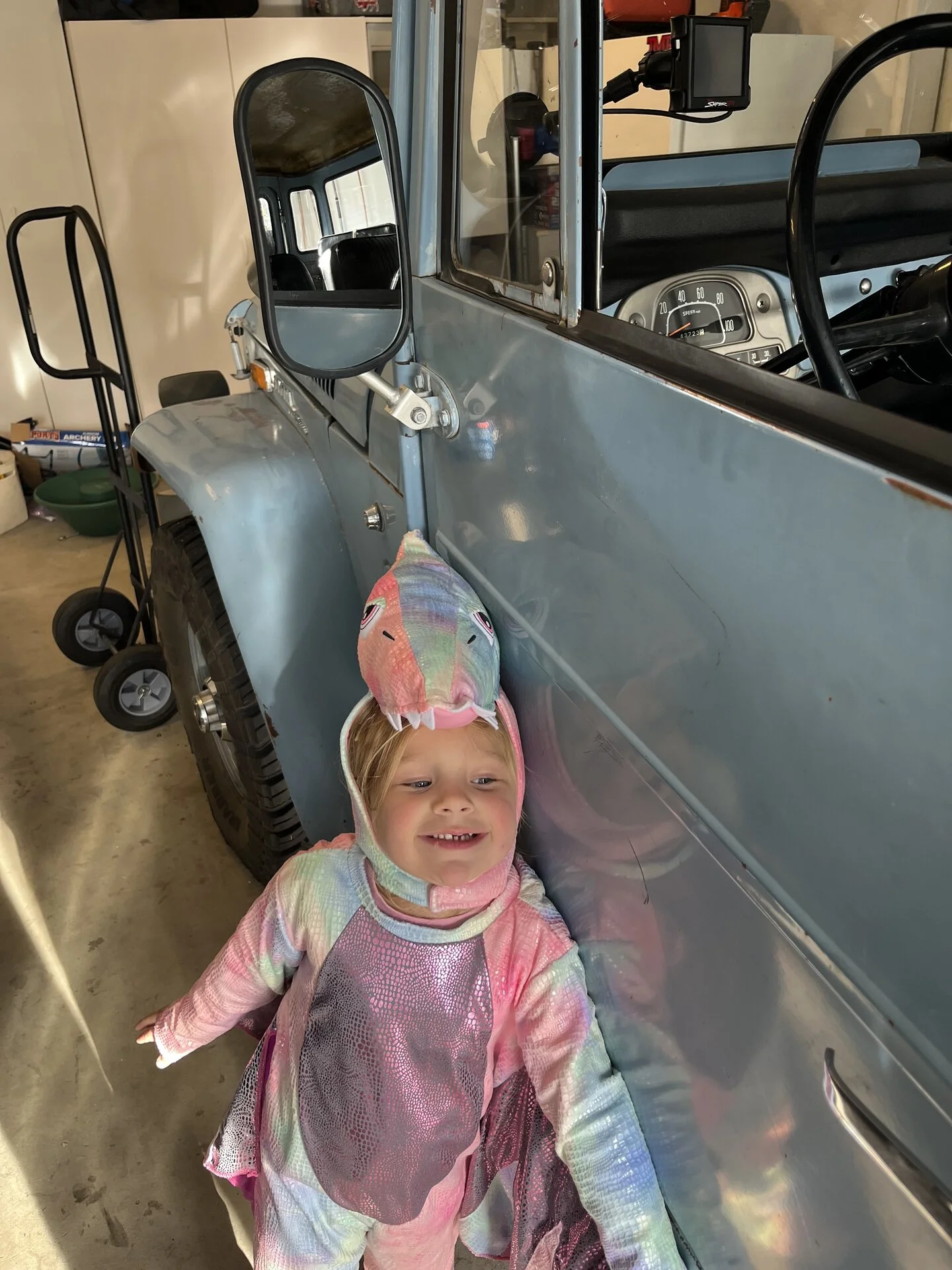

Finally swapped the convex mirrors I bought a few months ago. The old round mirrors were not stock and the threads in the mirror arms were the wrong size so I cut the ends off the arms and welded on a nut. Hit them with some rustoleum metallic satin nickel and I have much better rear vision. I had a pterodactyl helper.
