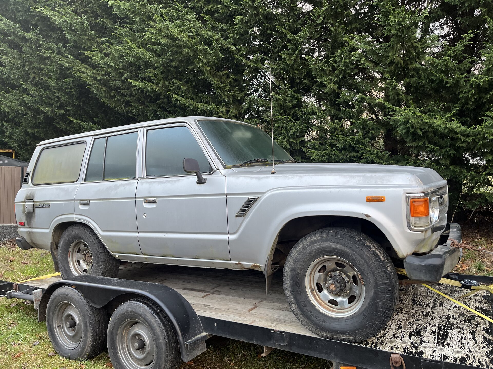

For some reason I bought an 87 60 series last night.
My next big project was going to be AC in the 40 but due to some unforeseen changing circumstances, that’s on hold.
What are those unforeseen changing circumstances?

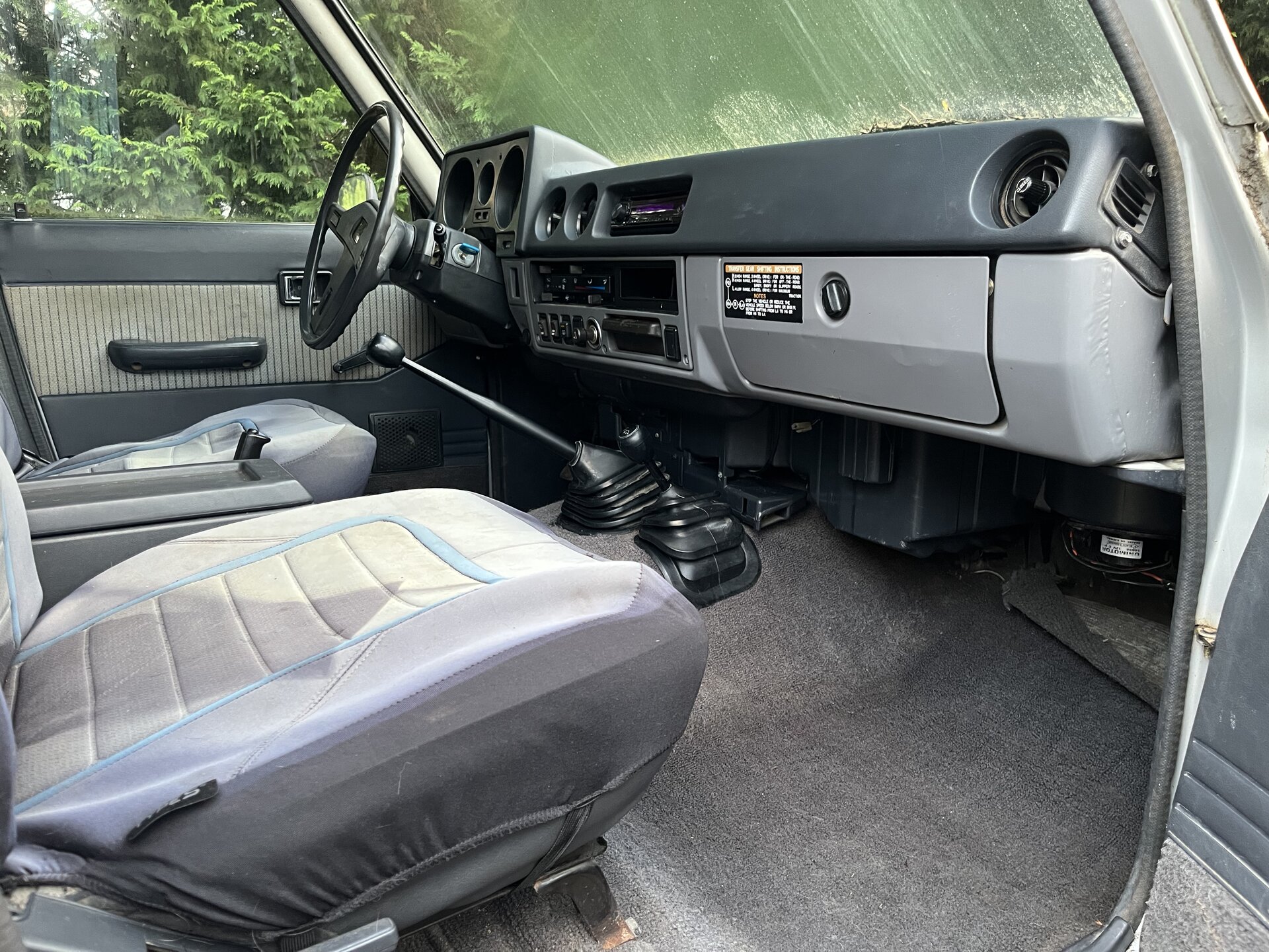

For some reason I bought an 87 60 series last night. View attachment 3245405View attachment 3245406
thats a good looking one! I have always loved the fj60s. There is one in the same color on the island.

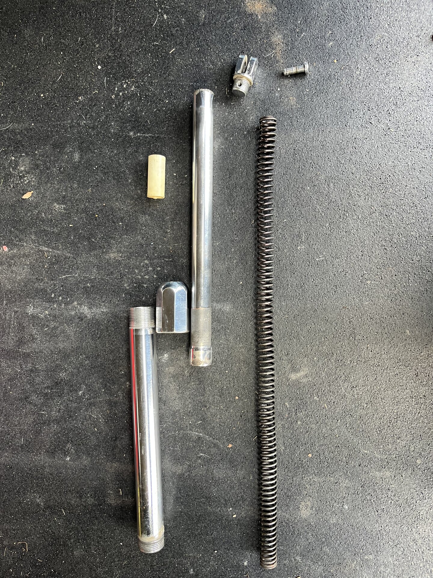

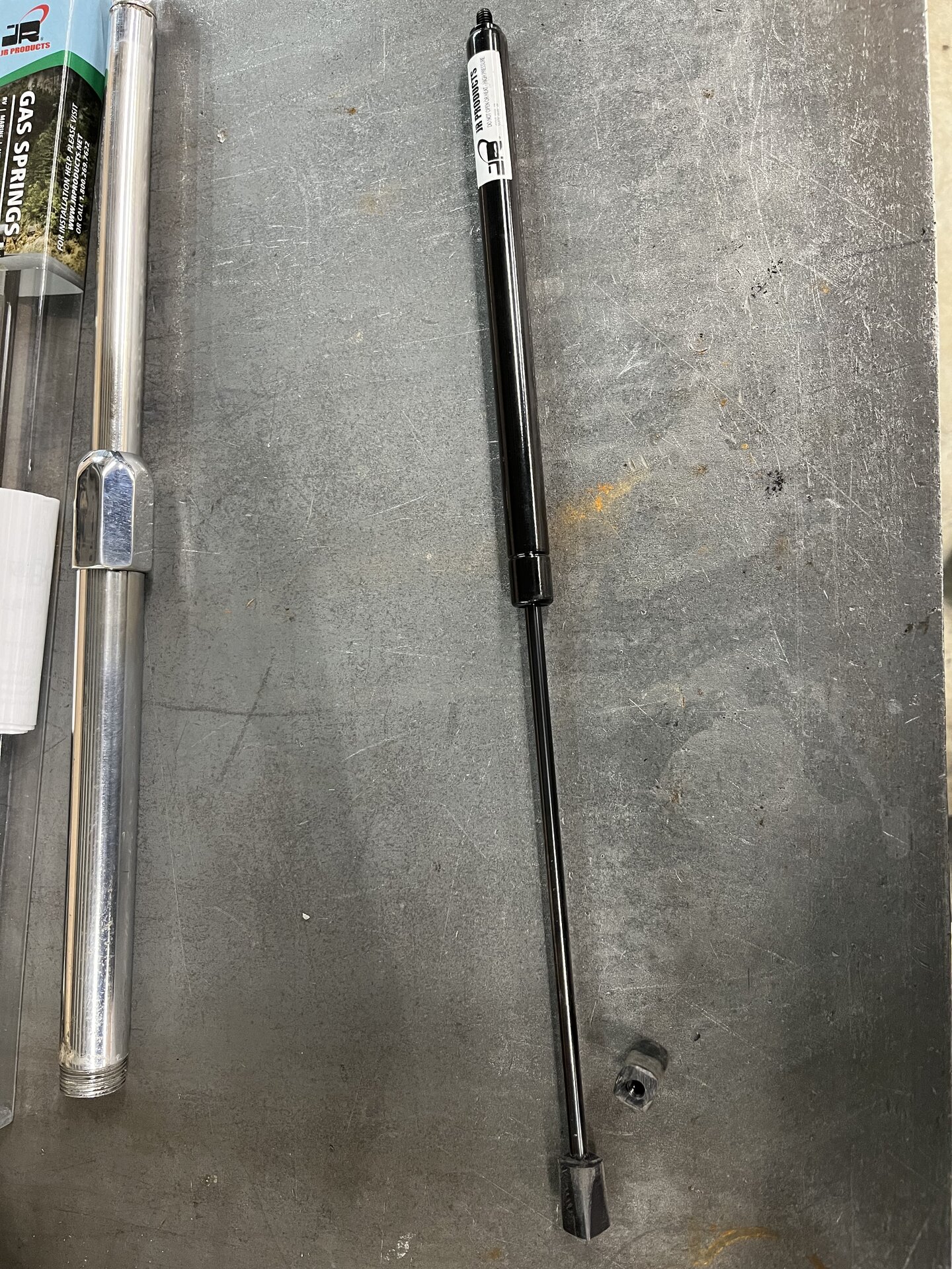

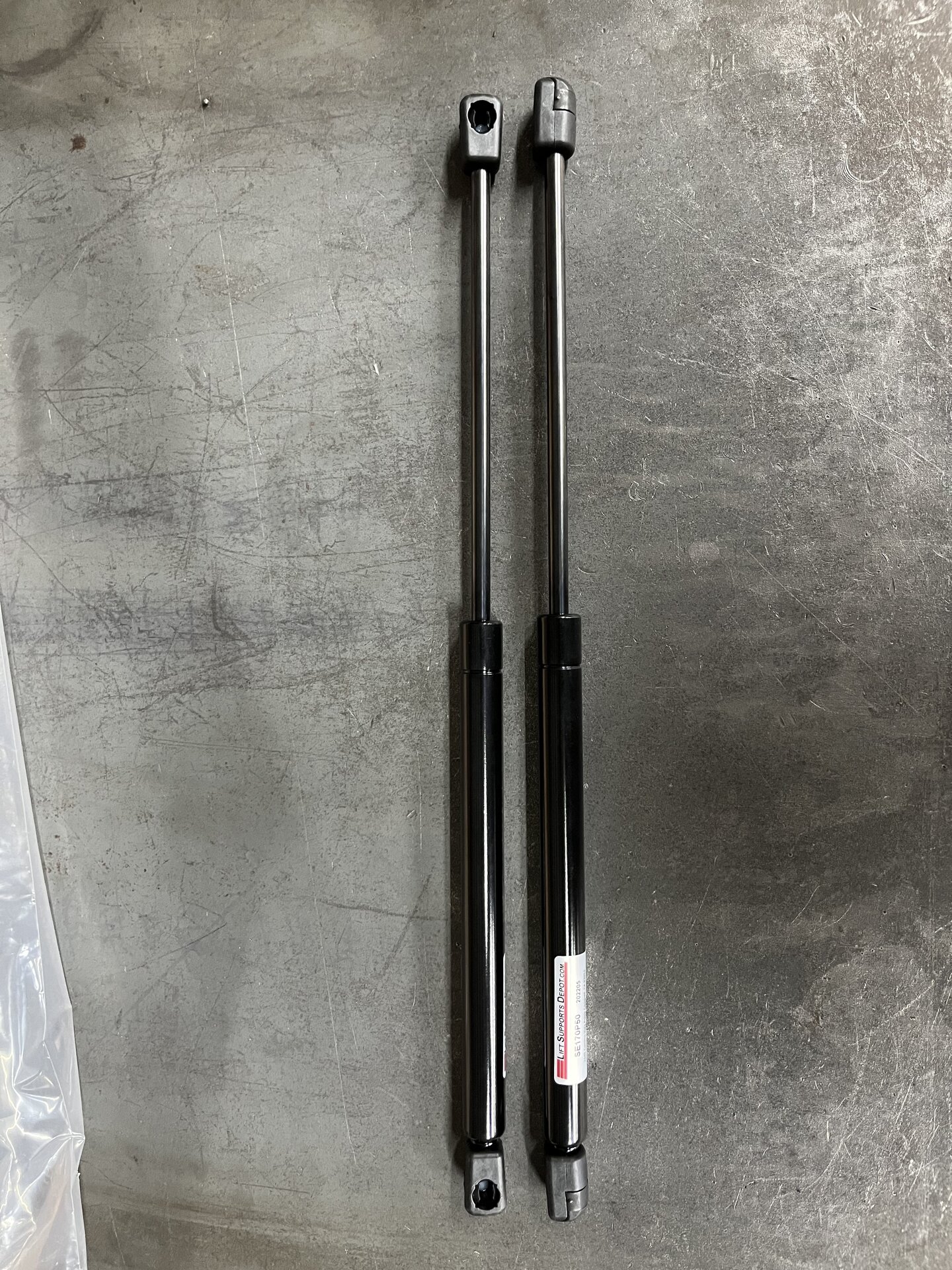

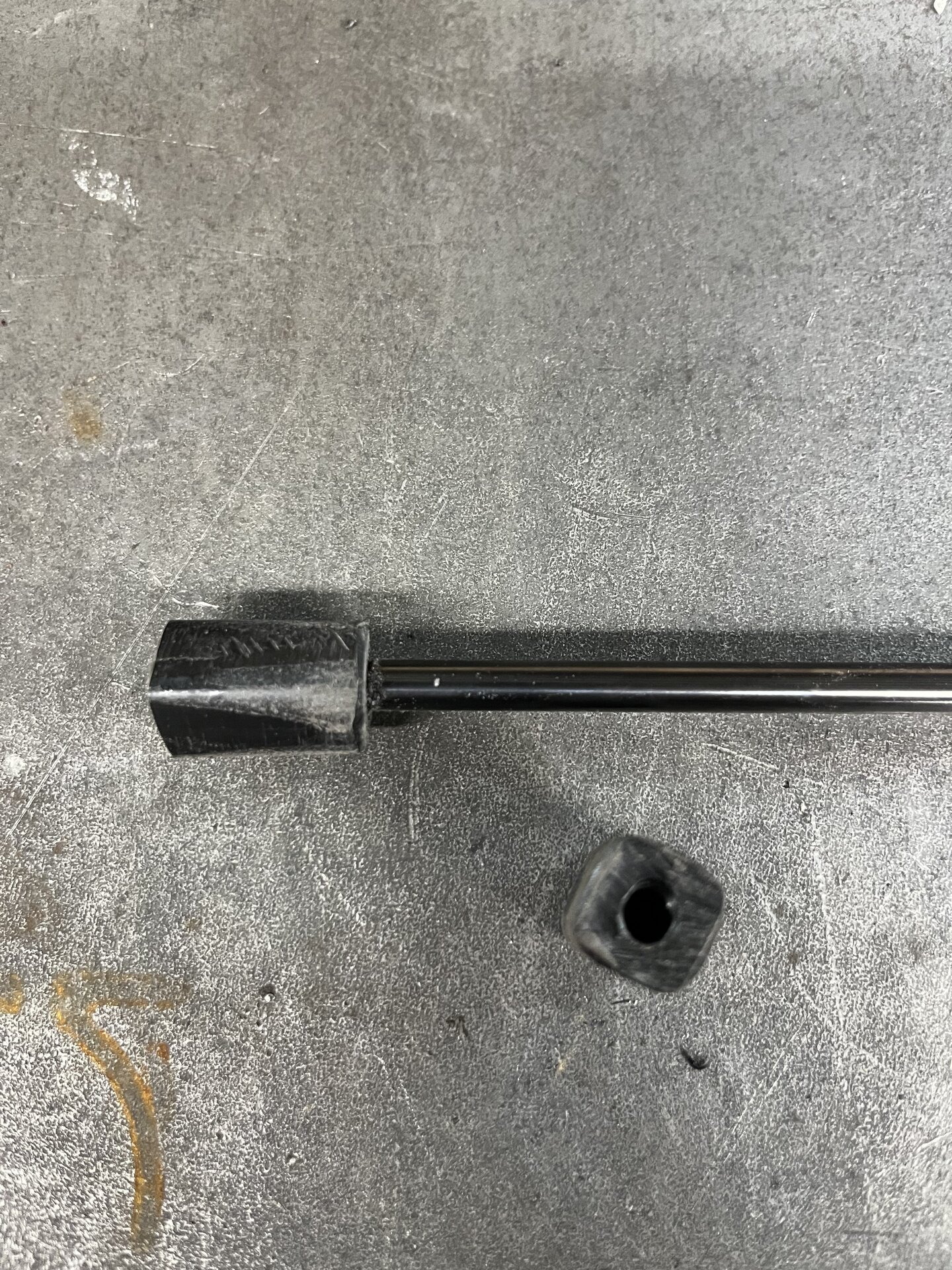

Well I guess no 40 work isn’t accurate. I ordered some gas struts to put inside the rear hatch spring/ struts. The first set I ordered is seen referenced in a few threads but the body of them was too big to fit inside the smaller tube of the stock struts (common part #5200-50). I sent them back and ordered a different set with 15mm body diameter and they fit great (JR Products GSNI-5200-50). Unscrew the socket ends and they were about 5/8” too short for full extension. I had some Delrin square stock so I cut and tapped it to fit and that was the ticket! A coupling nut would’ve worked just as well.
Seems to pop open well and hold itself up just fine. These are 50# struts; I’d even go higher to 60# if available.
First set I ordered. Tube body was too big. Not sure if later models have a larger tube diameter as many people said they worked fine.
Factory struts disassembled (thinner, upper tube is the problem one).
Second set with delrin spacer. I rounded the spacer a little to fit in the upper tube.
The spring and the white-ish plastic spacer don’t get reused. I’ll toss them in the box of take off factory parts from this cruiser, just in case.
It will be nice not having the rear lift hatch slam down on your head anymore. :) What are your plans for the 60 series? That is a very clean interior.
I’m not sure yet on the 60. I’ve wanted one for a long time. I have an 04 4Runner and if I keep the 60 when done, I’ll sell the 4Runner. Anymore with my 40 running how it is, I only drive the 4Runner when it’s raining pretty good or long trips to go hunting. A 60 series with a Sniper, small lift, maybe air lockers….. that could take the 4Runner’s place…..
At a minimum I’m going to get it running and driving reliably and safely, clean interior and recover the seats, then drive it awhile to see what speaks to me.

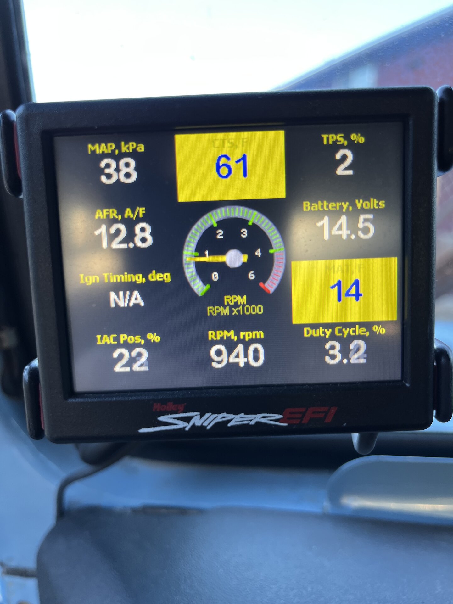

Cold this morning.
Cold this morning.
Air temps were -11F here yesterday morning, wind chill -30F.

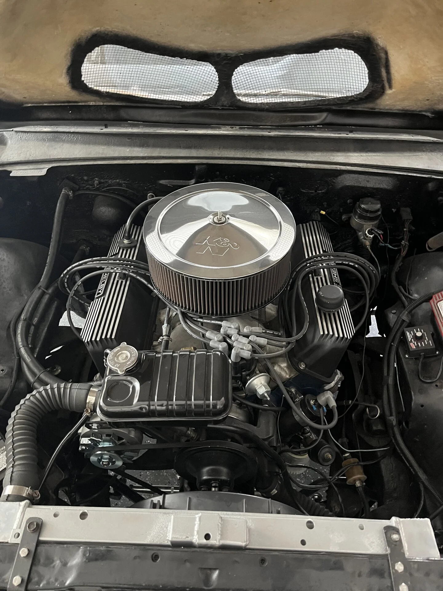

Cruiser was in my attached garage and the Sniper CTS was 19 degrees.
I test fired just to see if it would start, and it worked. I was amazed.
Of course Idle was low (~600), IAC was pegged, and you had to baby the throttle or it would stall.
These Snipers are amazing, I can't imagine that my carb would have started so quickly/easily in those temps.
