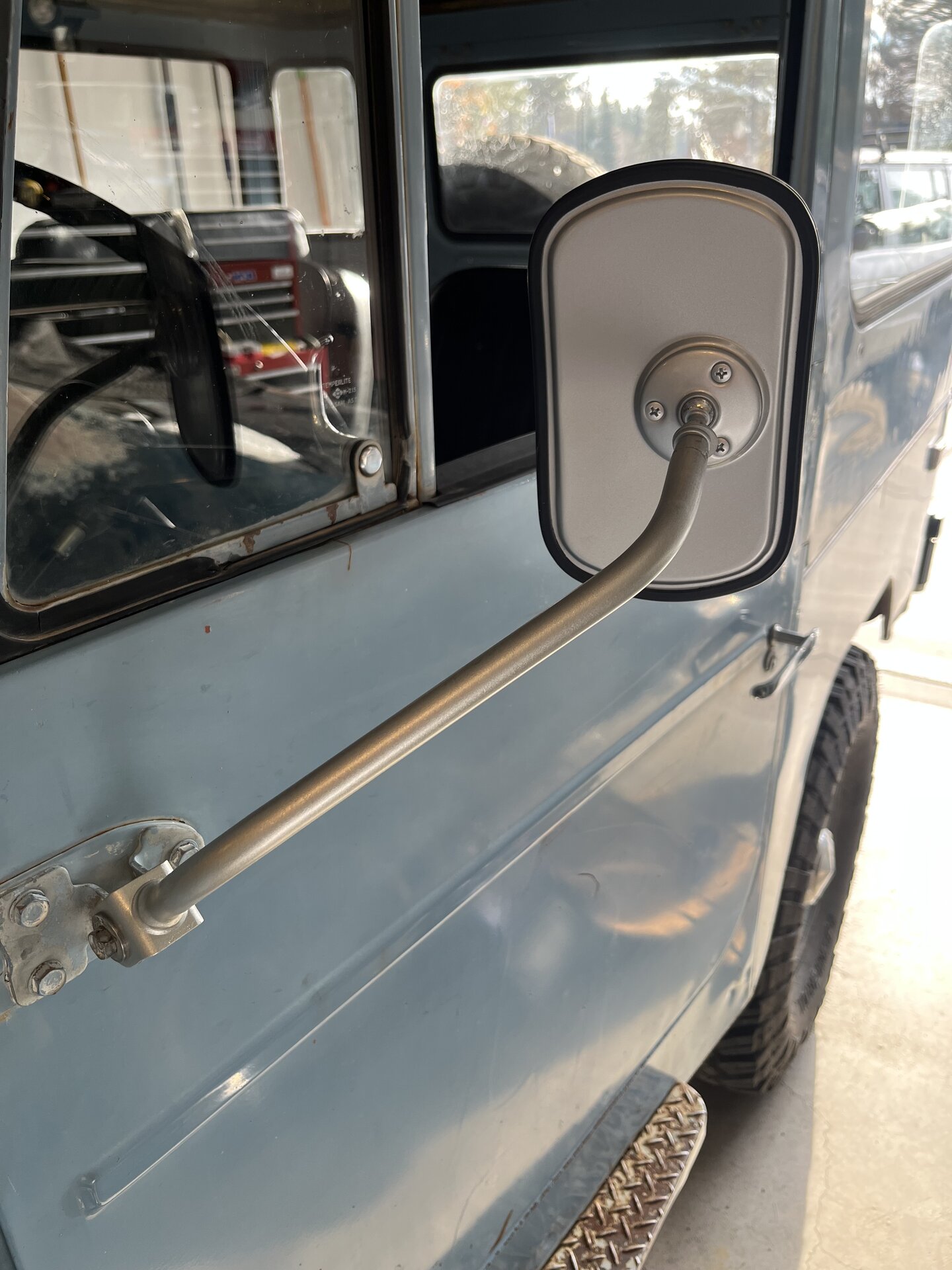

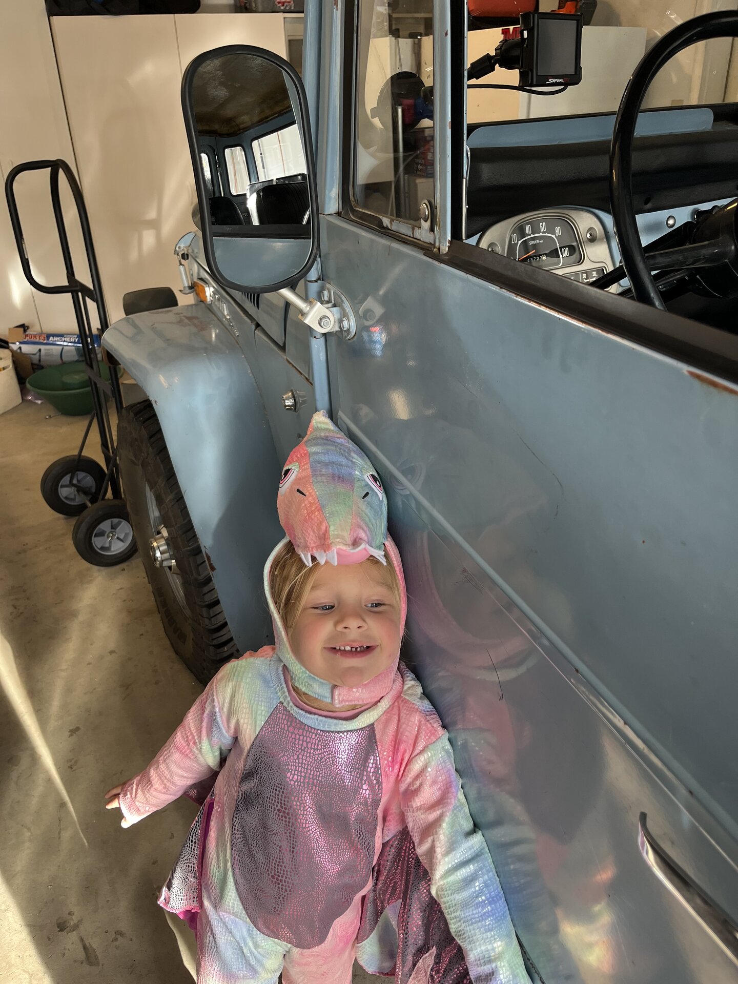

Finally swapped the convex mirrors I bought a few months ago. The old round mirrors were not stock and the threads in the mirror arms were the wrong size so I cut the ends off the arms and welded on a nut. Hit them with some rustoleum metallic satin nickel and I have much better rear vision. I had a pterodactyl helper.
View attachment 3469857View attachment 3469858
Where do I get those mirror arms and heads?
Oh, and the pterodactyl compliments the rig!

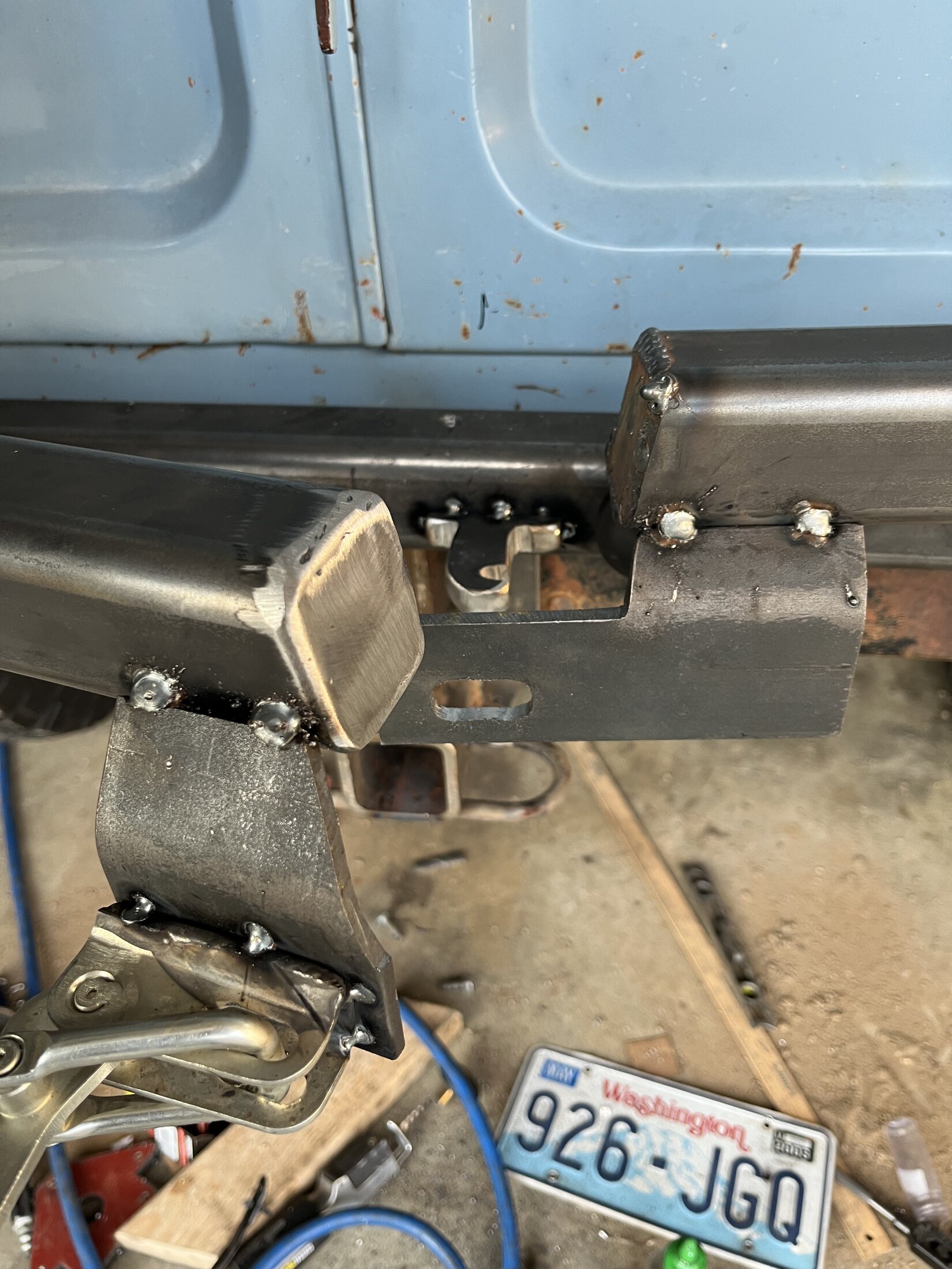

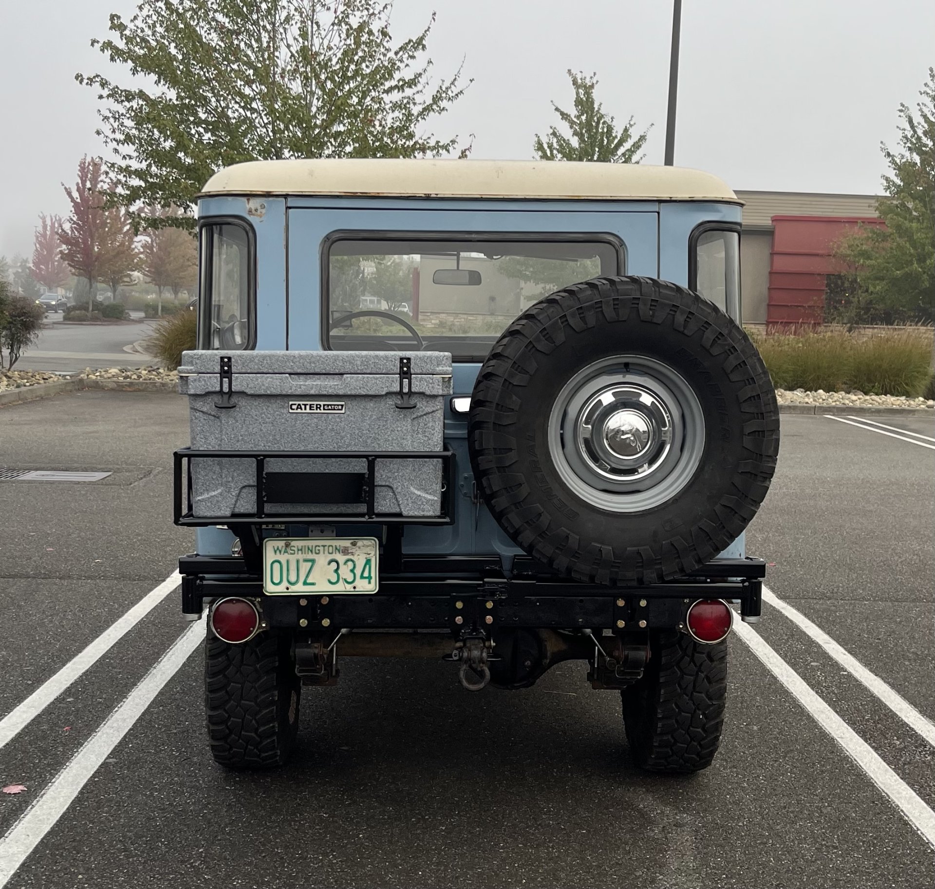

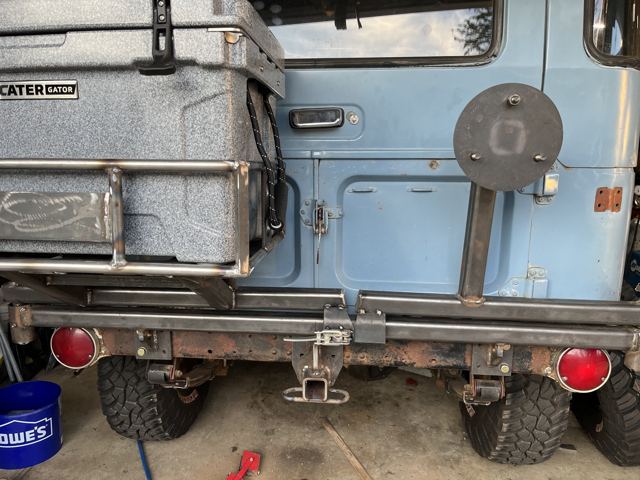

Over the last couple of weeks as I had time I’ve been making a tire and cooler carrier. Finished it up last night. View attachment 3133462

So since I’ve seen this rig I always thought it had a 4 plus carrier. When I went back through the other day looking for brake info I found where you built this.
Well done!
What latch did you use? Seems like you or @Firemedic831 used a latch that looked very easy to use and wouldn’t rattle.
Thanks.
@clrussell My latch is a stock latch for the rear doors I got new from Toyota, then modified it. Mad the hook end and used some rubber bumpstops to keep it from rattling too much.
Well done!
Thanks.
You can kind of see it all here.
I like that. Thank you for detailed pictures. I might steal This.
New oem latch from Toyota?
Yep, new oem from Toyota. It’s got the angle on it to fit the split rear lower doors. I just cut the angle off. It is stiff to open the latch but it doesn’t rattle so that’s a plus.
My latch I got from Iron Pig Off Road

@Skreddy what size is your cooler? Im planning out my rear carrier build and looking at sizes.
I actually was looking at that same company cooler You have and didn’t realize it until I came here to ask about size. How happy are you with the cooler? It’s fair priced. I don’t need ice for 2 weeks, I just want me beer cold over the weekend.
I’ve got 2 of the 45 qt (one for each cruiser) and a 110 for travel trailer camping. They keep ice every bit as long as my friends yeti coolers do. I’ve been really happy with them and have had our big one 4 years now I think.
I got a net for the inside of the lids and a basket that sits in the top groove from Amazon too. Can’t remember the sizes but they are pretty handy to keep stuff in that you don’t want wet or crushed by ice. I also cut down a plastic cutting board that fits the middle divider to keep things separate/hold beer cans upright.
CaterGator is the brand for anyone else that’s curious.
Thank you! I added it to cart.
I originally found them with the sea foam color. But not sure I can commit to that color, I’m a neutral gray color most of the time.
