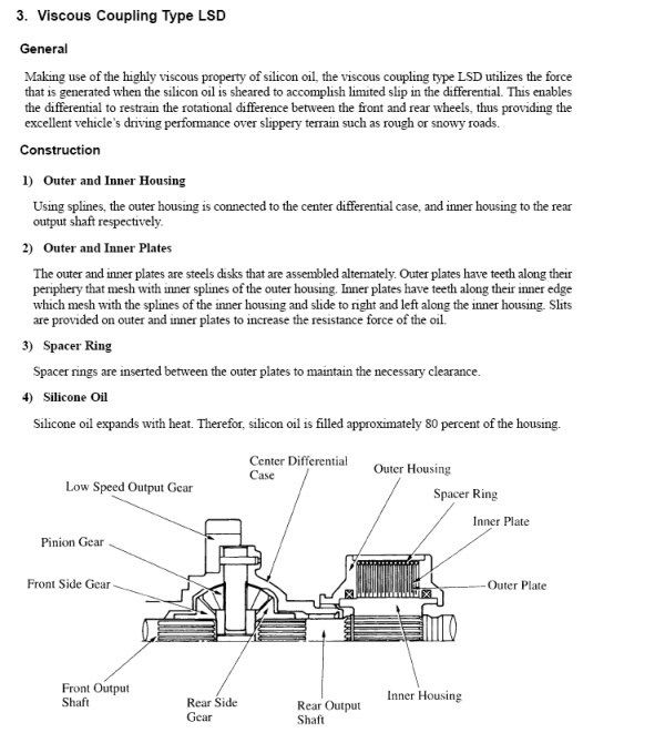

Should I replace my Viscous Coupler as PM?
If anyone has a functioning VC that they took out and it is laying around taking up bench space in the garage and you want to get rid of it, I will pay postage. I would like to get inside and see what is going on and I would like to see if draining the silicon fluid and replacing it with something heavier to give more "limited slip" is possible.
