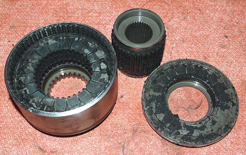

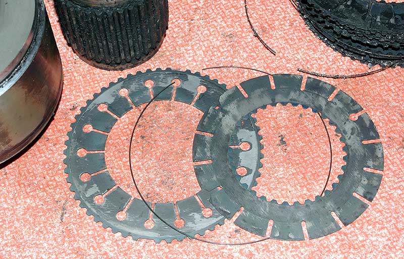

We actually replaced one, all others have just removed and cut the failed one open. Used the lathe to cut through the weld, when released, the end cap went flying and caught the owner in the jewels, the rest of us were amused, the owner, not so much! :hillbilly: So, use care, at least that one had pretty good pressure in it.
I don't see how it could be repaired? If it were drilled, there are so many plates in it, packed full, don't see the fluid draining out?
Tools, do you think that was after the fluid was all cooked though? That is kind of what I am thinking is that the black junk is basically burnt fluid that ends up causing it to lock up. If you opened a working unit, would it still be fluid?
If you speak german here is a rebuild of the VC from a Syncrovan. But the design looks quite similar except for they have snap rings holding theirs together, but it does make me think that the black s*** inside is indeed burnt fluid.
